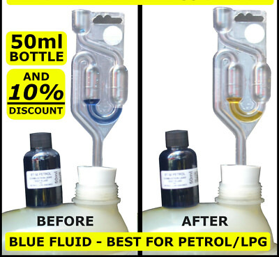

Coolant thermostats are made to fail open, so when they do go wrong, the engine cannot overheat.
An engine that is getting too hot has nothing to do with the thermostat and everything to do with a coolant leak and blown head gasket. Let it go too far and you will destroy the inlet manifold and who knows what else.
A simple £10 chemical test of the coolant will tell you if the head gasket has failed.
