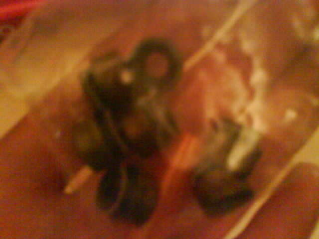

sei-abarth New member Parked in the garage Joined Nov 17, 2006 Messages 52 Points 24 Location warwick Mar 26, 2008 #1 got my new headgasket set today but wot are these little round things are they locating dowls(sorry about pics) Attachments help7.JPG 39.2 KB · Views: 15 DShelpC00095.JPG 30.2 KB · Views: 14
custard Status: DEFCON Grumpy Written 10+ guides Uploaded 5 resources/downloads Joined Nov 4, 2003 Messages 48,591 Points 11,023 Location Edinburgh Mar 26, 2008 #2 valve stem seals methinks
OP OP sei-abarth New member Parked in the garage Joined Nov 17, 2006 Messages 52 Points 24 Location warwick Mar 26, 2008 #3 arr rite i hav knw idea wot they are lol i been searchin the haynes an the porters book,cheers.
rallycinq Autotest Special Parked in the garage Joined Mar 19, 2002 Messages 24,592 Points 4,003 Location Lake District....Moist Mar 26, 2008 #4 Yup, valve stem oil seals. Remember to change them. Cheers D
balidey I hold up buses Parked in the garage Joined Jan 9, 2006 Messages 1,107 Points 179 Location Spalding, S. Lincs Mar 26, 2008 #5 Getting the old ones out was a pig and IIRC I used an 11mm socket to push the new ones on
R randomizered ' Parked in the garage Written a guide Joined Feb 16, 2005 Messages 5,983 Points 988 Mar 26, 2008 #6 I just used my thumbs to refit, i had 16 to do, and after, i had blood in my gloves fingers that had been forced though the skin lol, hurt a lot for a few days...so maybe to socket idea is a good one Kristian
