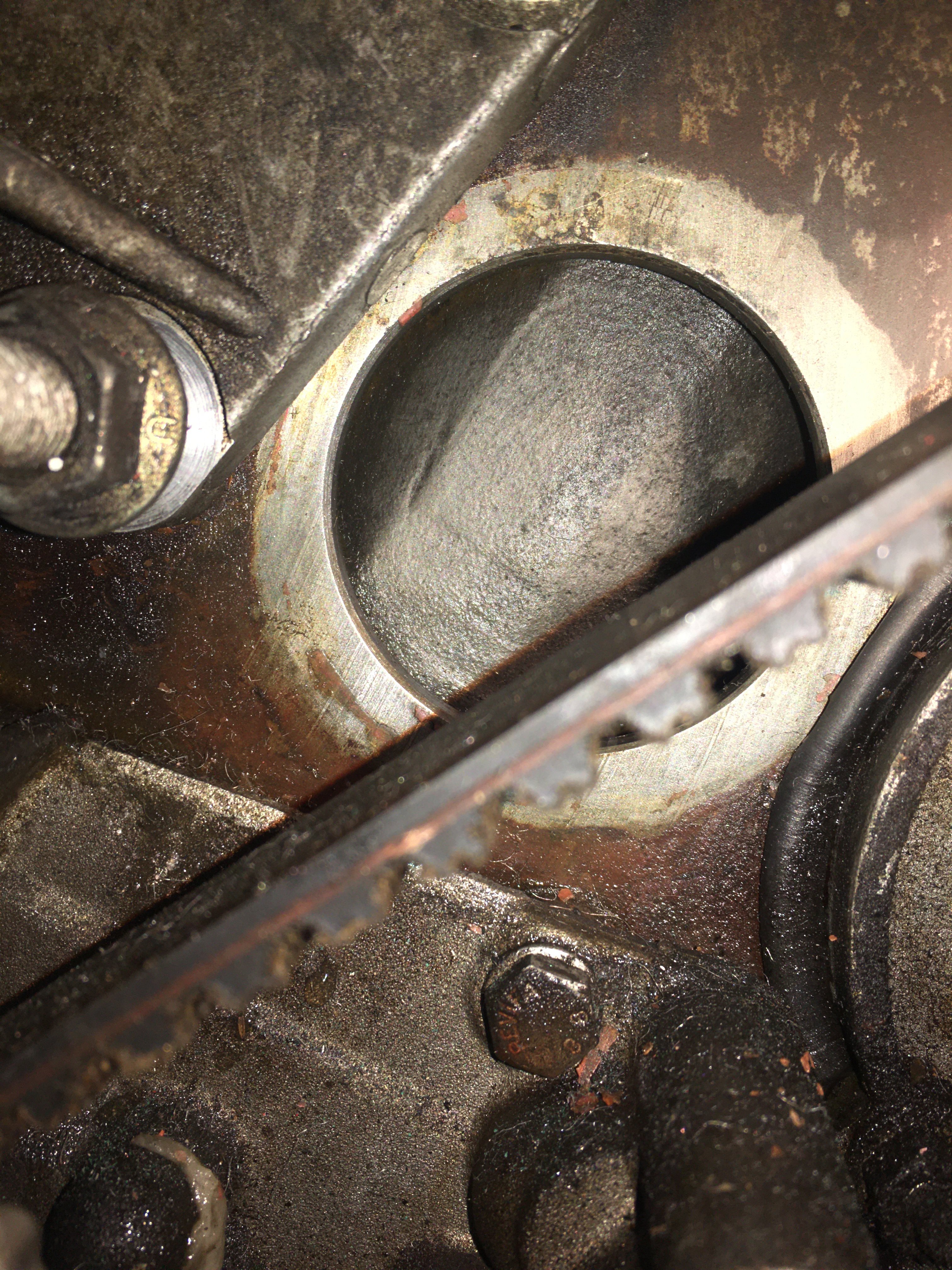

Funny thing is I just had a core plug go on a Fiat 1.2
The other side (alternator)
The plug not corroded but the metal has split
Just about doable with just the engine mount and covers removed
