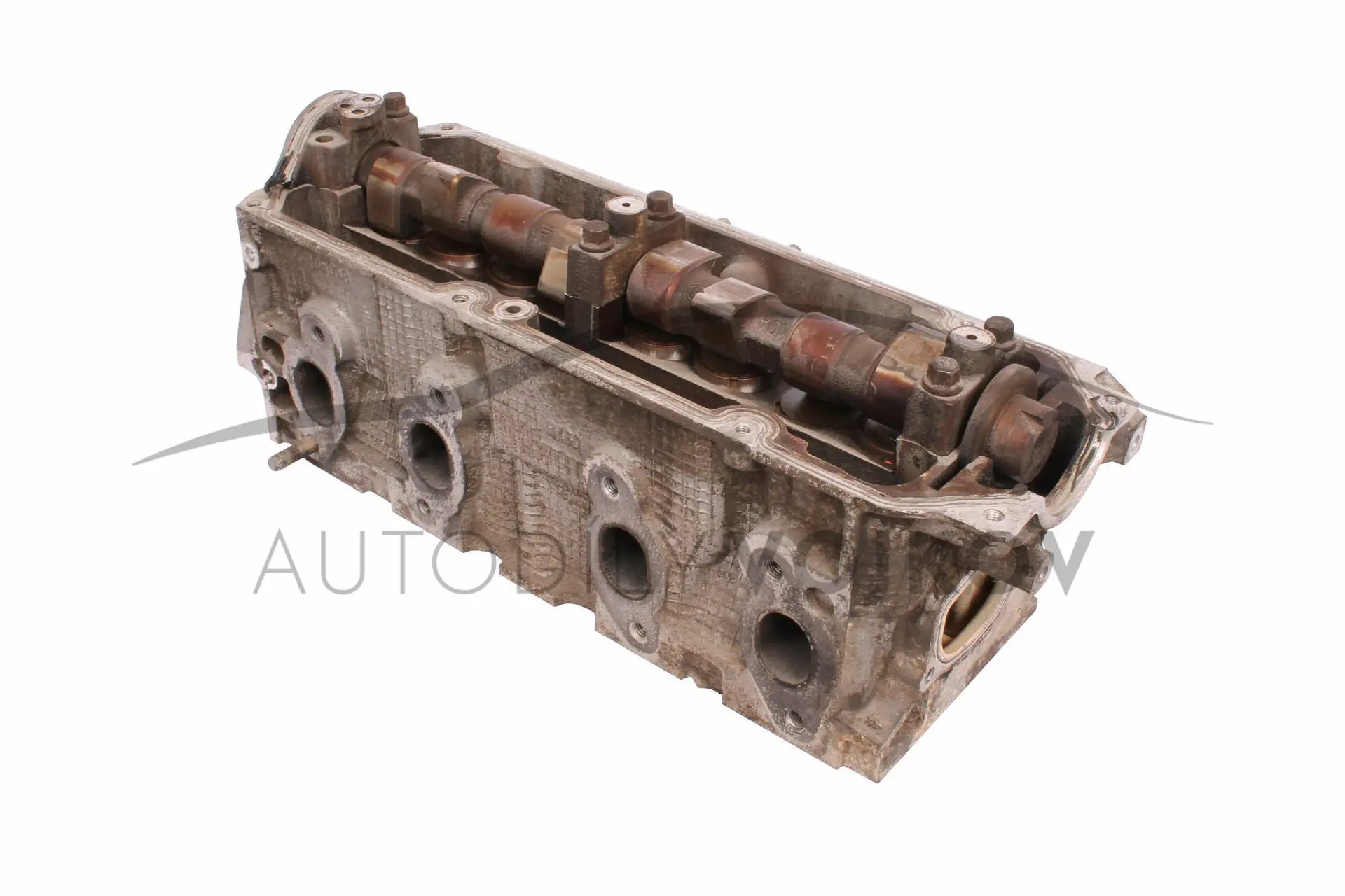

Hello Palios, I have a question about my engine 1.2 petrol, I have a valve opened and dont know it should be that, saw to many videous but not found any, why 2 valve are opend and the rest are closed ?
The car its with A/C, after change the headgasket started to knocking, only on idling with no acceleration, no power losing, everything checked no damage, clean

In some cases I think its The Valve Axe have luft, cause the sound its coming from the Thunder Units

Update on the problem, yeah happend a lot throu this time and runned to much for, engine got stoped, its need rebuild,Need to change some parts and will run again, im in waiting for new spark plugs, cause those who were changed was fake, new injectors which also was badly not quality, got scammed on the postal reciving the new, few times bough the parts and yeah, problems problems in fuel burn, catalytic converter, and much time to waiting, and now got fuel prices problems in country, so its on pause
The Last Update and the fix, I changed Oil Seal of the headshaft and verified the valve clearence, as is said, in good condition, gave torque, and clean the microtunnels, just blow air in the and unclocked the tunnes and the tubes which suply oil to head shaft
