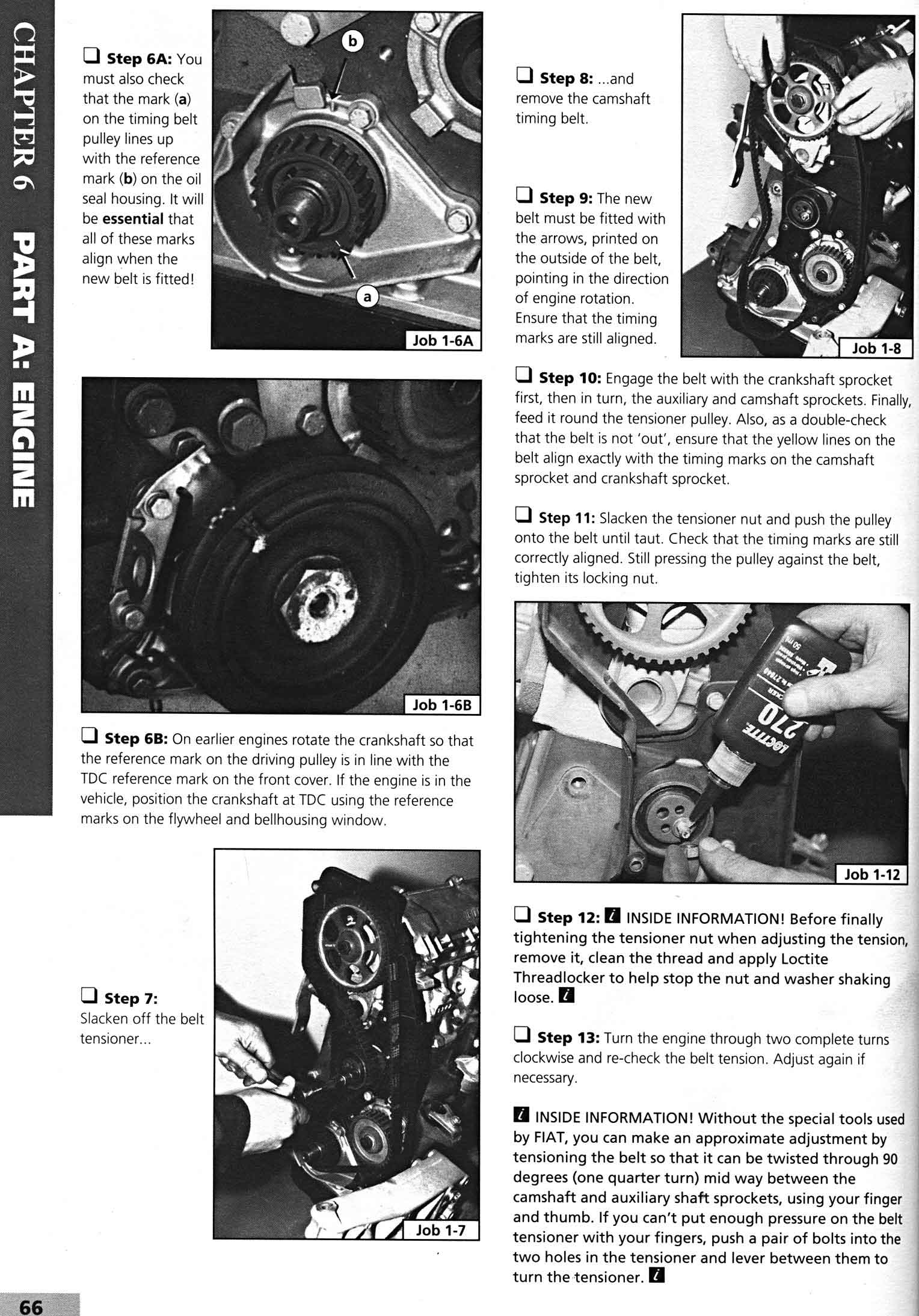

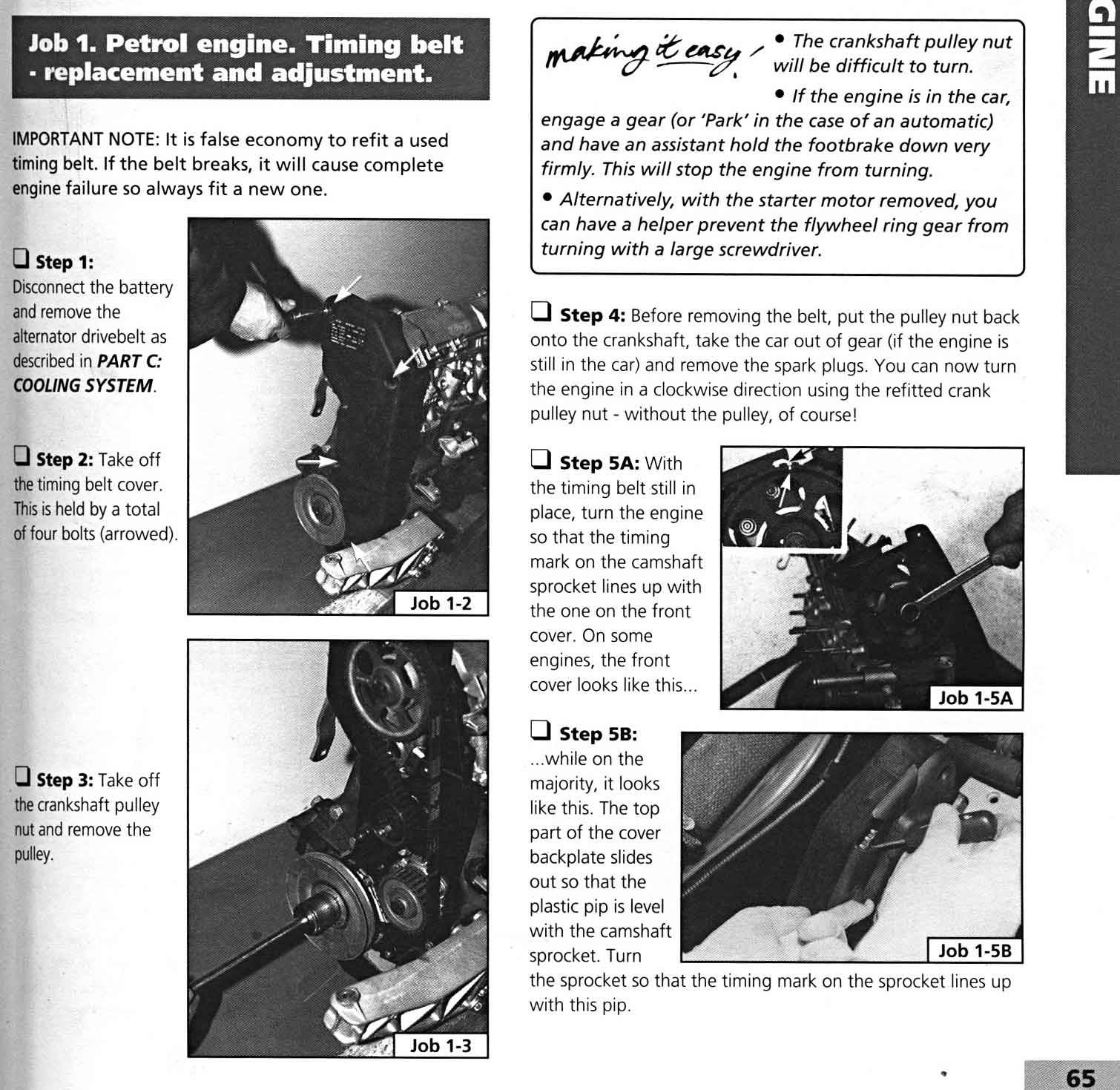

In the buttom, I can see the mark on the pulley, but not a place on the engine/plastic to allign it to ?
In Haynes, there are only illustrated models to 1991, and the pulley, don´t look that way, because this has an electronic sensor for timing.
