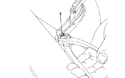

Ok here goes, you'll need to remove the window first as in the following picture:
Then you need to cut the head of the fixing pin fixing the window open/close device onto the glass support using pliers:

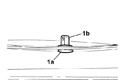

Then keep the lower part of the support on the glass and undo the upper part:
Hope this helps! (y)
