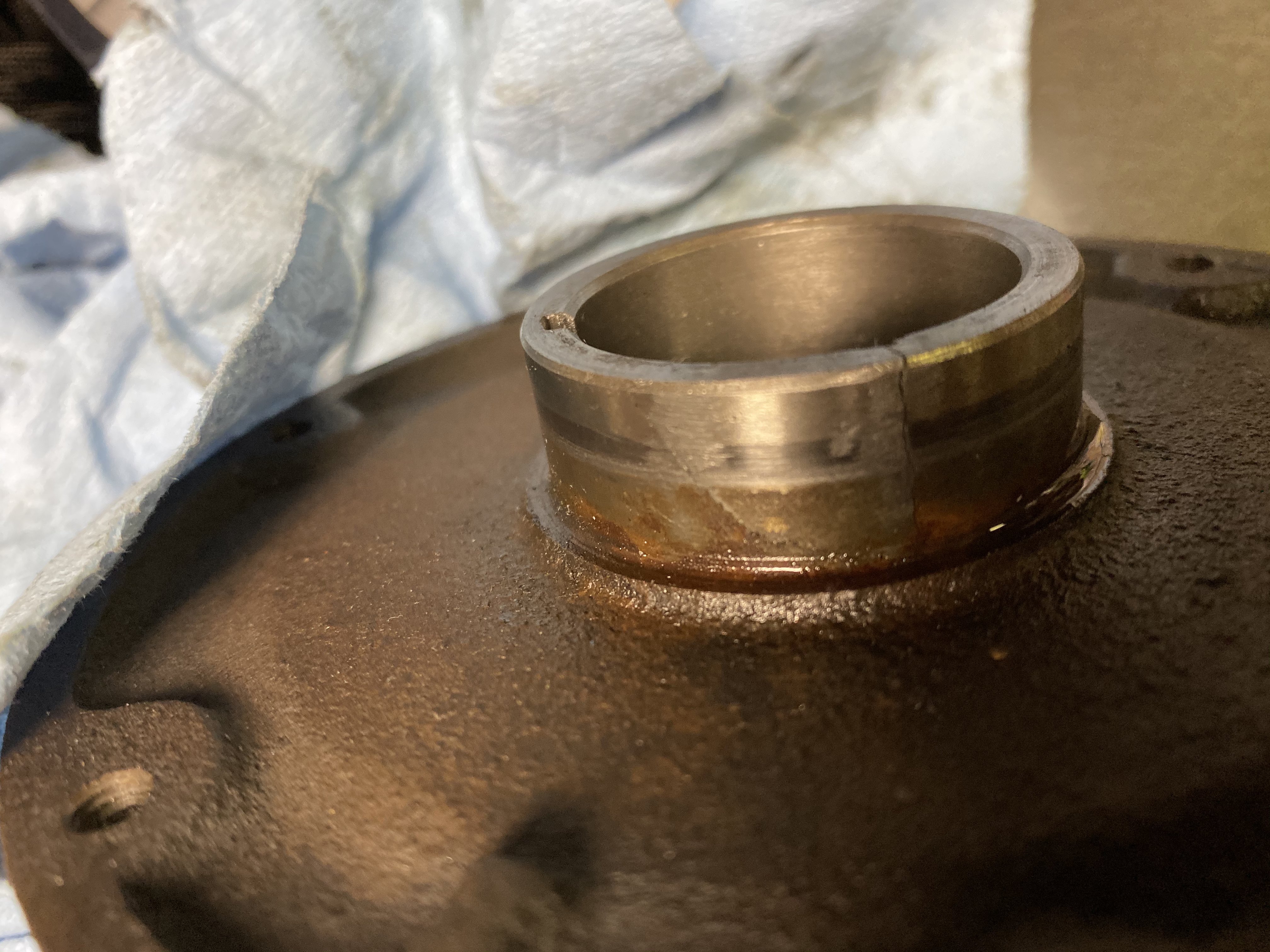

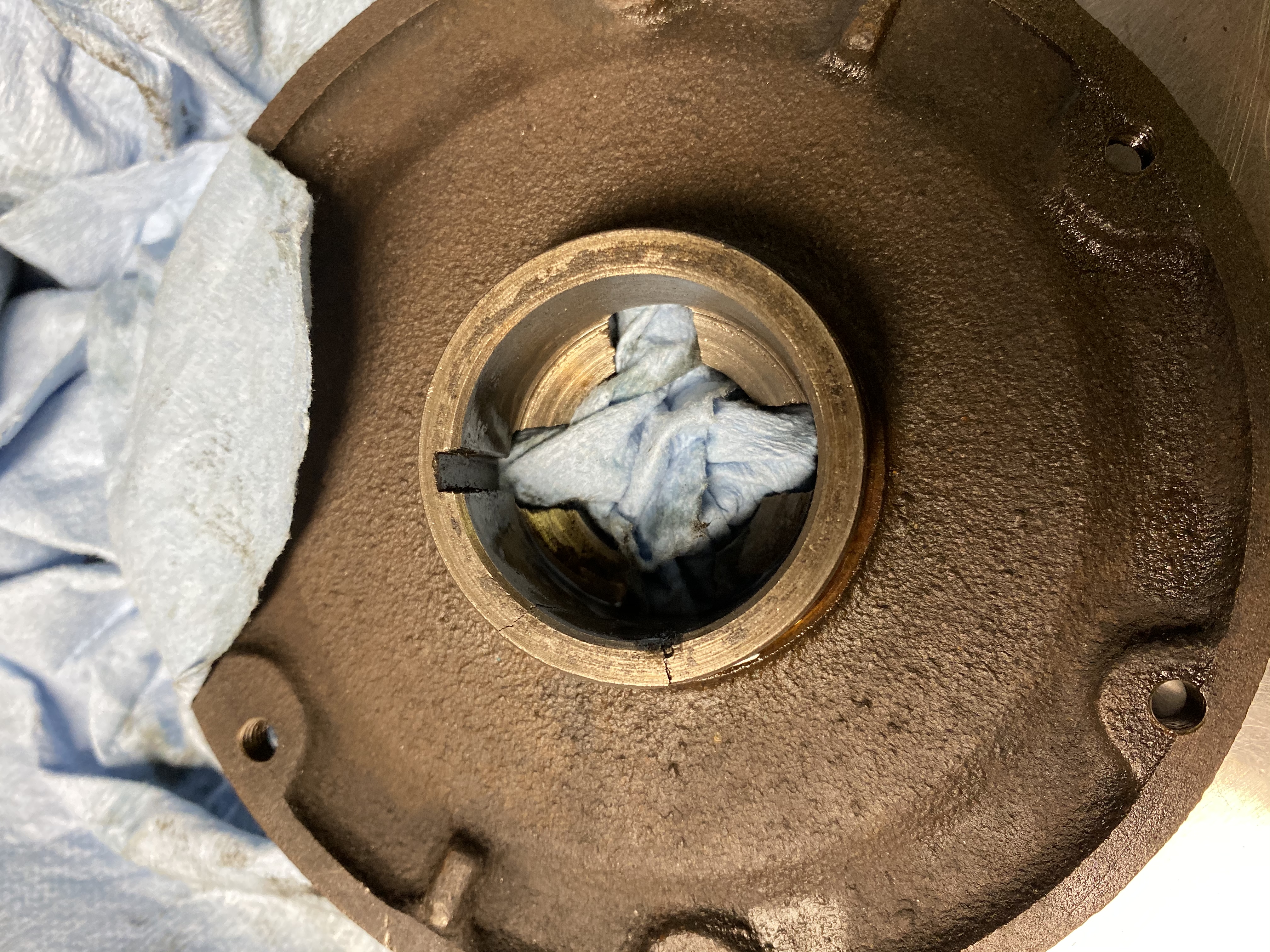

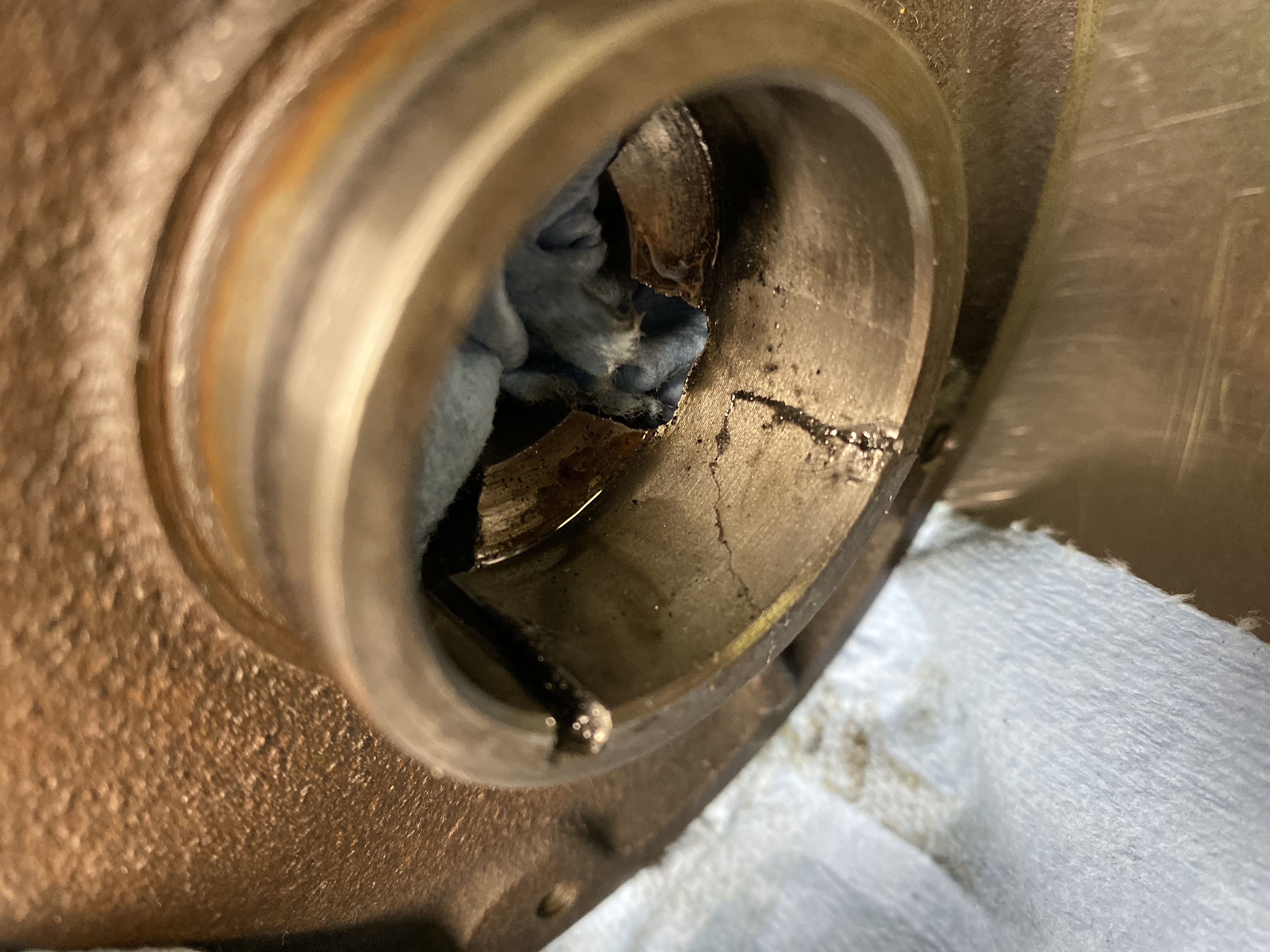

I also learned quite a few things today. After breaking a few things, so that’s good. Biggest learning point, so you don’t do something stupid like me, is there’s a key in the front timing cover pulley where the oil seal is..... ask me what happens when you torque down the 32mm hollow but when it’s not in the key. Broke the pulley. Well, cracked it and bent it at least. After it started dropping oil massively after the first start up, I took it all apart to find out what I did wrong. Didn’t take me long. I was able to tap it back and get it smooth again. At least to make sure it runs ok.

Delighted to hear that the cause of your noise has been confirmed--glad to know that my 'little grey cells' (with apologies to Poirot) are still, to a degree working. Very sorry to hear of your problem with the crankshaft pulley. Being that the 'N' pulley is different, is the damage repairable? Could the crack be welded and then the inside and outside of the 'sleeve' part of the pulley be machined back to standard measurements?

Indeed! It was right on! I just had to learn the hard way! I’ve been talking with BigVtwin996 about my car and he’s been more than helpful. He suggested welding and machine the pulley as well. I’ll be digging back into it today and will post pics to document my error and so nobody else who reads this does the same!

As promised, pics of my crank pulley! Turns out, after further research it appears all of these crank pulleys are similar. For the price of what some shops are asking for the pulley, it’s worth a try.
I was 0 for 2 locally asking anybody to fix my original pulley here in San Diego, so I need to look elsewhere!

So I may stand corrected.... I’ve now seen pictures of both pulley’s for N’s and later models, and they do appear to be different. Unsure if the older cover will bolt up to the newer pulley and function the same. I may be working on finding an original N pulley!
