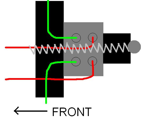

Ok so im having problems with the newly fitted (well almost) brake system. :bang:
I need to know which way the pipes go on the brake bias valve (at the rear of the car). Or even a schematic of the valve (so i can work it out).
I wrote down how the pipes went in before removing it and am 99% certain ive put them back on the same way but im having problems and from looking at the outside of the valve (from the way i see the valves supposedly functioning) i would of thought it would of worked the opposite way. :confused:

Yes i did check the bias valve for movement.
It was siezed but i got if free again and checked the little piston things could move freely.
Im not sure if it cuts off when pressure is applied to the arm or removed from it. (didnt pay much attention whn freeing things up)

Couldn't get a very good photo, I thought a little diagram might help.
Hellcat that was excellent. Much apreciated. (y)
So now i know i have the valve in the correct way (and im not trying to force the fluied the wrong way through) so now i know that either fixing or replacing the valve is the solution.
Lets hope i can fix it as i dont want to spend too much on it before i find out just how reliable it will be. :D
