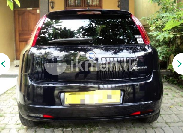

Hi Guys,
I'm new to here and I'm looking for the rear wiper arm & blade for my Fiat Grande Punto 2008.
Searched all over the Internet but I couldn't find an exact match. All just after market replacement crap.
Please help me to find the perfect match.
Note: The original wiper arm is curved upside a bit and gone to downside. All the after market wiper arms are the complete opposite.
Please check the attachment as well.

Shop4parts are usually pretty good and it says the supplier is FIAT. Have you tried calling them?
Also remember if you're a paid up member on the forum here there's a discount code for Shop4parts
Why not go to a fiat dealer?
May be easier for you if you are in Sri Lanka.
Fiat part number 55701469
From link in above post.
You can replace the rubber insert only. Very simple. Pull the old one out carefully so you don't bend the metal strips. Buy a 6mm wiper insert, cut it to length and reinsert using the original mental strips. Unless the wiper arm is broken....
Thank you all for the replies. I got it down from shops4pats :)
