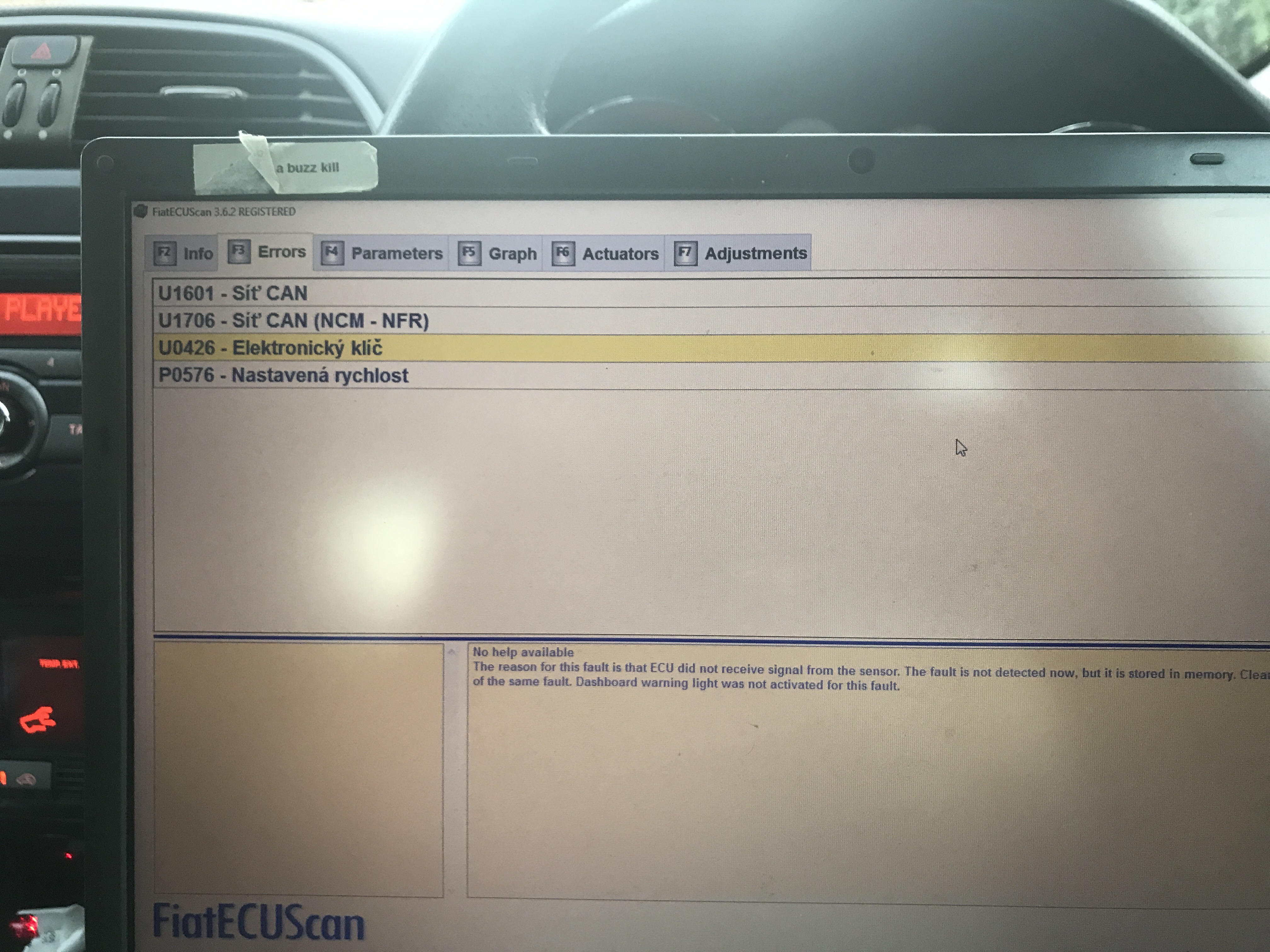

HI guys, So, i got a obd2 cable and connected it to my laptop. After scanning it shows the above error.
Can someone please help me to what it means and how to resolve them?

Hi auric thanks a lot for replying to my thread. I changed the language,
But after taking that screenshot, I erased the errors, since then Only one error keeps popping up, that is U1601 - sit-can error

I would start giving all the main power cables a good cleaning.
the battery terminals, the grounding wires, then go through the ecu connectors, the connections in the engine bay fuse box, the ABS unit connector. etc.
Your problems could also be from something connected on the can network.. like the instrument panel .. or it's just failing as a result of an error on the can network.
An error on the CAN could also cause the immobilizer issue.
You could try and unplug various components from the CAN like the instrument pannel, the abs unit..etc pentform a proxy alignment, the start the car at iddle don't drive it... and see if/when anything fails.
