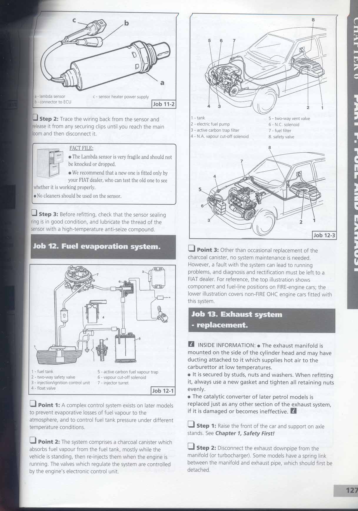

https://www.fiatforum.com/attachment.php?attachmentid=3016
It outlines the IE fuel system on FIRE (1.0 & 1.1) and Non FIRE (1.4-non Turbo) wi SPI fuel systems…
As you drive and fuel is pumped out of the tank, air has to enter at the same rate (replacing vacuum). If this airflow were restricted, so would the fuel flow be… car stalls.
After stalling and 5 minuets or so the car would be able to restart, driving ok again for a while. :Edit: Similar symptoms to Distributor wi faulty connection / cooling lol.
If you try restarting immediately, with no luck, remove the fuel filler cap, letting air in and fuel through, car should restart Very soon after (Wi cap replaced). – Problem located (tank breather valve) – not solved…
Other than that perhaps a blocked CAT or fuel pump problem?
