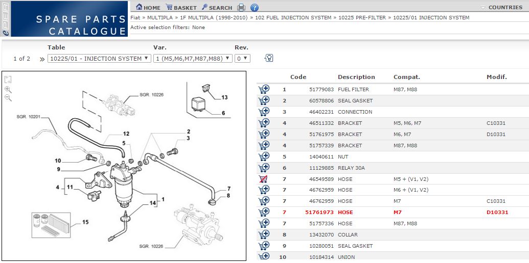

The part number I need is 51761973. I have attached the diagram from the parts manual so you can see what is causing the problems.

The part number is for the low pressure fuel pipe that goes from the outlet of the fuel filter to the inlet of the high pressure pump. Any hydraulic hose company should be able to make one for you. Give them the old part to copy, and they will possibly need to use the existing union(s).

I'm afraid I don't actually understand all the codes in the Parts pages. I don't know what the codes M5, M6, M7 and D10331 or C10331 mean so I don't know if they are relevant. Is there a FAQ somewhere? Maybe I should read the history of the Multipla first and see if that answers my questions.
M5, M6, M7 etc. refer to the type of engine fitted in the car. D10331 and C10331 refer to a modification that applied to the pipe at some point during the car's manufacturing period.

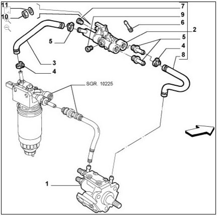

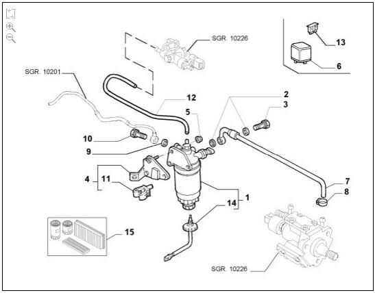

Unfortunately, your VIN is very close to the change over point between two different fuel systems. If your system looks like diagram "A" below, then I suspect part number 51761973 is correct, and the pipe will look like the picture on the outletricambi site. If your system looks like diagram "B" below, then there are some anomalies in ePER that make it impossible for me to confirm which part number you need.

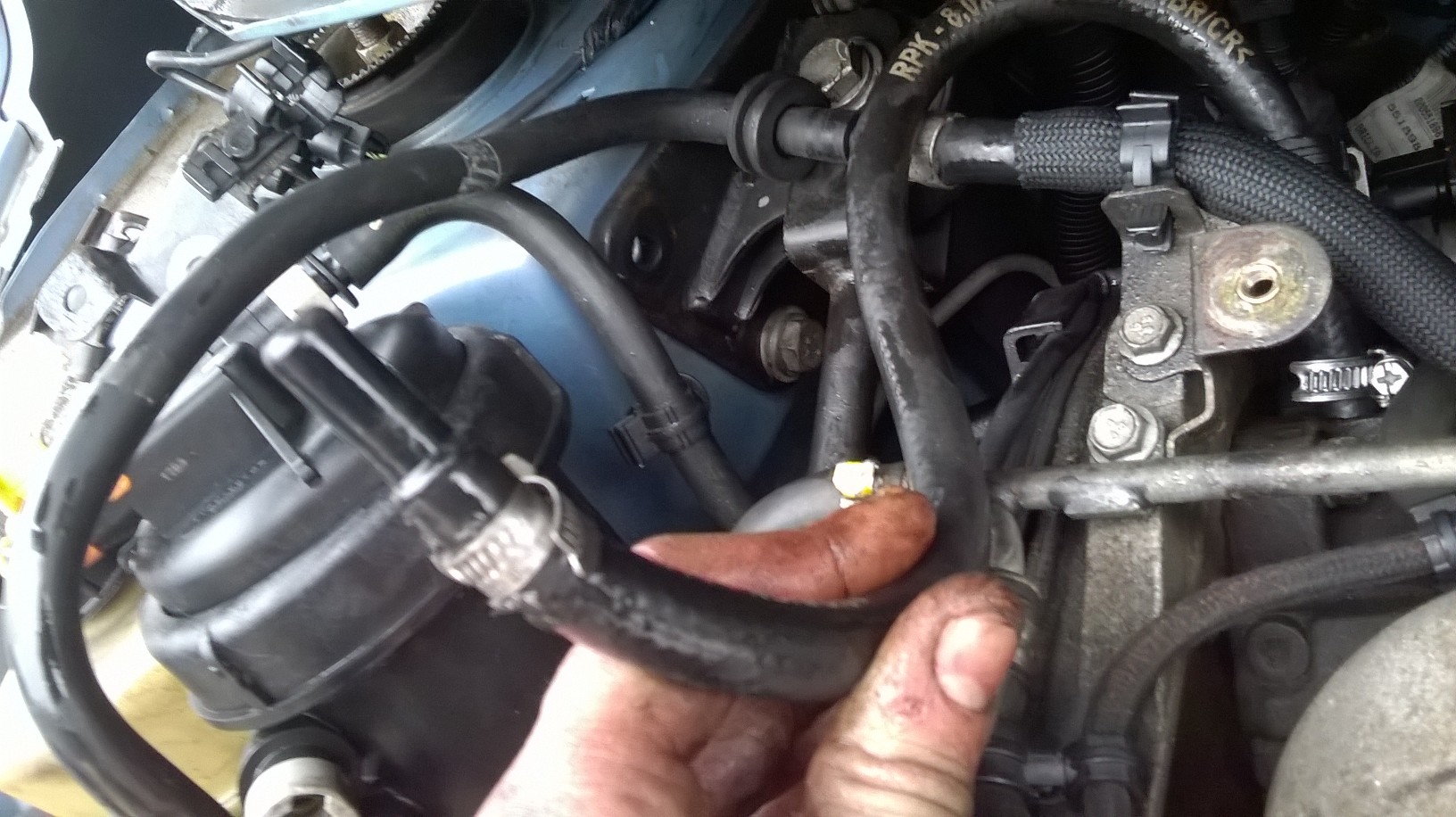

EDIT: Just seen the photo you PM'd me. The pipe appears to have been repaired at some time, so difficult to know what it looked like, and what unions were on it originally. However, the plastic top to your fuel filter suggest that it does not use the banjo type union shown in diagram "B" below.
The complete filter (boite filtre in your PM) does not include the pipes. It's only the filter housing (Item 1), and the 'water in fuel' sensor (Item 14).
