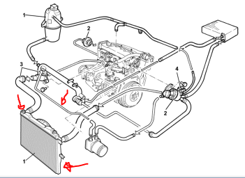

Today I found a metal pipe in fron of the engine with a screw on it for bleeding.
Once opened no air came out..
I travelled for about 25Km and outside there are 13°C. The temperature indicator stood at 1 mark..
Here are the three bleeding points I found.

Recently swapped engine in my 1.9jtd amd also changed water pump and cambelt, don't remember having to do any bleeding apart from running and topping up as well as letting air out at screw on that metal pipe. Are you sure thermostat has not failed as its very similar to ones used on Alfa diesels and they were prone to going, changed mine on 156jtd and a bit fiddly.

Are you sure you completely drain ed all the water out of the engine and radiator? If you just removed the water pump or bottom hose its possible only part of the coolant was drained hence less than the quoted capacity to refill it, heater radiator will hold 1/2 litre or so of water. Plenty of guides on how to replace clutch on here.... good luck.
