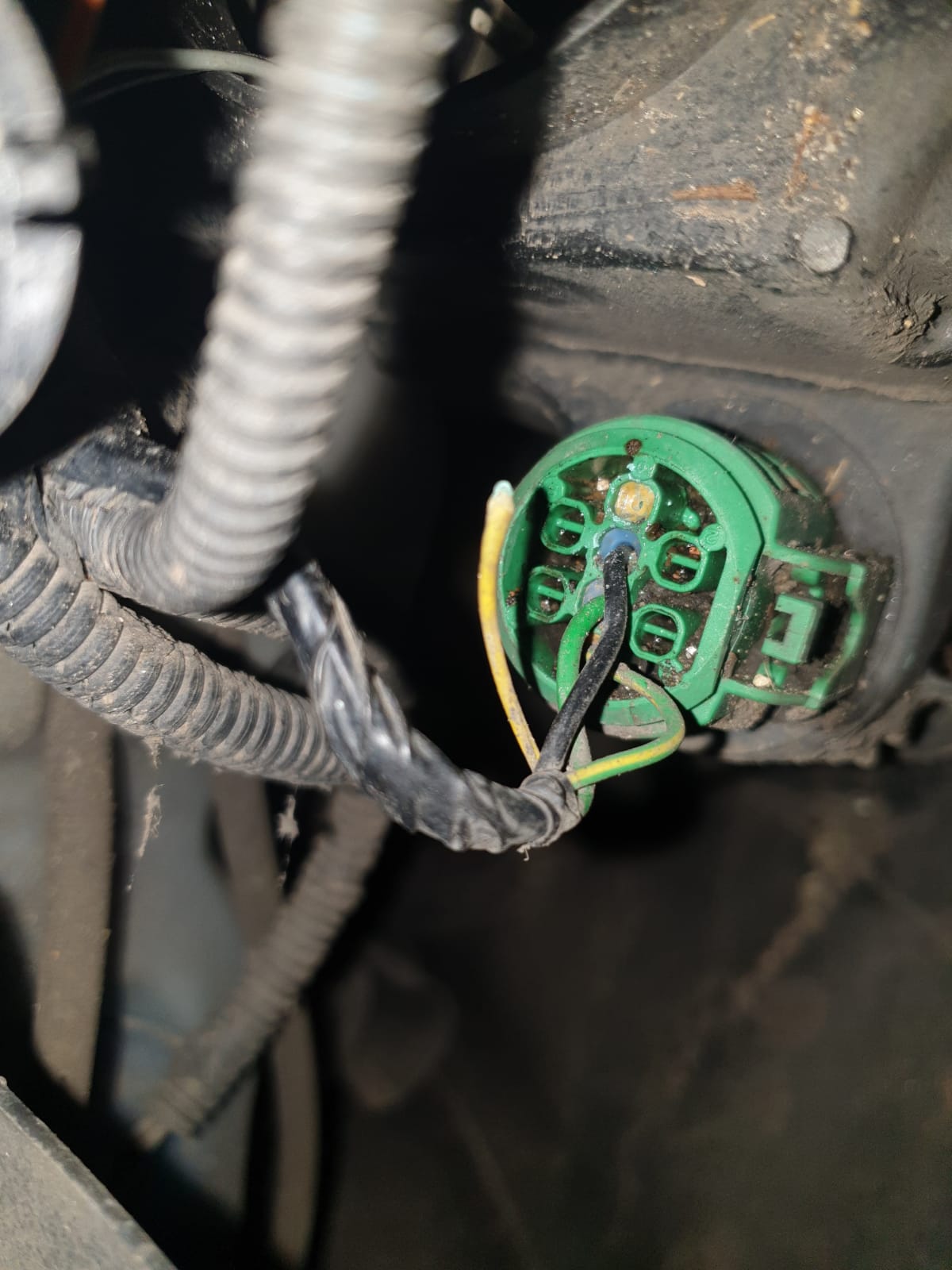

I need to replace one of my bulb holders on my 2014 500 lounge. The seal is missing on one so water ingress has caused corrosion to the wires. Does anyone know where I could get one?

I'm not sure ! The mechanic who looked at it said I needed to find a plug that goes into the fog lamp which I thought could be called the bulb holder too ? And I also need a piece of the loom too
I'm pretty sure that's the plug that goes into the cluster on the rear, so yes you need a new/second hand plug with an attached bit of cable that can be connected to the original section.
Contact this company, members have used them before and are usually very helpful, explain you need the loom plug and short section of cable include your picture for the bumper mounted light unit main beam/side light/DRL for the correct side drivers or nearside and I bet they will help you include reg in info, you could also ask if they have the wing hatch cover?

lastly you do mean the main beam unit upper in bumper and not "fog light" you said in your last post, just to be sure as your car may also have fog lights(lower in bumper)
Thank you for your response, to be honest I'm not totally sure as I'm going off what the mechanic at the garage told me, I'm not very familiar with cars ! But I will check with someone who will understand your response better. Thank you so much for taking the time to be so helpful!
Actually just reread your response it's definitely not the main beam, they are working, it's my daylight light on the right that's not working which I think the fog light is in the same cluster as
Hi so your dip headlight is the top one NOT in the bumper, ie the one you can see when you open the bonnet, the main beam and day light combo is in the bumper(the dip and main beam are separate light clusters) to help you understand I think the lounge version also has fog lights at the very lower part of the bumper here is a picture to help feel free to ask more

Thank you that's very helpful sorry I assumed the main beam was the top light. Yes the it's the plug that the daylight and fog light are wired into that has failed. Do you know if they are specific to right and left ?

Amy follow this link …… https://www.ebay.co.uk/itm/Fiat-500...=p2349624.m2548.l6249&mkrid=710-127635-2958-0
Message them and ask for a DRL loom plug tell them what size and include the pic you posted above
Give them a day or so to reply and I’m pretty sure they will create a listing for you
