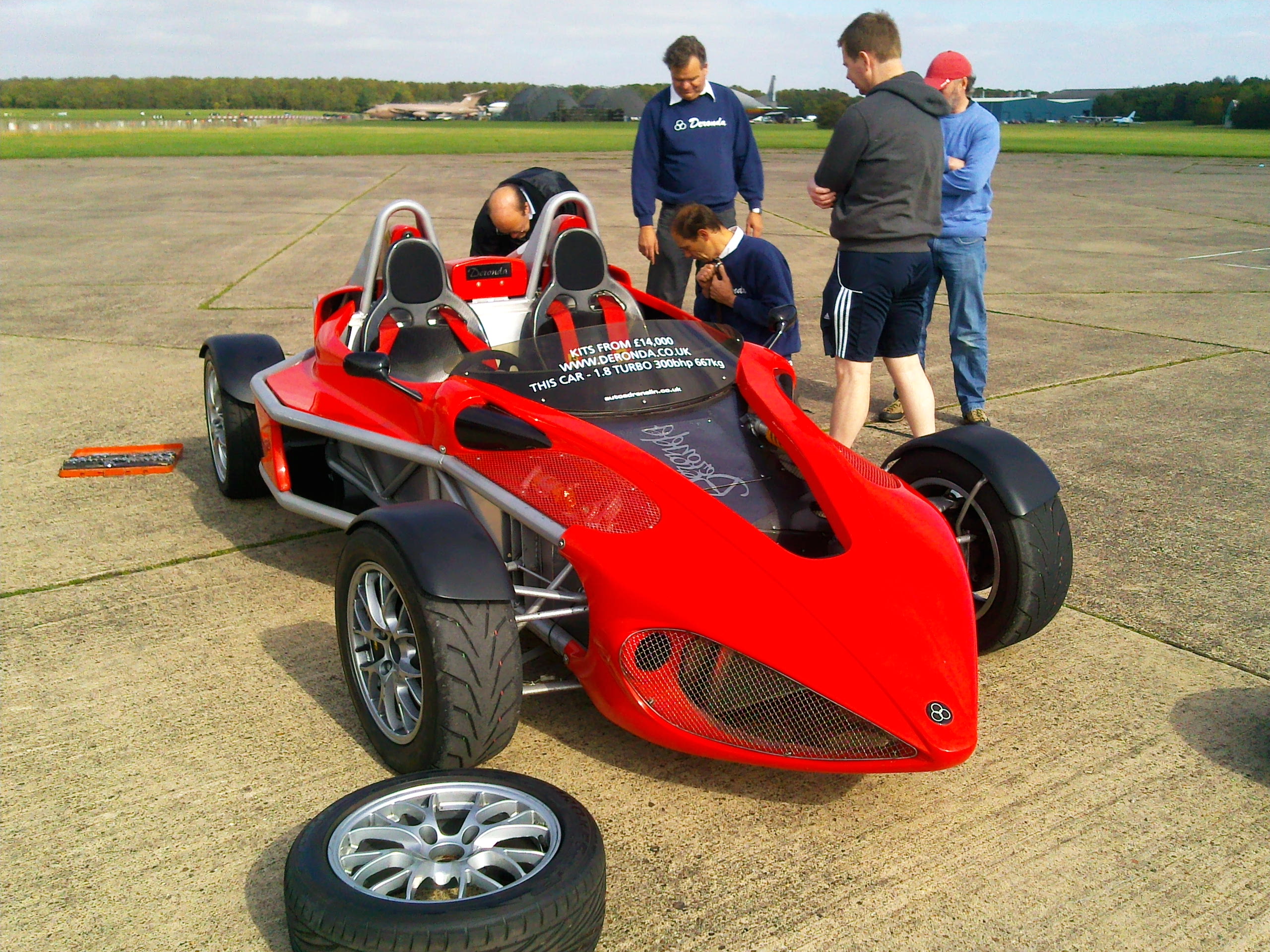

Incidentally, I did anther track day, this time in a car called a Deronda, bit like an Atom but quicker. 300 bhp in 650Kg! Very quick! Let me know how you get on.

I met the guy at Cholmondely and blagged a test drive! I'll post a pic. Good luck with Ferdi, he really is a perfectionist. Found my bill and with a full service as well it came to £500. Let me know how it goes.
