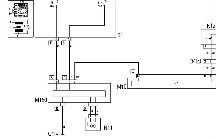

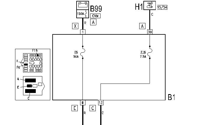

Two fuses
F6 50A this will be the main power fuse for the rad fan
and
F16 7.5A this will be for the rad fan ecu
Note F6 is permanently live which is why your rad fan can still be turned on after you turn off ignition

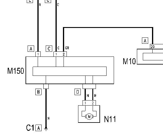

And the rad fan ecu also needs an earth which goes to earth C1A (that's your main battery earth) so it's worth checking that out too as that would give you warnings of problems on fan circuits 1 and 2

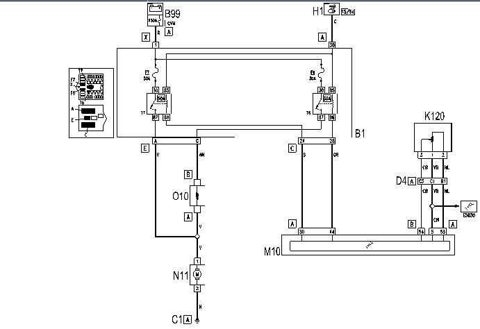

Here's the circuit diag for the relays and resistor type control. Note the aircon linear pressure switch in the system.
With the relays and resistor type then the ECU sends an earth to each relay that it wants, ECU M10 connector A pin 14 =slow or connector A pin 30 =fast.
With the rad fan controller unit system then the engine ECU sends a signal down just one wire from connector A pin 20 to the rad fan controller for both rad fan speeds
