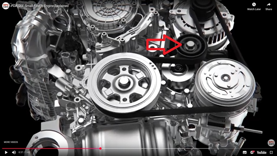

Just a guess, and this video is from the 4-pot Firefly so there might be some differences
this looks like a tensioner for the aux belt to me, I'd imagine a spanner on the nut and it should pivot to allow the belt to be replaced
Does look like it doesn't it? I would guess that's the circular spring case behind it at about 7 o'clock?
Yes, I think you're right.

Now, whether there's space to get a spanner on that tensioner nut...🤔
