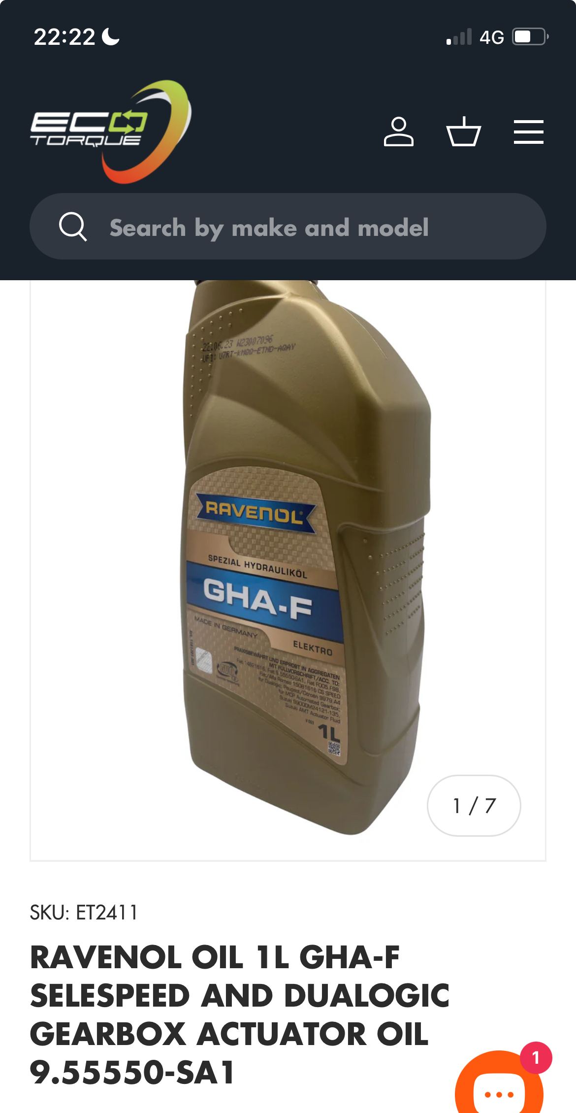

I’m in shetland (of course i am when it goes wrong) so got her to check the transmission actuator fluid, which she thought was low, ordered the recommended hydraulic oil, aprox 250ml was put in, it was up to top so not sure it was actually really low, as capacity according to Haynes is 0.7 litres.
The recommended I believe is 9.555550SA1 it appeared green, but whatever was in it may have been more clear so possibly wrong oil or really old.

The fluid is in a clear plastic tub -
"like screenwash"
The fluid in it is NOT brim full..
Apparently you CAN OVERFILL IT
My only direct experience was on a panda, and pretty sure there were high and low symbols/marks
WRONG Fluid.. That's a concern! 🤔
As its got potential to damage seals
Look on Shop4parts site for the correct fluid.. And Specs
You can call them.. They are Italian parts specialists 👍
"like screenwash"

I’ve said to leave and not drive until i can see the level, as i seen that it can overflow if too full, its in a very restricted place so not easy to see if there are max and min.
I’m assuming the previous oil may have been wrong as it looked more clear, the stuff i ordered was green.
The car is in Largs, KA30 post code
I’m sure i had a scanner basic that i used on my EOS, I will try and get any codes.
It would be great if someone was near to help with codes!
Hydraulic fluid i got attached.
thanks again!
