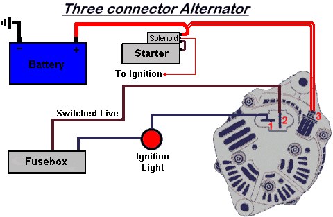

Take a wander around a wrecking yard and pick up a Nippondenso alternator from any of the small front wheel drivers like a Suzuki swift etc. Might have to change the pulley and fabricate brackets. Usually costs about $40. This is the alternator used by Kit car builders and clubmans.

I have fitted my 850 with an alternator. Having modified the water pump pulley to line up with the engine pulley, I made a bracket to fit a Small Suzuki alternator and used a single vee belt to drive both pulleys, the main wire is fitted to the alternator post but where do the three denso wires go? Can anyone help here?
Tony (atomx)
See post #2 above (from "Ramona") for wiring connections.
Or if this doesn't match your alternator terminals, you could try typing 'Denso Alternator Wiring' into your search engine - that'll give you lots of other wiring diagrams to compare with your alternator.
