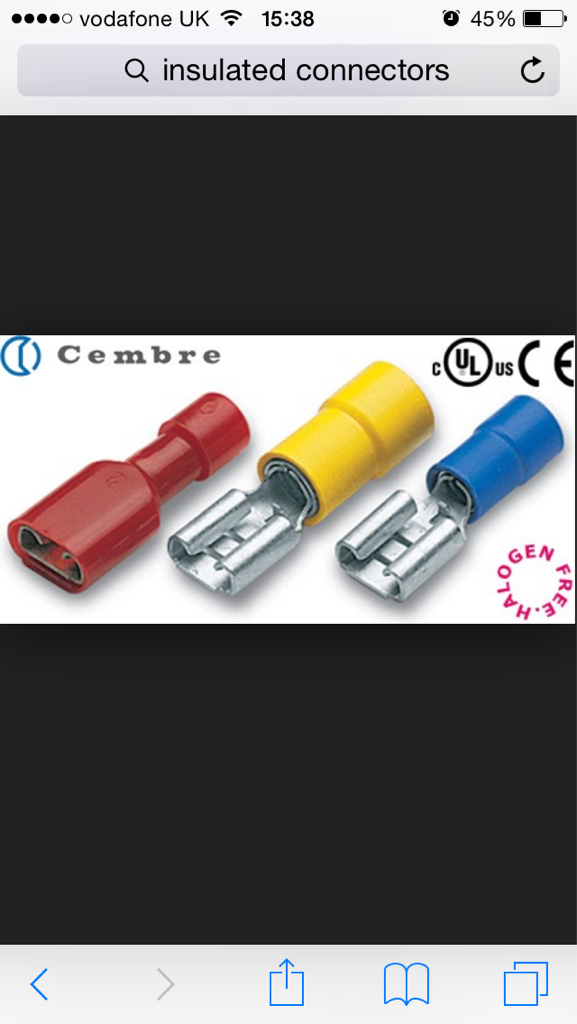

Did mine few weeks ago just chopped wires and put insulated plugs on. 4 of. Mine has climate too.
How did you manage it? Mine has climate and has packed in, ImageUploadedByFIAT Forum1420102164.030330.jpg
Those 2 connectors are shot

Hi, sorry if I sound thick but what did you actually do?
Chopped the 4 wires then stripped them and crimped 4 yellow insulated terminals onto them. Mine has climate control so different to analogue heater in think. You can buy the analogue one from eBay for about £25 I think for a new loom with the correct plug and a new heater resistor.
