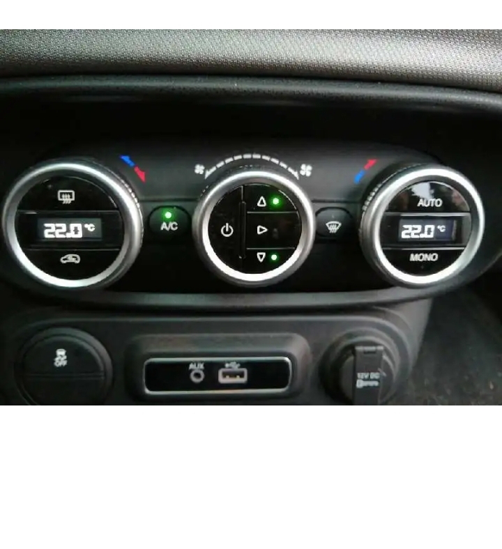

J Joanna1976 Member Joined Dec 1, 2023 Messages 12 Points 53 Location Norfolk Dec 2, 2023 #1 My heating is only working on passenger side of car in fiat 500L
V varesecrazy Patron member Written 10+ guides Joined Apr 27, 2011 Messages 34,999 Points 7,840 Location Near the M4 Dec 2, 2023 #2 Joanna1976 said: My heating is only working on passenger side of car in fiat 500L Click to expand... Hi Is this a Modern 5 door "popemobile", with Climate Control?
OP OP J Joanna1976 Member Joined Dec 1, 2023 Messages 12 Points 53 Location Norfolk Dec 3, 2023 #3 It is a 5 door 2014 500L with this climate control
V varesecrazy Patron member Written 10+ guides Joined Apr 27, 2011 Messages 34,999 Points 7,840 Location Near the M4 Dec 3, 2023 #4 No control over one side.. Or just cold air.. Not hot? There Is a reset procedure.. But if a flap is broke it will need work Where are you based.? Near Winchester Hants is a repair specialist.. But worth a reset 1st Ask if you need more info
OP OP J Joanna1976 Member Joined Dec 1, 2023 Messages 12 Points 53 Location Norfolk Dec 3, 2023 #5 varesecrazy said: No control over one side.. Or just cold air.. Not hot? There Is a reset procedure.. But if a flap is broke it will need work Where are you based.? Near Winchester Hants is a repair specialist.. But worth a reset 1st Ask if you need more info Click to expand... Warm air and cold on passenger but only cold on driver side i live in norfolk what is reset procedure please
W White 500L Member Joined Mar 22, 2023 Messages 26 Points 59 Location Scotland Dec 3, 2023 #6 Possibly the heater actuator? I had the same symptoms when I first bought the car and this part fixed the issue.
