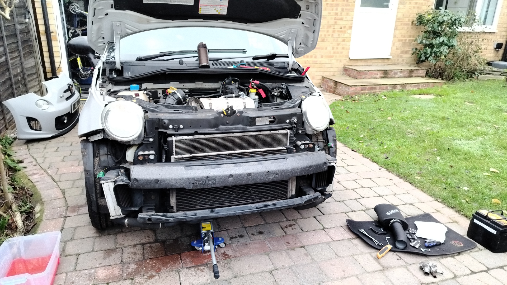

Hi Peeps, dipping my toes back into the site after my Stilo Schumacher died way back in 2018...This conversation/ enquiry/thread is to do with my daughter's 2012 500 Abarth that I've currently been working on to get the heating back up and running...story goes that a garage did a flush of the system and when that didn't work defaulted to it needing a matrix replacement at £1k "in the hope" that's the problem. Having previously researched heater matrix replacement on the 500's I knew that rather than the usual expected complete dashboard dismantle, oddly, the Italians have made it a very simple process. Rather than mess about, and it not being the heater matrix, I've opted to replace thermostat, matrix and blower motor in one go.
The thermostat turned out to be by far and away the most labour intensive and difficult job with most of the engine bay on the battery side needing stripping out to get the access needed, however with access finally gained the swap over and fitting was relatively simple.

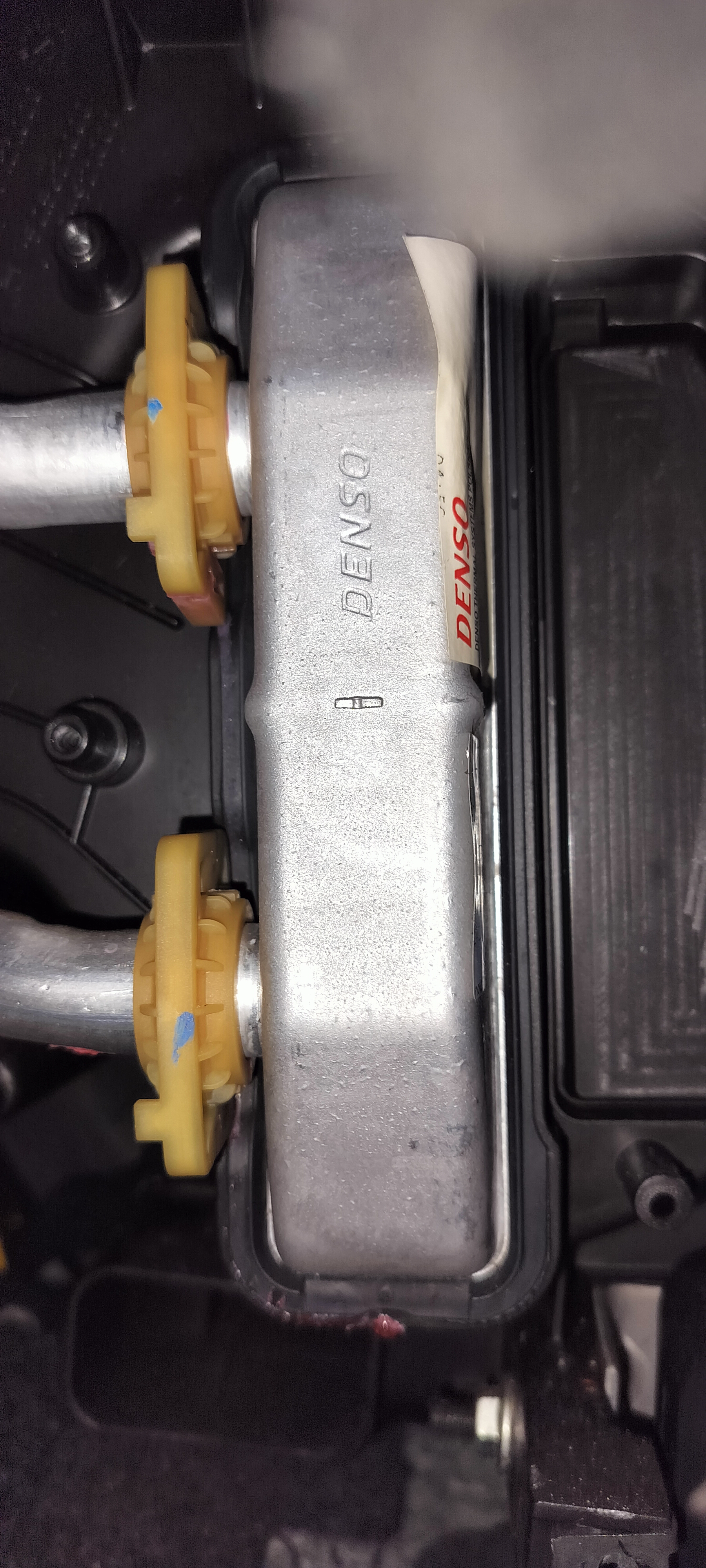

Changing the Heater Blower was again relatively easy, as was the Heater Matrix/Core once access was gained via stripping out the left passenger side gloves compartment area and releasing cowling around the gear stick.
As is often the case I was initially sent (used registration rather than vin) the incorrect Heater Matrix/ Core but quickly turned around the correct one by simply sending part ref and images of the one removed.

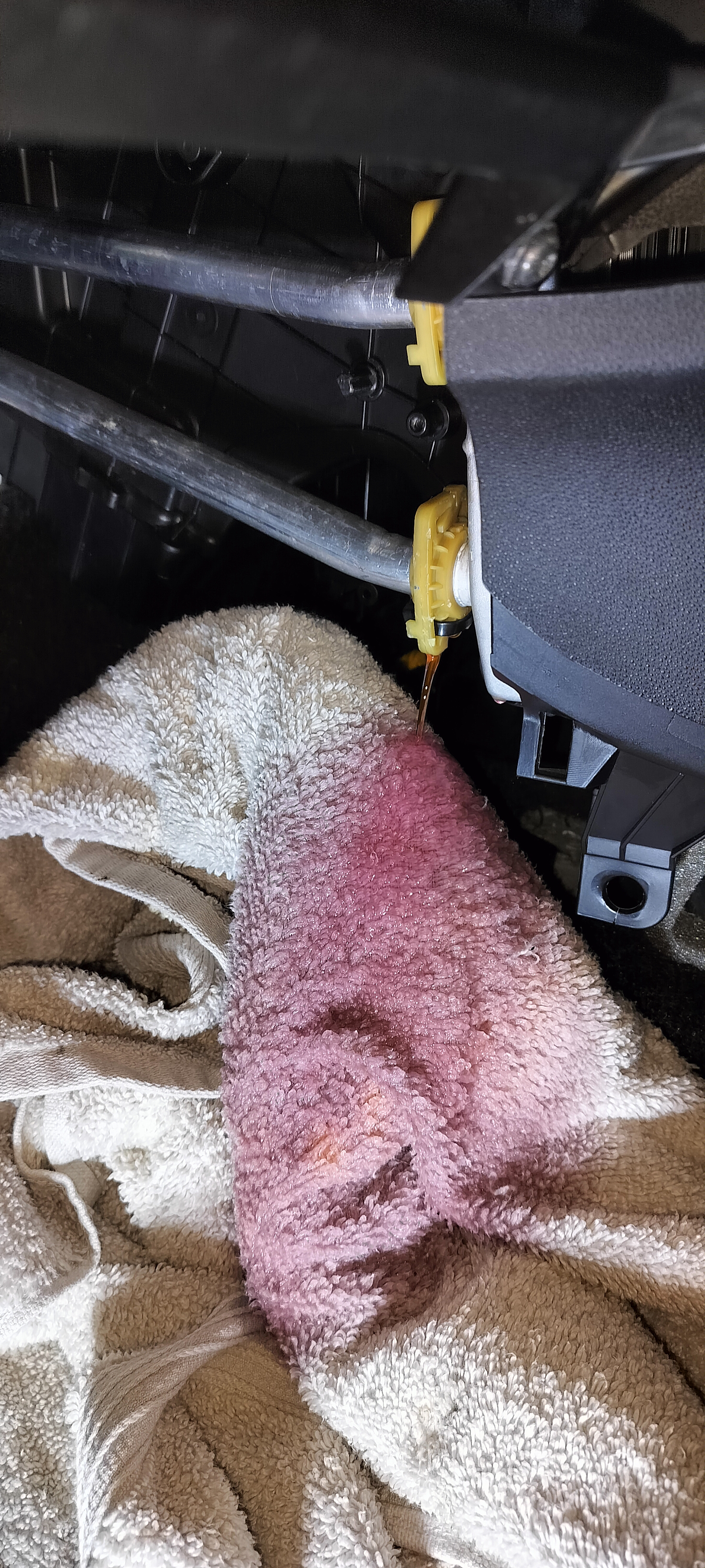

Here is the crunch of my thread!...the main stumbling block is now the need for replacement (only one is broken) pipe to matrix compression/ securing/ sealing 'clips', which so far appear to be like trying to find unicorn tears, with unicorn tears probably more likely to find!
I had hoped that on the broken clip I could use a decent cable tie to bring the broken ends together but sadly on refilling the system it simply isn't enough.

I've included a few pics and a vid showing stages of the work, the matrix and infamous 'clips' with a vid after last night's attempted refill and nicely leaking seal via the lower clip...have always loved the site and found it an invaluable source of info and advice etc, keep up the good work 💯 💪

I opted to purchase a new aftermarket heater matrix, which included pipes and a separate pack of the all important clips and seals listed on eBay.
The matrix was listed as for Vauxhall, however clips and seals looked identical to what I needed and the part ref' linked to several other makes and mods such as Fiat, Opel.
The matrix with bits were with me within a few days, and I got the new clips and seals straight onto the earlier fitted model specific matrix.
