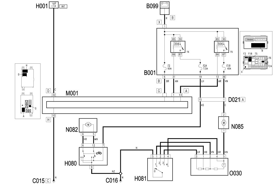

This is the wiring diagram showing the live side of the Heater Blower Motor coming straight from the fuse box. Then all the switching of the Earth Side...
