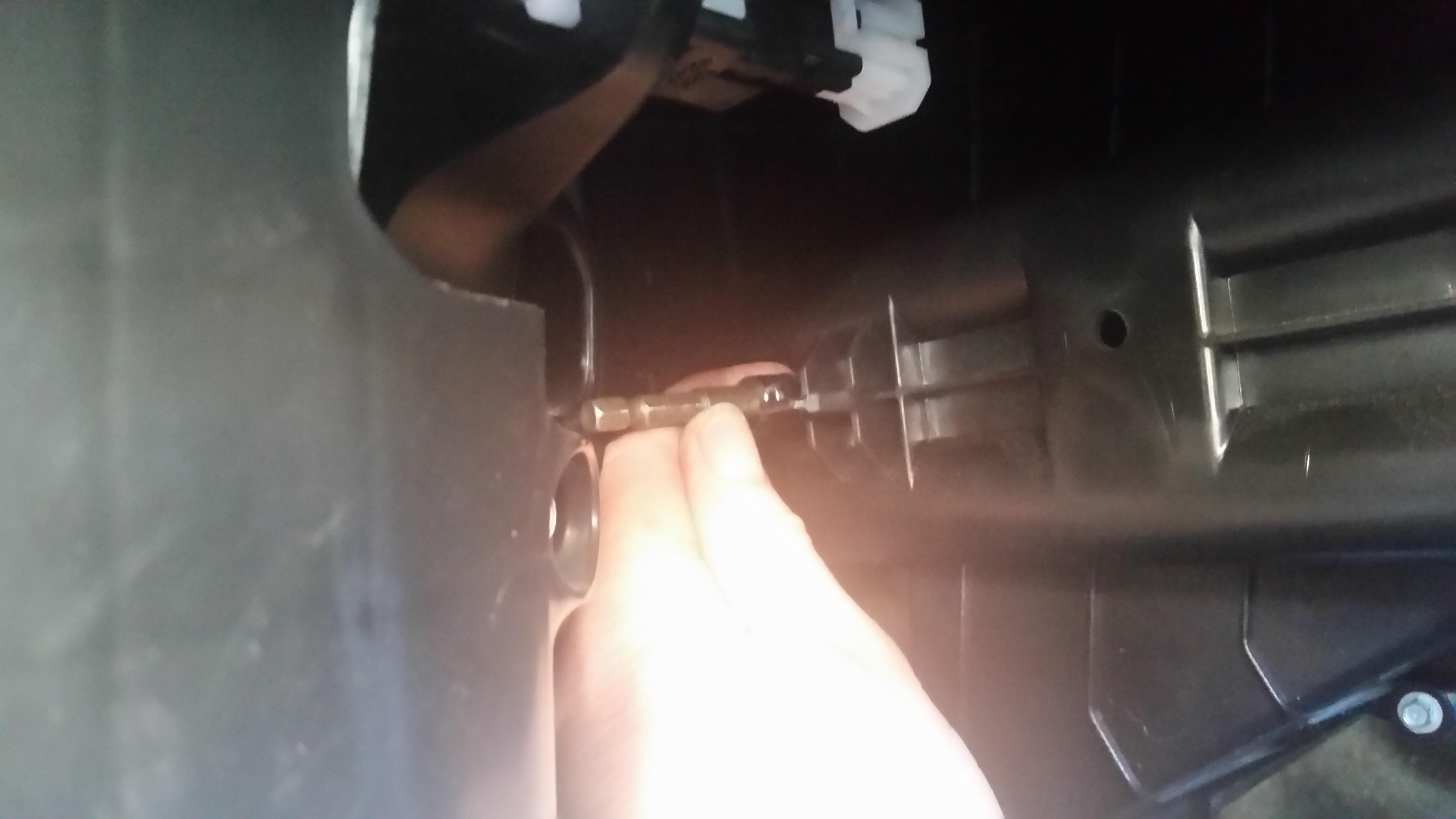

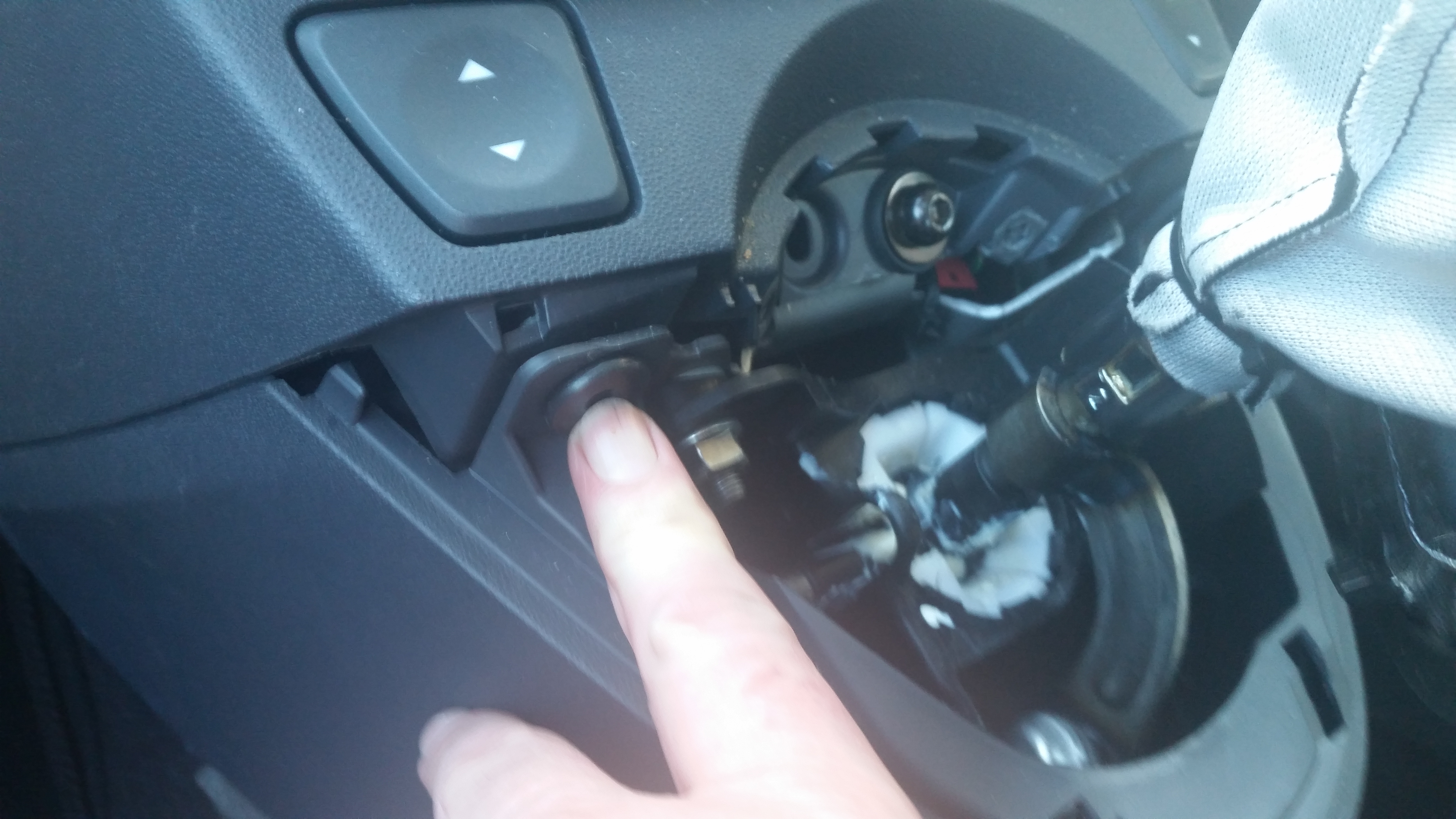

Ok I'm tired but here's a quick guide text first then pics
Remove the two small trim panels either side of the centre console 3 Torx head bolts/screws one side 1 drivers side.
Prise up the front gear gaiter plastic trim and lift up out of way no need to remove, remove the two small silver cross head screws being careful you don't drop them into the heat stick/selector.
Remove the two large Torx head bolts from the top of the main center trim and the lower ones each side and remove the large central trim .
The heater matrix cover is held by 2 bolts at the front and 1 near the rear that's hard to see, remove all 3 and the cover, now you can see the pipes and matrix connection.
Its up to you if you replace the pipes that go through the bulkhead I did but it crossed my mind you could get away using the originals with new sealing O rings (supplied with new one) and some sealer.
Drain all the coolent by disconnecting the lower hose a quick disconnect fitting is fitted pull up and remove the clip then pull off hose from below.
Remove the bolt holding the plastic hose assembly to the matix whilst pulling out the matrix from the dash pull/wiggle the pipes connection apart note loss of coolent
Fit new matrix the same way wiggling the matrix and pipes to get it to fit using new pipes or original with new one rings and sealer.
Replace all trim parts and refill water/anti freeze bleed air out of the heater hose whilst filling u der bonnet check water level for several days later.

The last picture shows the new pipes going through the bulkhead which the ones fron the engine connect to, if you do replace the plastic ones as shown note the clips securing the rubber pipes can be hard to remove but "snap open" with force once you get the knack new clips required
