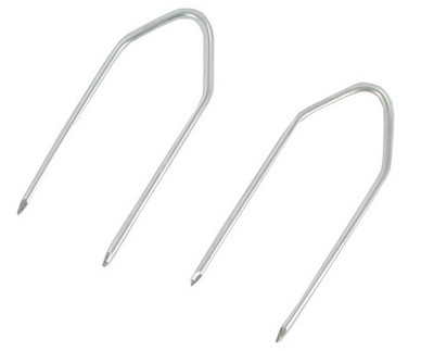

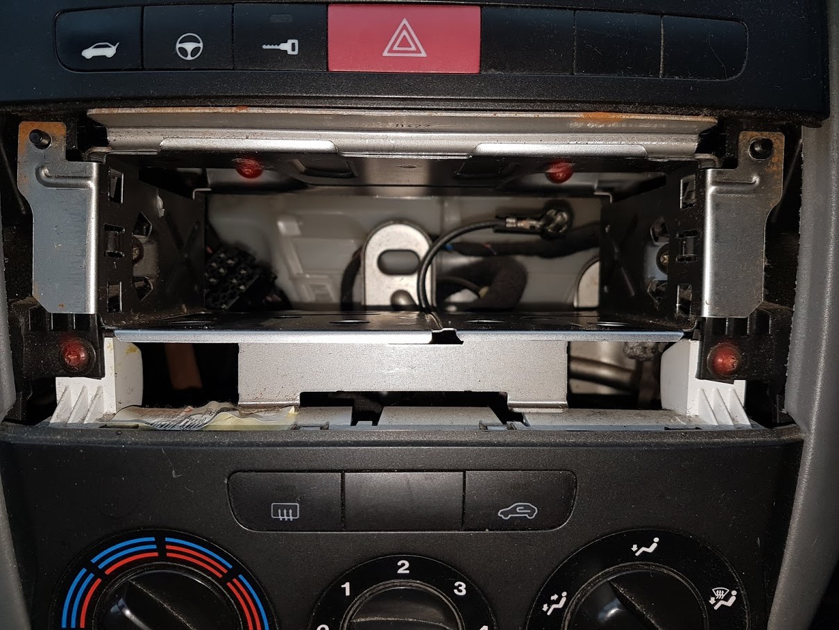

It's actually quite simple to get at the back of the controls
Remove your stereo using removal tool, or if you don't have a removal tool, bend a clothes hanger into a U shape to go through the 2 holes on each side (This is what I did)
Then you will see the frame for the radio and there are 4 screws where I have shown in red. These are torx head. Remove the 4 screws and that's it. You now have access to the back of the controls.
