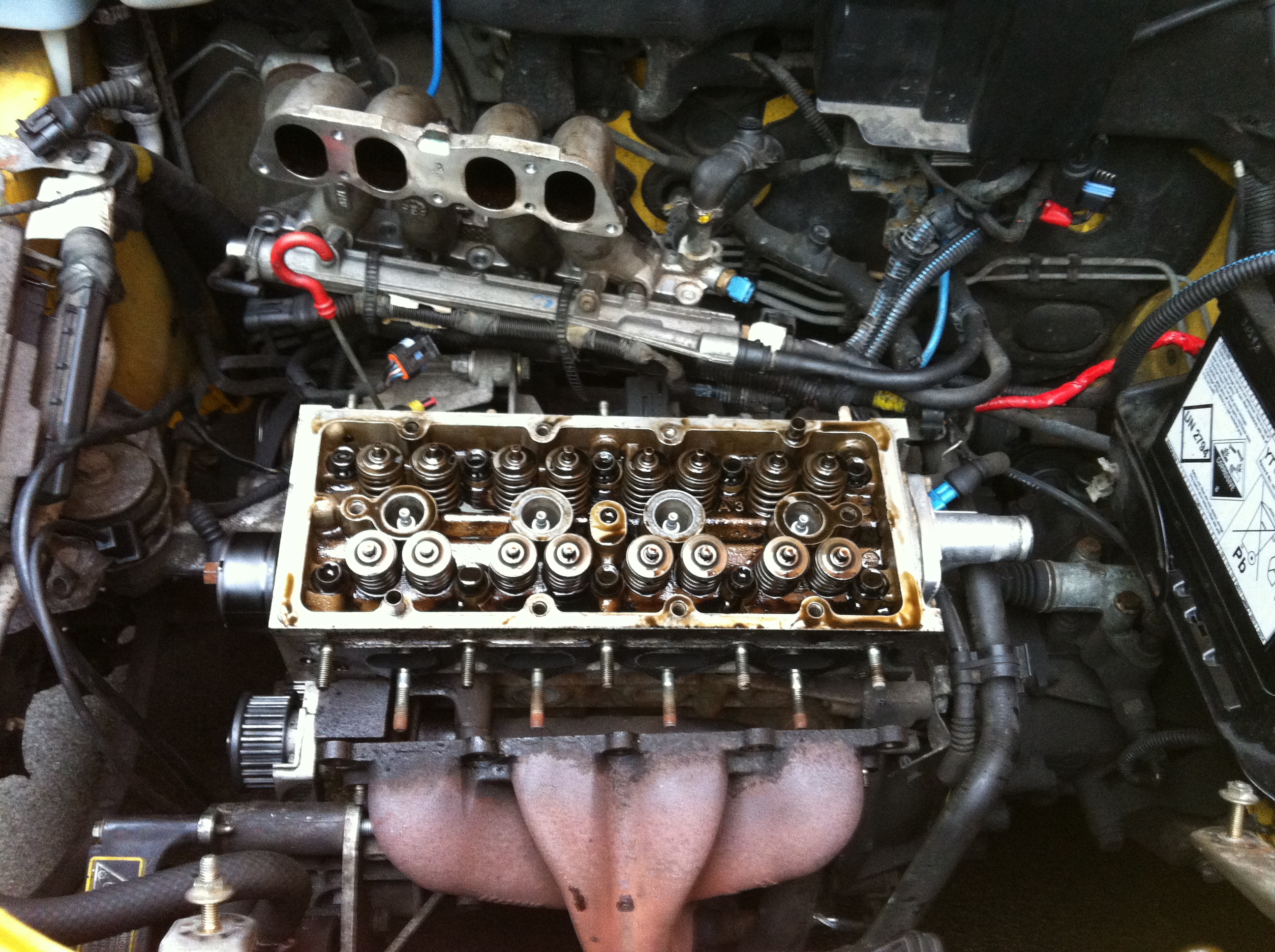

Ahh cheers Dave.
yes, its a bit fuzzy but I get the gist! If you could get an in focus shot, that would be great.
Been out just now investigating further and can lock the cam with one of my torx keys which fits really snug .. when locked it all lined up with marks someone had previous made on the pulley, so timing looks good and I will use them as a reference again.
Bar the tool to stop stuff falling out, and actually ordering the gasket, I'm all ready to go (need to get the right size ribe/torx bit though as I wont have much luck undoing head bolts with keys )...
