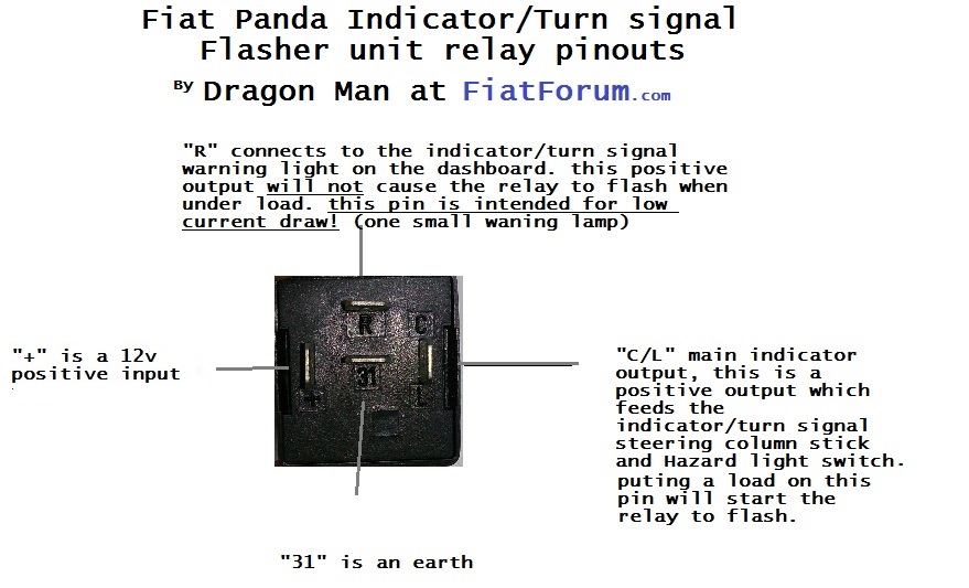

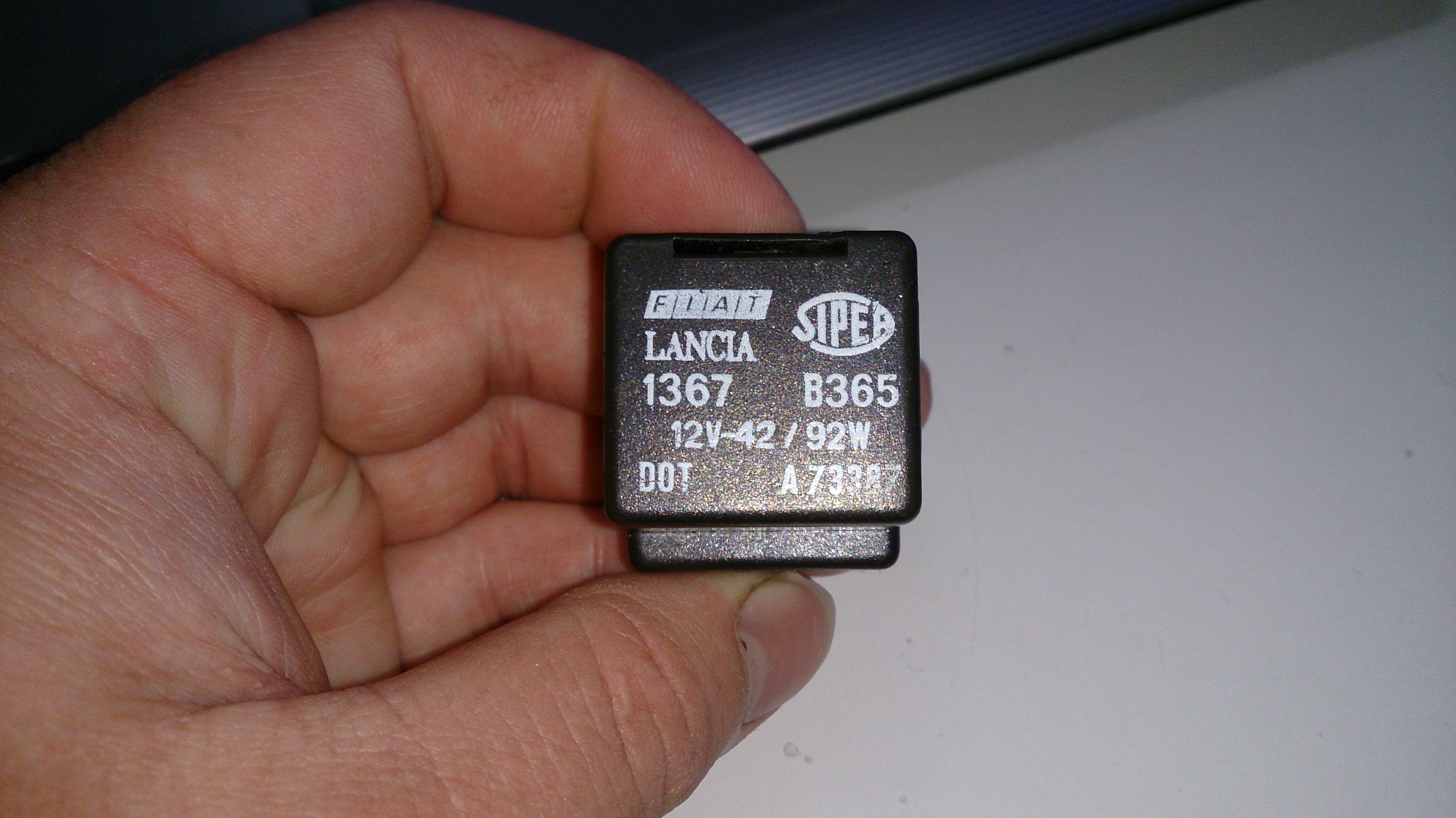

one other thing to check would be the little flasher unit on the fuse box. maybe the load on it is too much when all 6 indicator/turn signal bulbs are flashing...?
as i remember it is the.. umm.. 2nd one across just above the fuses.
they can be hard to find .. a standard 3 pin flasher will work (so long as the pins are in the right order) but you may loose your dashboard light.. hence in the following picture there being a wire coming out of the relay going to the light in the dash:
basically i soldered a wire onto the coil side of the relay inside the flasher unit. so i still get the one dash light work for both sides.
as i remember, that flasher unit came from out of a Ford Sierra..

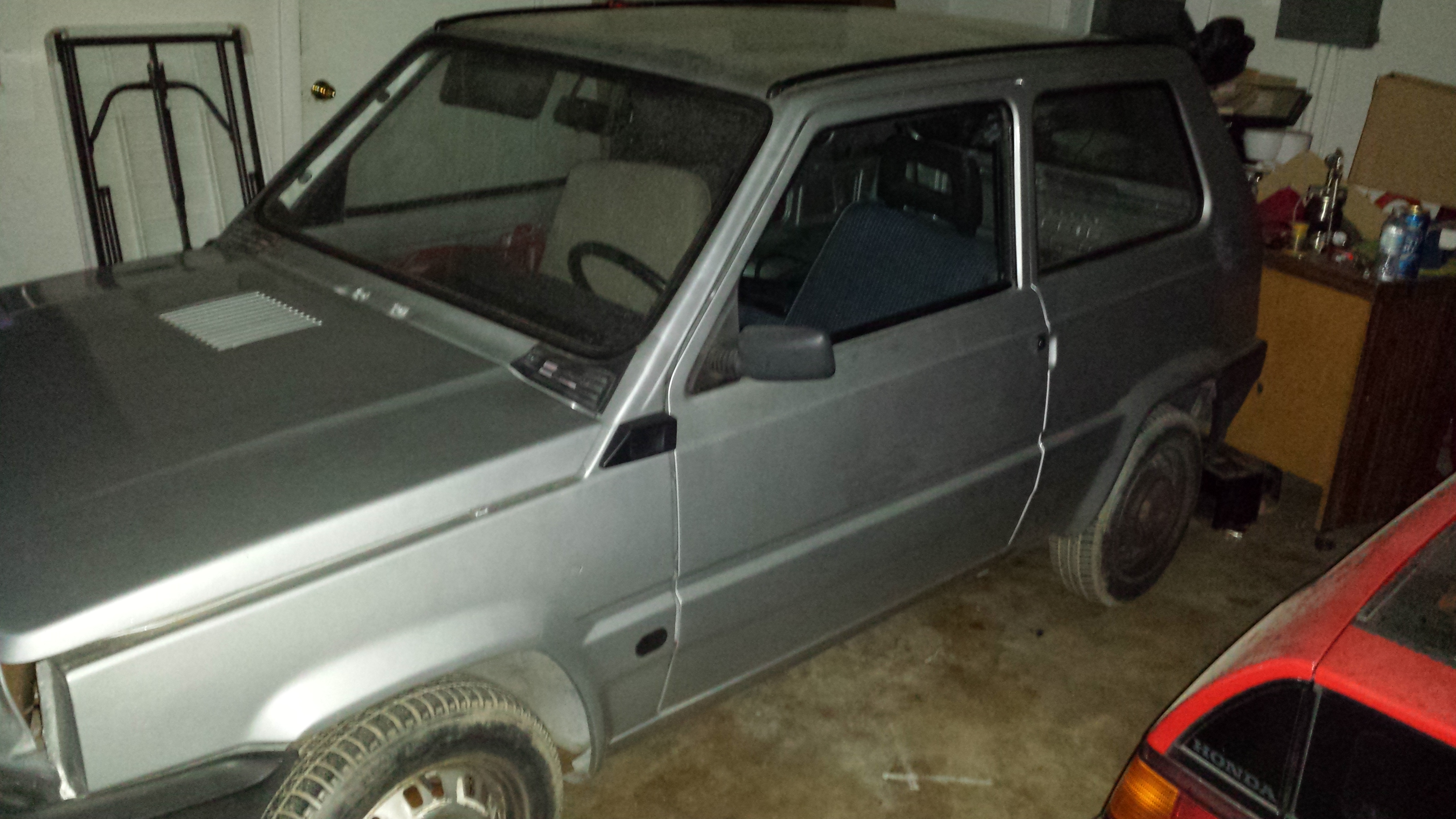

if you have any pictures of the panda, i think i speak for most in the classic panda section here, we would all love to see it!
i only know of one other Fiat Panda classic in the USA and it is a grey 4x4 known as Juppy that now lives in a motor museum.
if you google Juppy the Panda you will find pictures of it :D
Edit: here it is parked up at Times Square:

fantastic looking panda by the way! dont see many grey panda 750s around the UK, so must be super rare across the pond there.
how many miles/kms has it done? those doors! no rust! here in the UK, about every mk2 panda door is rusty. its why my panda 4x4 (the one with bull bars) has Seat Marbella doors on it.
Thanks. Actually it was red and the guy I bought if from re painted it silver. Like I said it is a work in progress but I will update pics as I get it all done.
