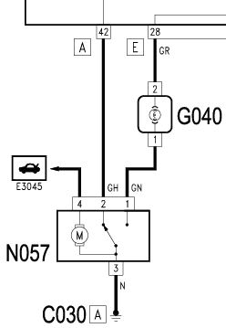

Seems that the switch bring earth to the body computer when hatch is closed, so disconnect the wire won't help, you'd have to ground it permanently …

Bernie,
Thank you for the above advice / diagrams. I am not the best with wiring diagrams so please excuse my novice question. would I therefore need to ground out the cable in port 4(Of the first diagram?) Sorry not the best with wiring diagrams
NO! That would be bad, resulting in a blown fuse and you would need to use the emergency button on the lock to open the hatchback, but you could try to shorten the two pins near the mid (pin 2 and 3) directly at the connector and see if that cures the alarm, you don't need the lock connected for that.

As Kjeld said, pin 2 needs to be grounded to inform the body computer that the hatch is closed, and as DGPunto said if the wire that brings that ground is broken, info will never reach the BC …

You could still power your circuit with "30" terminal (key ON) circuit ... As you can see on the drawing I posted, the hatch status (micro)switch is an inverter, so in one position it informs the BCM that the hatch is closed (no red warning @ dashboard) and in the other one it switches ON the trunk (boot) light, is that so complicated ?

No it is not, but my other position is not working, so I need to not-gate the boot closed BCM pin to operate the light. Meaning, the boot is closed, I get ground from the micro-switch, and that activates my circuit to switch off the light. When the boot is open I have the light shorted to ground by default to get it working. So how does key-on power help me here? I want the light to be off when the car is not used and the way I see it, it is then that would need power.
