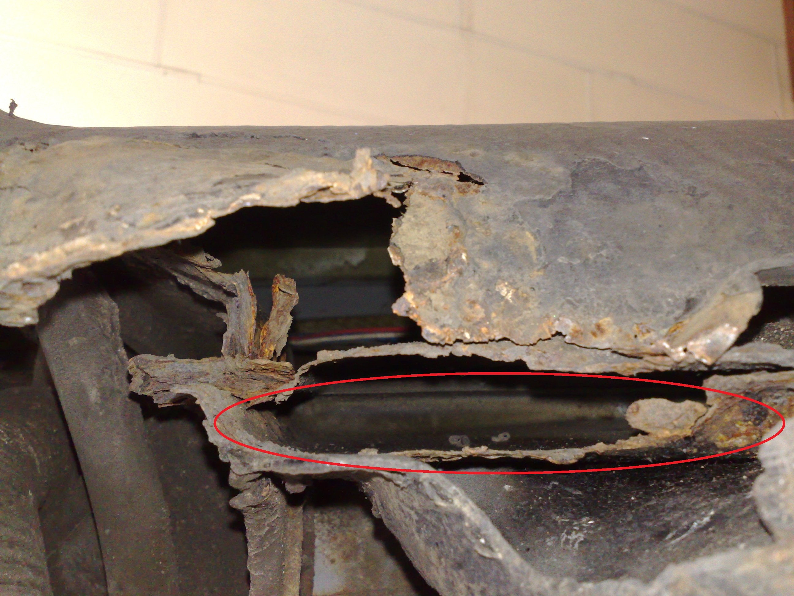

I have circled the bit that has gone in one of you pictures:
It is just that inner skin, the rest is fine. I made up an L shaped patch and have welded it on as best I can, it is almost impossible to get to it properly from the inside due to the trailing arm mount being where it is.
