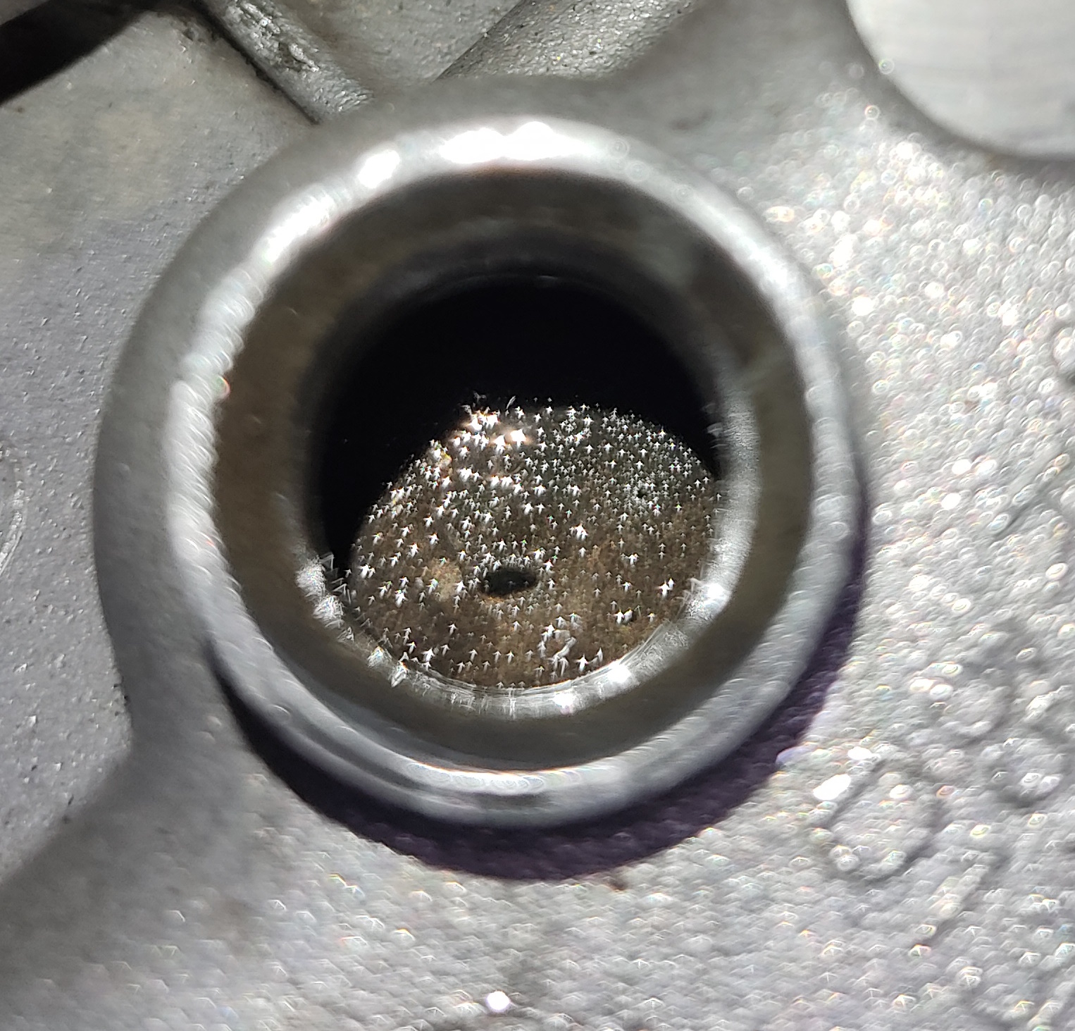

For the record I opened the vent cap today and this is what I found...
Can't really see too much in the photo
It's burred and camera shake, not any easy location to photograph
I am guessing it's got a bit of gold glitter in there
There will always be some wear on the balk rings, so some is to be expected
