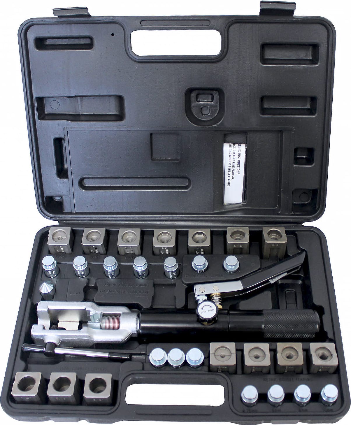

As far as flaring tool go.. I realize that most dont want the cost of a simple repair to spiral out of control. But sometimes its not hard to convince/justify lol another tool.
After spending many years playing around with one of those cheap manual flare tools. Which was always a crapshoot 50% chance you would get a usable flare out of it.
Last year i invested in something to save me from grey hairs.
It wasn't overly expensive imo (150$ cad? iirc), but does all the standard flares (metric/imp) (single/double), as well as all the specialty flares for efi lines and the such.
There are many different re-brands of this same tool, but its just a decent quality shenzen import for most of our regions.
Might be worth a look at if you have a aging fleet of cars, and live in a corrosive environment. Ive done many flares with it in the past year, and it has worked as expected.

I was just looking back through this thread and took a closer look at your purchase. That's rather a nifty looking bit of kit. I'm presuming the "T" handle on the side locks the split die into the tool as it also clamps the pipe into the die? Then the black handle is screwed down onto the forming die and the lever is worked to force the forming die to form the swage? Only question that enters my mind with tools like this is do you really need to accommodate such a wide range of pipe sizes? can it cope with steel tube? If I owned one of these I think I'd be leaving it open on my workbench for a few weeks so I could drool over it every time I went into the workshop!
