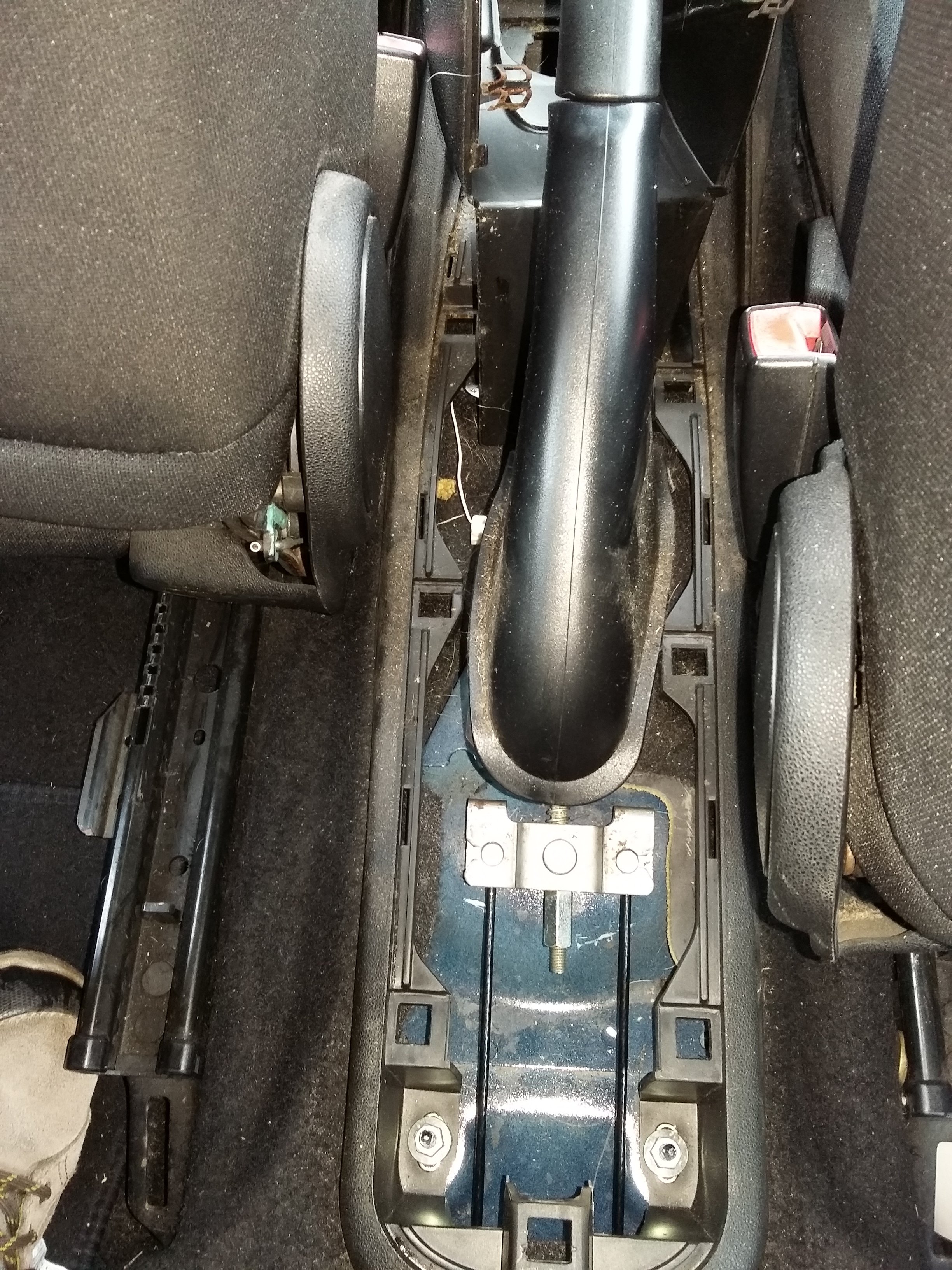

This is a complete night,are of a Jo if you have the armrest, Fiat put a big metal cage over the handbrake components to mount the armrest to.

Beware that cables are in short and long versions,
shop around.. As pricing is random
