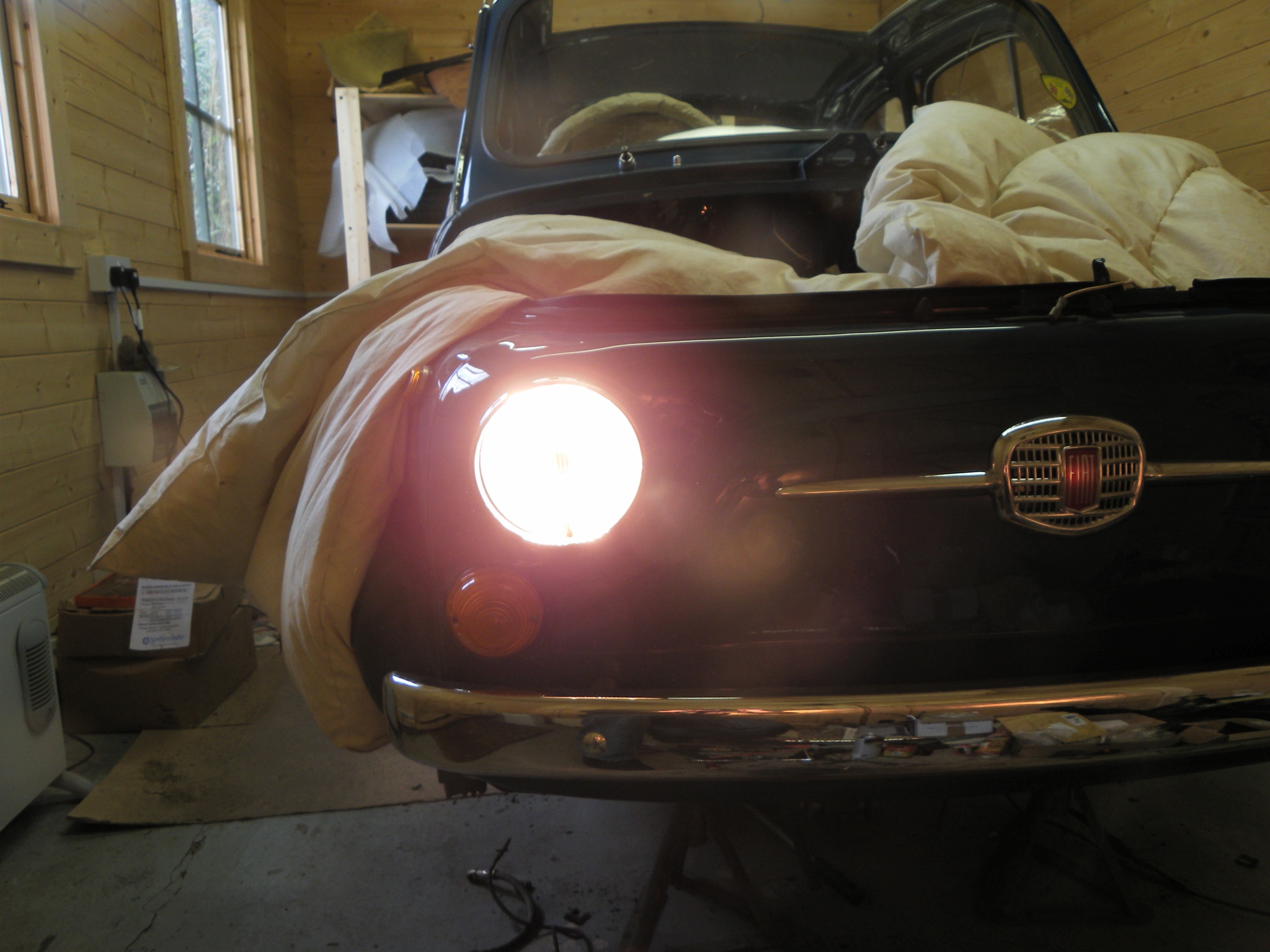

If you look at that post I did on page 1 of this thread, when comparing the different light output on the garage doors neither of them have a particularly good defined light patterns in fact they are both poor. They are original RHD headlights from the factory. I would imagine the design brief 50 years ago was "stick a bulb behind a bit of glass and if some light comes out job done".

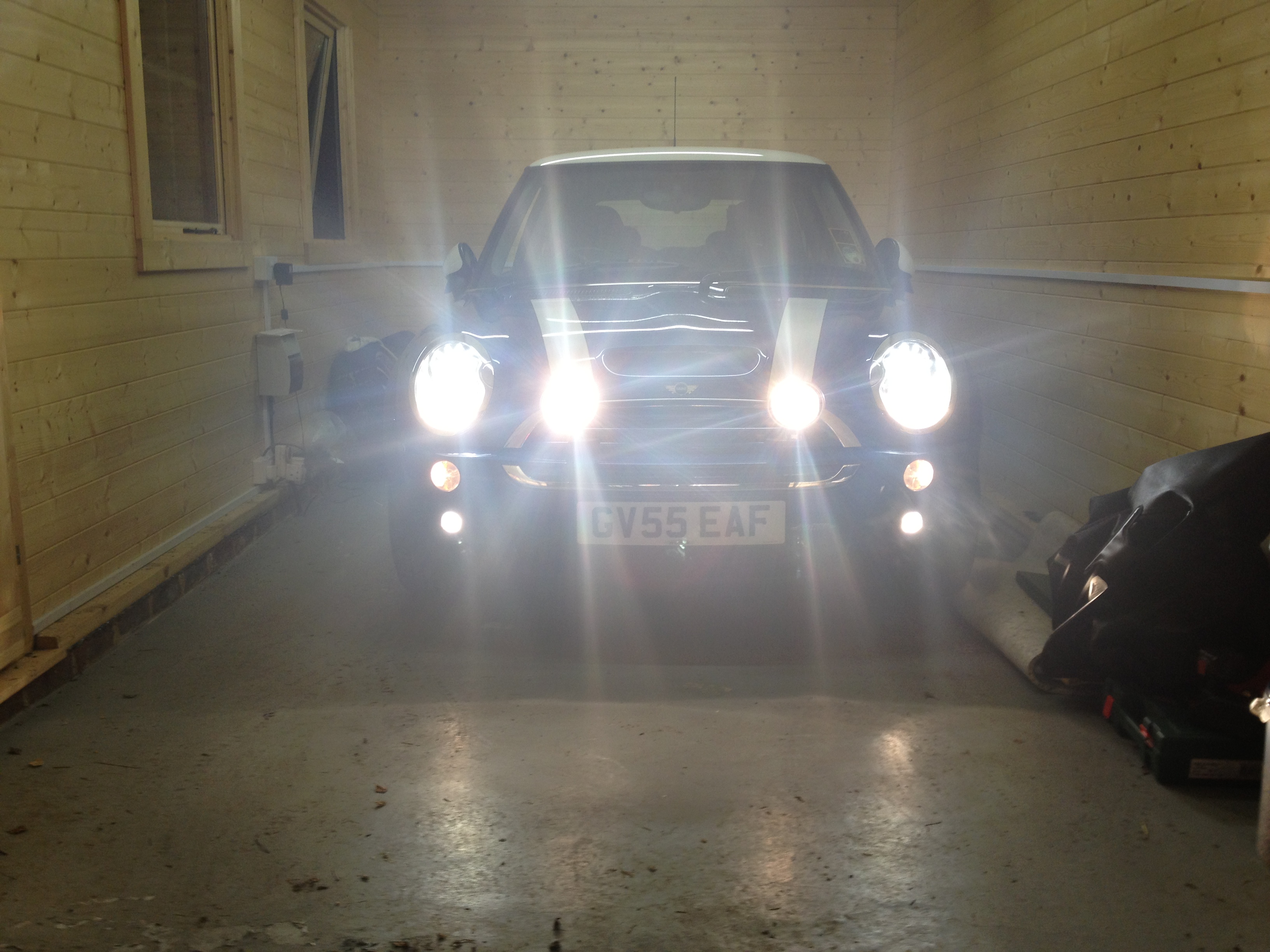

I have some Hella Halogen ones on my Mini which are superb and the ones I bought came with the relays as well, so were a breeze to fit. It's like driving during the daytime when they are on with the main beam.

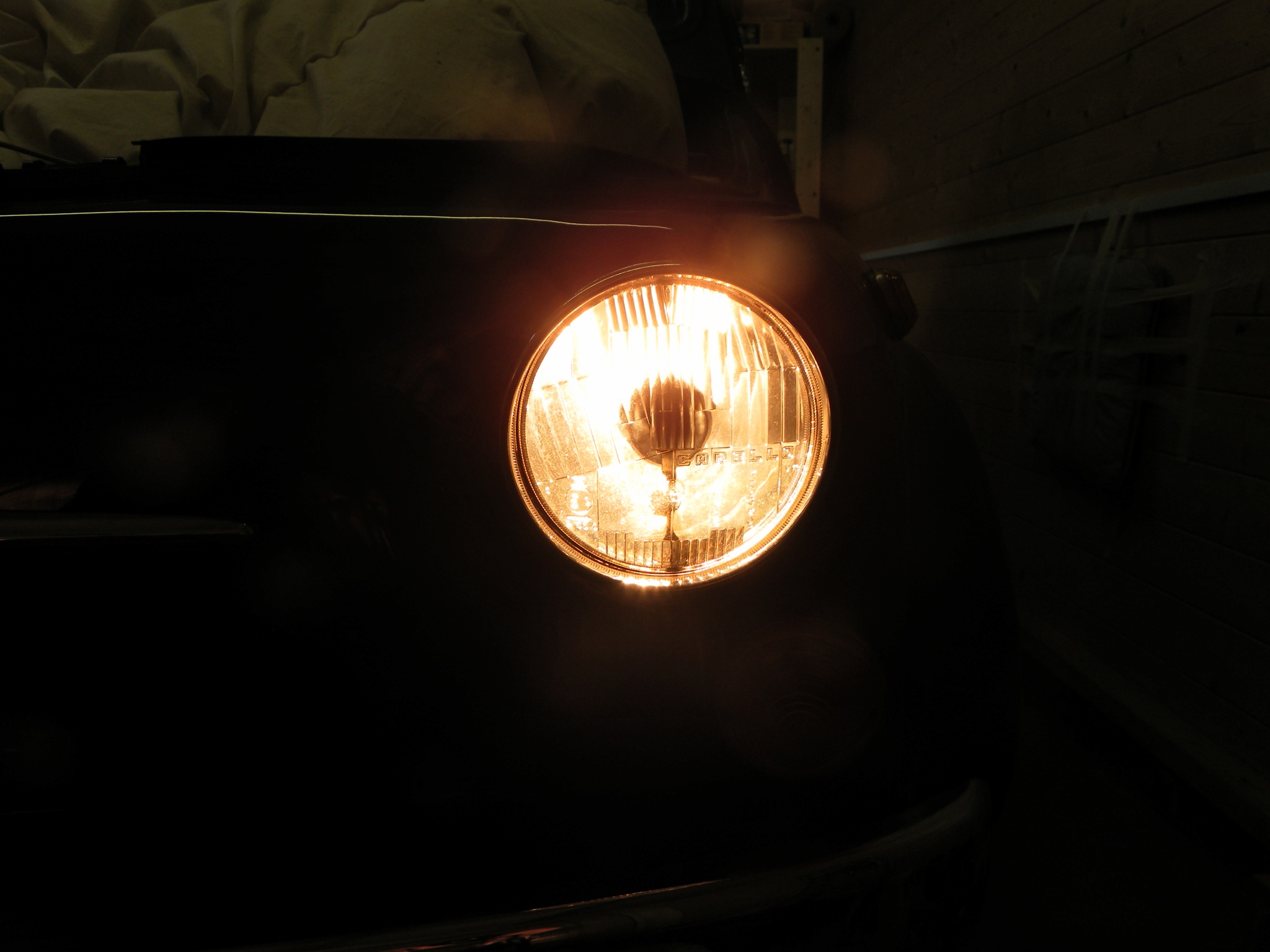

Oh I just found these pictures, they were taken the same day as the garage door picture. I will leave you to work out which is which?

That's what mine are Hella 500 with plain glass, mine have a chromed plastic back to them. Considering the car has Xenons on as well you can see how bright they are in the picture below.
