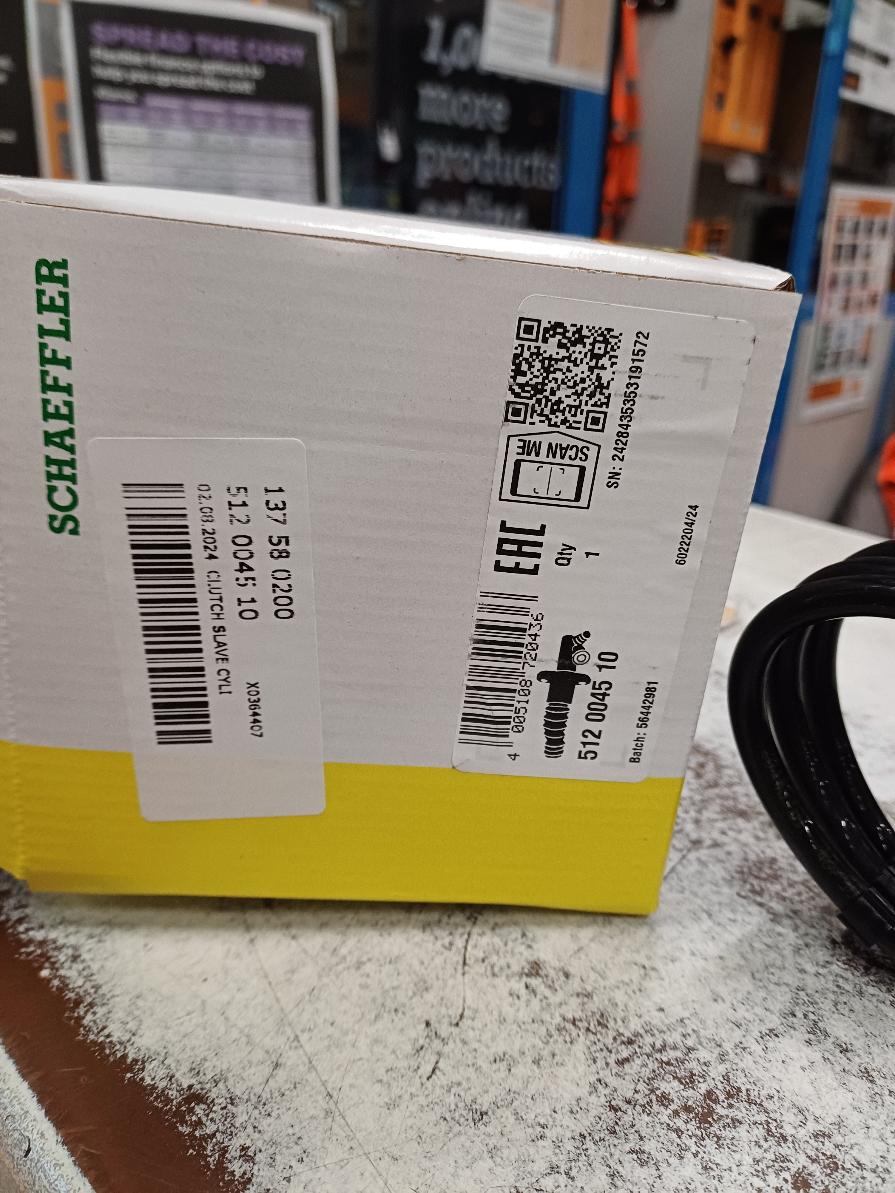

Both those numbers seem to be LUK's own product codes.
They appear to be the same part, I think either one will be fine.
Some manufacturers seem to prefer their own numbers in place of the OEM part number. For reasons. I don't know why they'd need two. Presumably some manufacturing change.
The FIAT part number is 55183387
oh gawd, your reply came just as I was getting a verification code for checkout, and now I'm wondering if it was the universe trying to stop me. Well. I'm doing it anyway. I will see what the box says, and maybe post a pic before I operate on bubbles.
Thankyou.
I think it's cool. 137580200 seems to be a part number for this item when it's made by Schaeffler, who I think is a Luk subsidiary.
Schaeffler lists about 5 different numbers for 55183387.. so there's probably someone there who has a fetish for re-categorizing the inventory every so often. 😅
Ralf S.

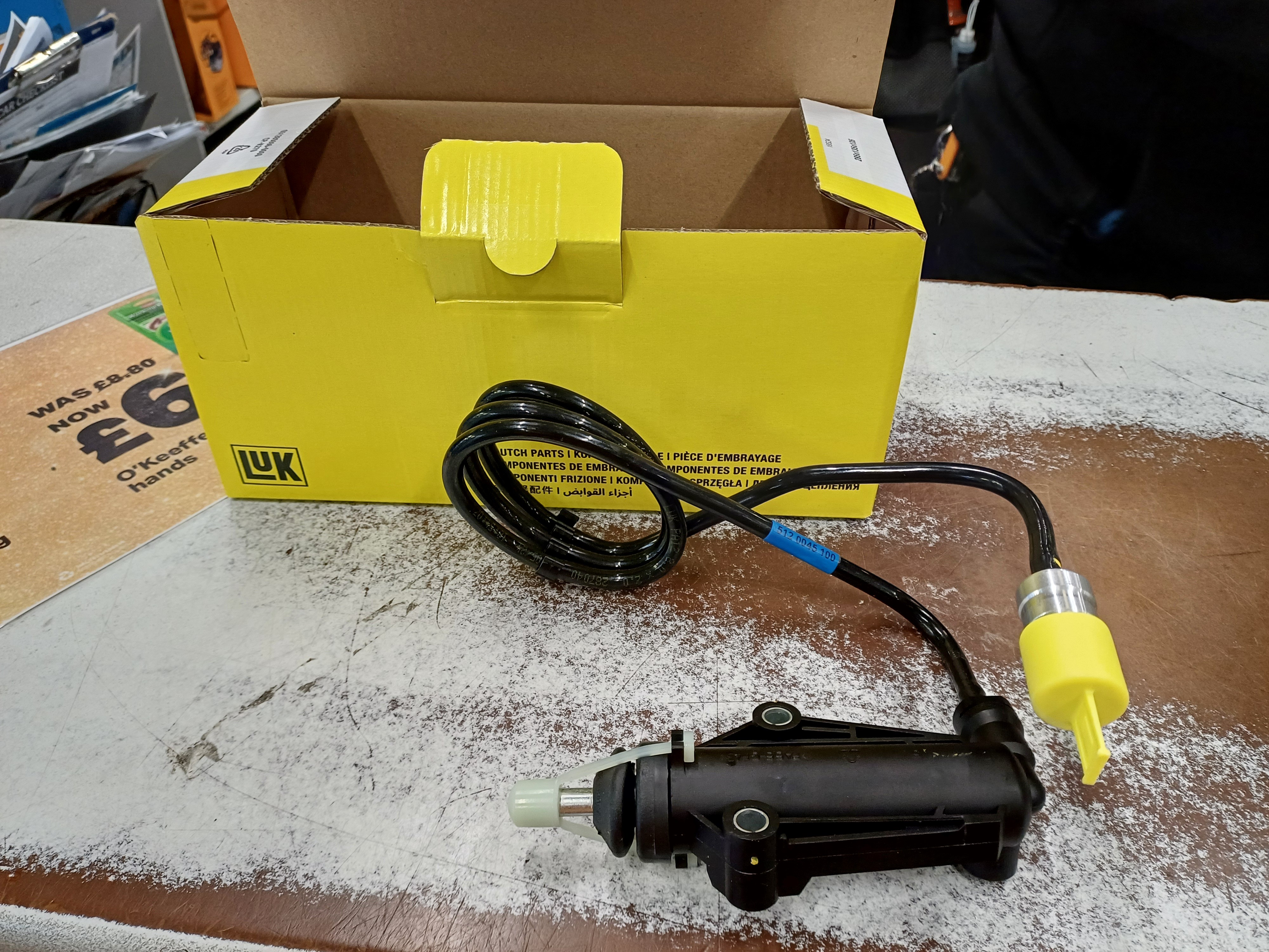

So cool story, just got back from Halfords. Left the slave cylinder and got a refund, as even tho it matches, someone had clearly had it before, and returned it. The hard pipe bit that I'm meant to take off was all scratched and gouged down, and there was gunk over it, and on the outside, where the pistony bit is. He said it comes from eurocar parts, not Halfords.
I feel like it's the universe saying noooooo. Either don't do it, don't do it atm, or it's not what's wrong. I WILL reorder one, but I'm gonna have a look first, and grease the moving pistony bit, and see what happens. Also see how badly it is corroded or whatever. Someone mentioned silicone spray, I forgot it at Halfords, but I think dad had some on his shelf of mystery in the garage.
So atleast we know it is the right part.
