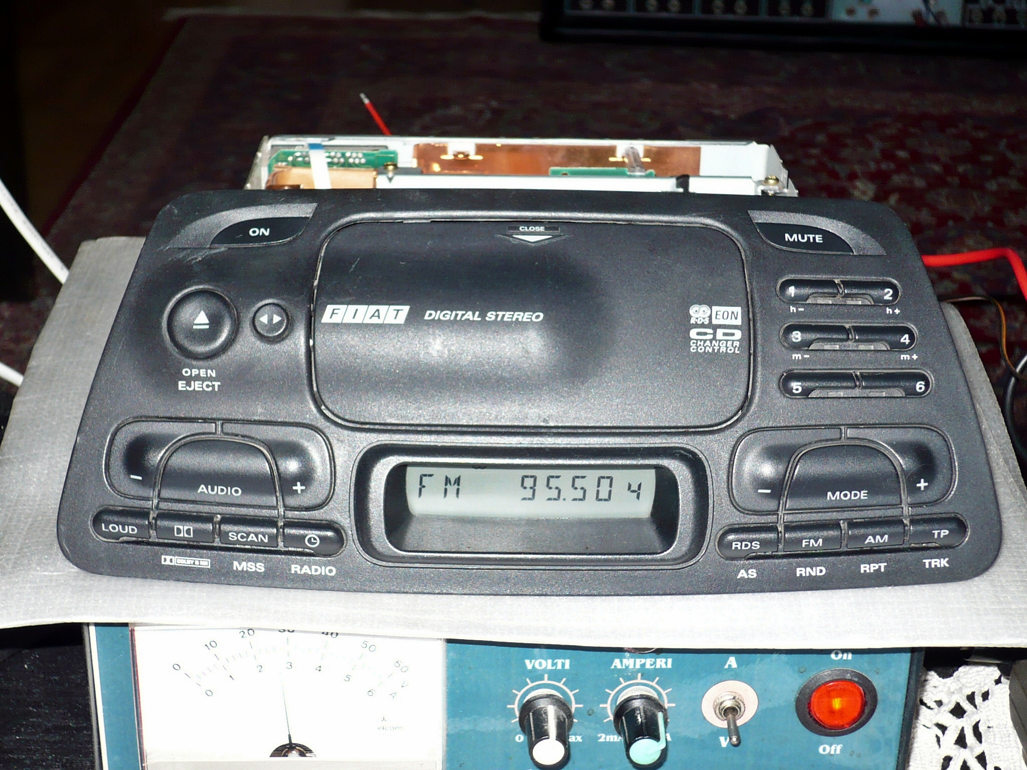

Grundig AD 182H - Problem?!
Hello all!
Give the people that help to repair?
When i press the eject (open) button on the radio Grundig AD 182H (see picture dawn), the cover can not be raised in order to remove the cassette?:confused::(
I'd say what's the problem? :worship::idea:
Thanks

Its a very common problem, press the button and lift it from the top to open it.
You can get repair kits with springs and a spring bar to repair it.

Somehow, i solved the problem, since they were disconected springs?!
