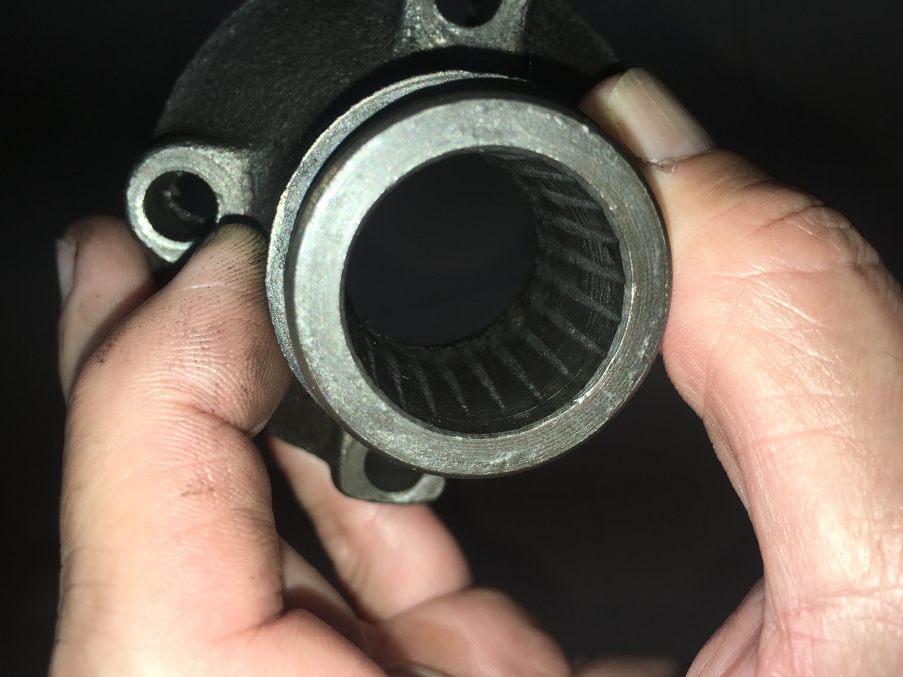

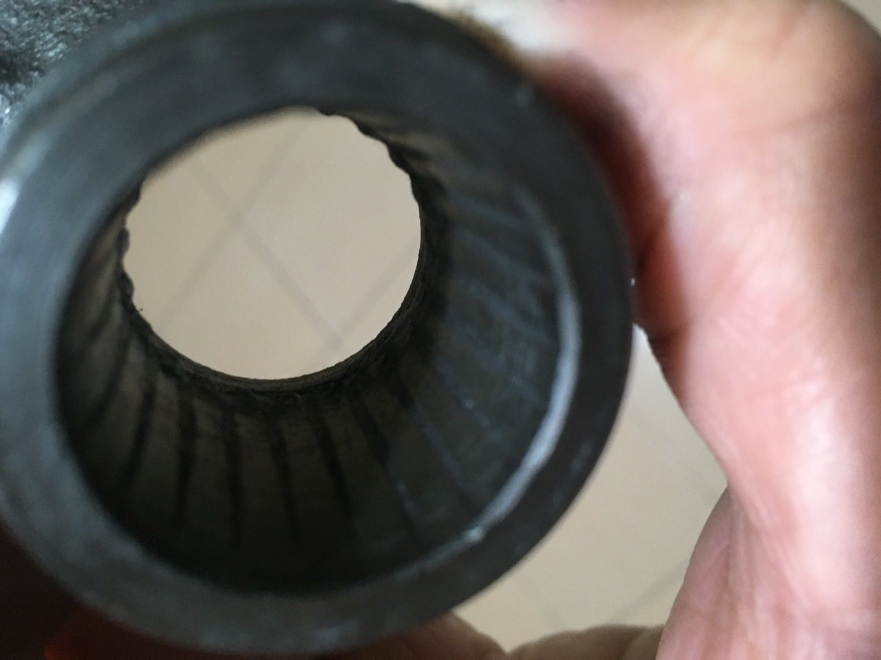

I pulled the left coupling with minimal issues. The splines are almost worn flat. See the pics. It makes me wonder how long I’ve been driving with this condition, ready to break at the most inopportune time. At least this time it happened one mile from my house - thankfully.
I’m off to the autoricambi for a replacement tomorrow or Saturday morning. I'll let everyone know know it turns out.
Thanks to everyone who has posted, helping me with this issue. You’ve all been a huge help.

That is exactly how mine was, almost no splines left in the coupling. I would suggest that, for what they cost, you replace them both. If the 'good' one looks OK, keep it and you will have it available for an emergency. I would also recommend that you replace the little rubber boots, the end-of-shaft springs and the 'C' clips. Carefully clean the splines on both shafts, and then liberally lubricate both the shaft splines and the coupling splines with a good quality Lithium grease (the sort of grease that you would use in C/V couplings)--NOT 'copper-slip'.

Replaced the broken flange yesterday without too much effort. The new piece was a bit of a tight fit but it all went together without too many four letter words.
A test drive proved problem was fixed!!!
Thanks again for all the help troubleshooting this problem.
Richenrygarcia, did you replace just the damaged drive-flange or, as I suggested, both of them? The fact that it was "a bit if a tight fit" I wouldn't worry about, shows that there is not much play between the splines on the coupling and those on the drive-shaft. Did you remember to liberally lubricate the splines with Lithium grease?. If you haven't replaced the 'good' coupling, it might be wise do it in a quiet moment, then you know that they are both OK. Well done for sorting it all out.

Hobbler, I only replaced the broken coupling due to time. I will replace the opposite side when time permits.
At this point, after reading multiple stories on the Italian Fiat 500 forums about failed splines leaving drivers stranded, I'd consider it preventative maintenance to check (or replace) them periodically. I'll also add a pair of these flanges to my parts box when I move back to the US.
