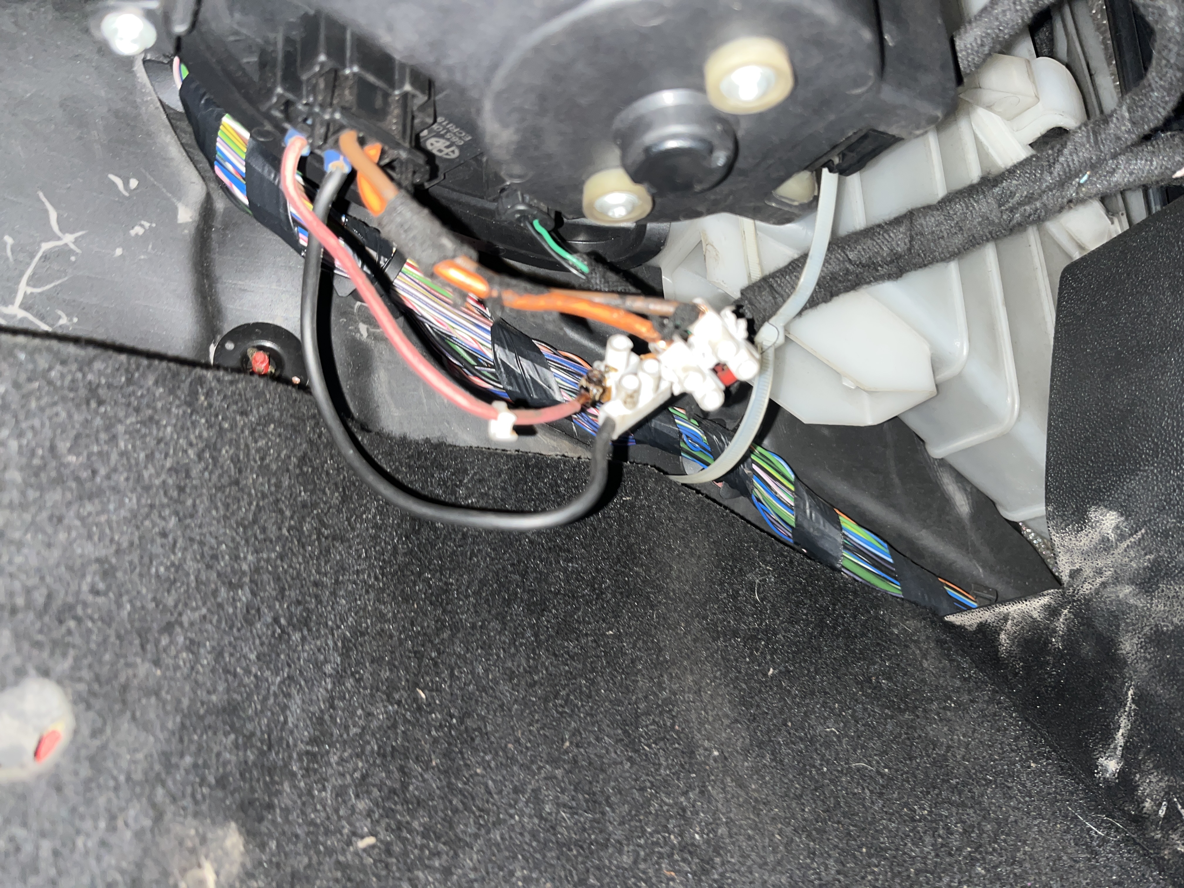

I did notice a smell of burning wire so I checked and seen this

Did you fix this? I'm having a similar issue with the exact same car. GP T-jet with digital climate control. Heater was coming and going. If I reached down and wiggled the wires a bit, it would work for a while. Since I could do that, it must be a bad/burned connection/wiring. Now the climate control panel has quit altogether - lights out. Probably burned a fuse or something.
