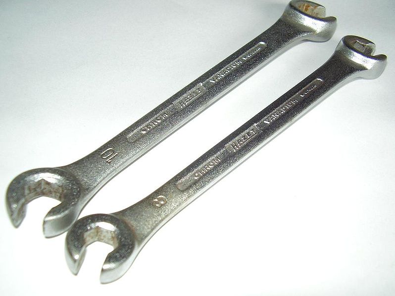

Hi,
I take it you mean a hex (6 point) ring spanner? The 12 point (double hex) style is much more common. The reason is that with a hexagonal shape nut or bolt only the points take the load so there is no difference between a 6 and 12 point spanner. In practice a well made, correct size, spanner of either type is OK. There are special spanner designs e.g SnapOn FlankDrive that apply force to the flats rather than the points which are good for tight fastners. There are also special spanners for pipe fittings (flare nuts) e.g. https://www.machinemart.co.uk/p/7-piece-flare-spanner-set/ that are ok for bleed nipples.
Robert G8RPI.
THIS is the tool you need ;-)
Hi,
Robert G8RPI.

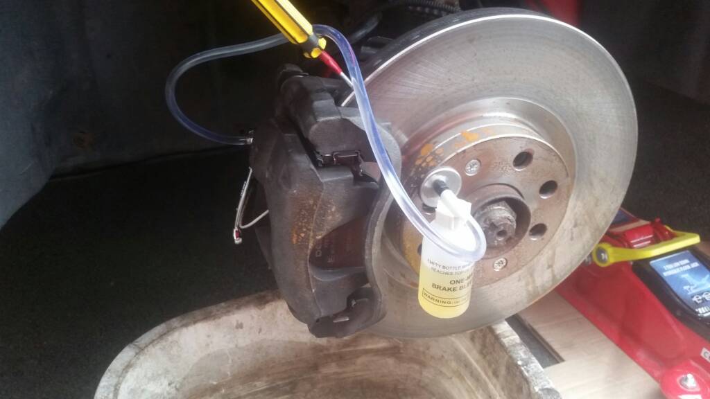

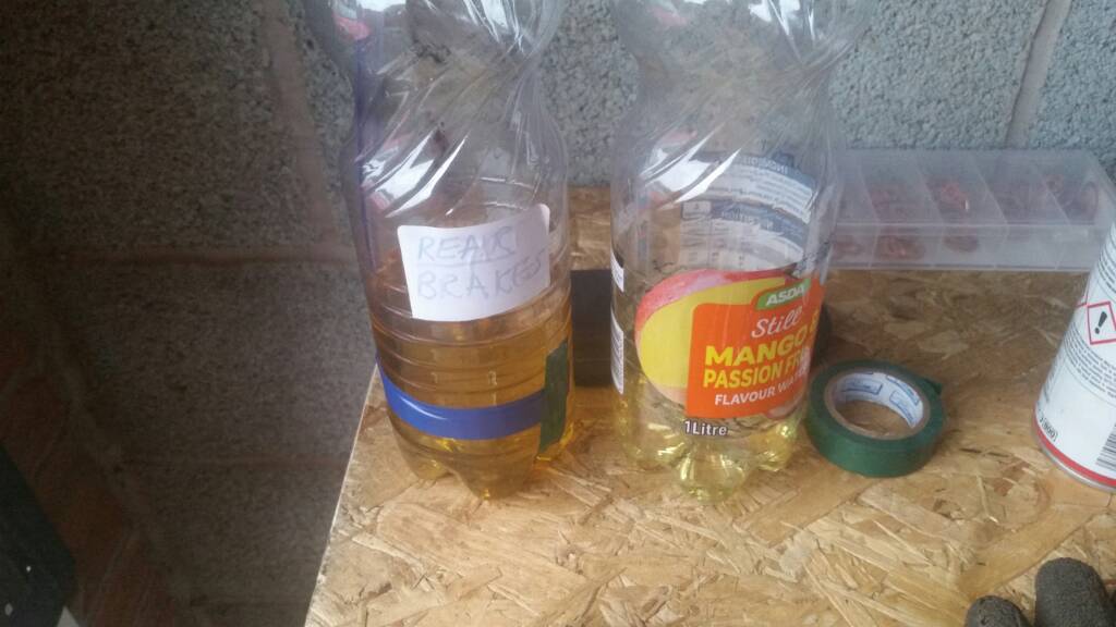

Hey guys just putting.up some.pictures.of the work on bleeding.my.brakes. ( really annoying that different bleed sizes on rear.and.front so as you can see the old darker fluid and. The new fresh fluid. Once again any noob who want any help let me.know as it is pretty fresh in mind.
Thanks to all who helped me out
