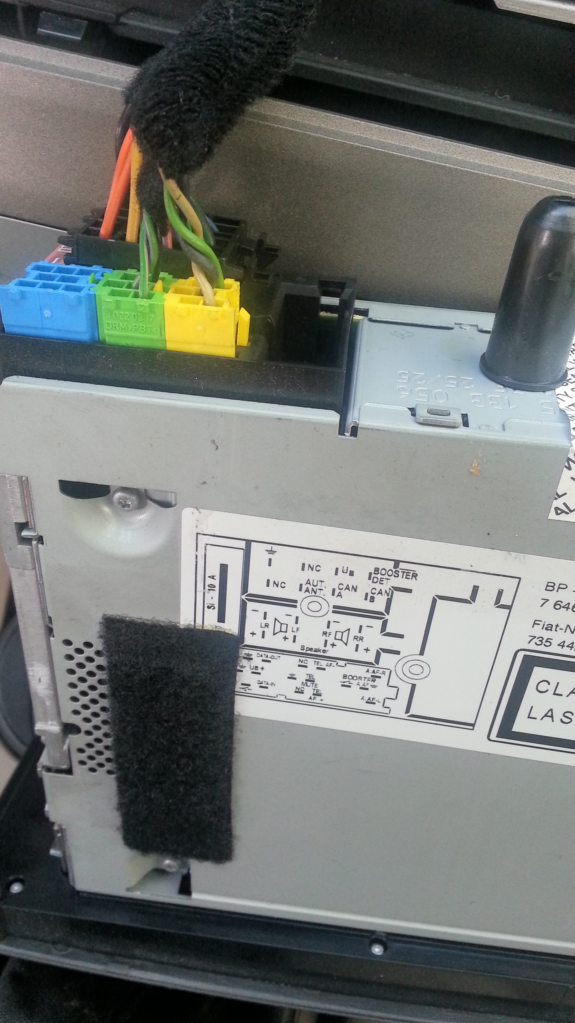

i have bought the connection advised for punto grande sport 07 but when i took the stereo out there are already three sockets taking up all the available spaces? what do i do now as i have no clue about this sort of thing?
did you get a solution to this cos i have bought the lead and came up with the same problem?

if you have blue & me and or phone connectivity the only plug you can use is the blue one,which is the one that is used for a cd changer.
The good thing about that is buy a cd changer interface, which is a box of tricks that fools the h/u into thinking there is a cd changer connected.
They let you use your ipod,sd card slot, usb port, and 3.5mm socket.
thay a re made by YATOUR and range in price around £60.
plug and play unit no dealer install

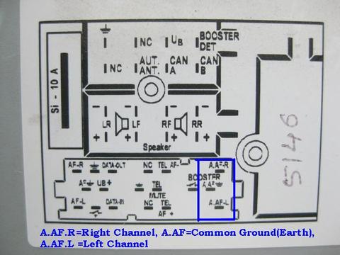

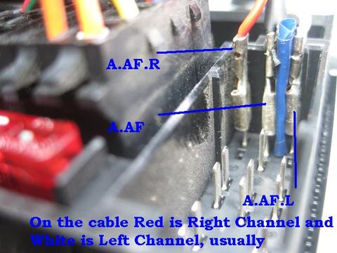

Luigi,
there are no wires coming out. just the pins. pls see the pic below. ( the wires you see in the pics are from a cheapo aux hack one of my friends did.) I am told the pins marked a.f-l and a.f-r are line outs (pre amp). I believe these are for the sub woofer which is not fitted in our market. Will these be disabled for our market?

Has anybody tried to go into the head unit and tried to take a pre out from the board? If so, what happened?
Luke, In the photo I posted earlier, the pins outlined with a blue rectangle is where the aux in goes, did you plug it in there? Someone I know did a hack using simple connectors on the end of a stereo jack (instead of the iso connector) it worked for him....
