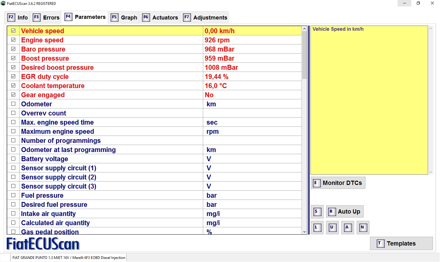

Here you go Cmos...
Regards, Bernie

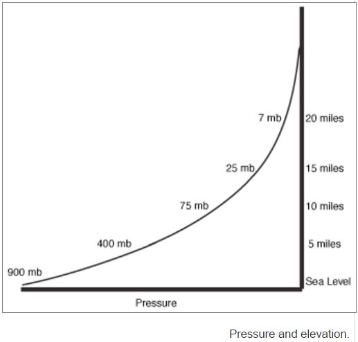

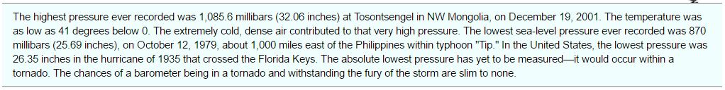

Hi Guys, just FYI ...
The "normal" extremes are about 3% of 1atm: 30"Hg (1atm) normal mini: 29"Hg, normal maxi: 31"Hg or 970 / 1030 mBar (all aproximatively !!)
Regards, Bernie

Ok. Let's start again from the beginning and try to clear some things out.
Original problem is P2227 error (MIL on) and low performance (low boost)
P2227 = Atmospheric Pressure Sensor.
Upon further research from Stemh we found that:
Atmospheric Pressure Sensor: 940mbar
MAP: 830mbar
Boost: 840mbar
These are the pressures with the engine off.
All of them should be the same. (same= atm pressure)
Now we have 3 problems.
1. Atm sensor reading is LOW (it should be near 1000mbar since he is not living on mountains at very high altitudes)
2. MAP reading VERY LOW
3. Boost is reading VERY LOW
So both MAP and Boost sensors are -100mbar of Atm sensor. (940 vs ±840 - coincidence?)
Then he tried resetting self adaptive parameters (re-learn procedure)
Atm pressure is now 1020mbar (that's a normal value)
MAP and Boost are still ±840mbar (?)
Could this be what's causing the fault code? The description is Barometric pressure out of range. Would 940mbar be considered out of range when atmospheric pressure is just over 1000?
940mbar is not considered an out of range value. The car is designed to work on such low pressures (high altitude)
What makes tha ECU thinks that this is an out of range value is that it reads TWO sensors with a lower pressure (map/boost= 840mbar) and ONE sensor with a much higher value (atm=940)
So what makes these two sensors reading wrong pressures?
I though that there must be a tuning box in there tricking the sensors, but there isn't such thing (as Stemh said)
