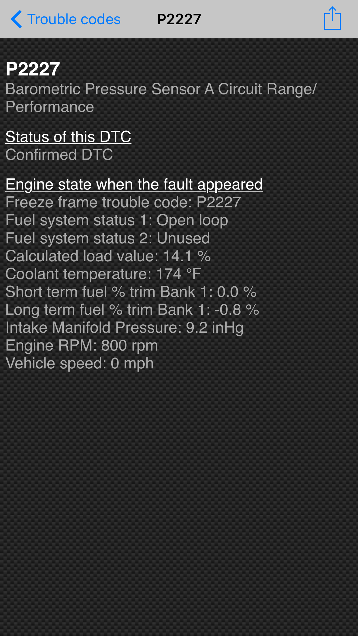

Technical Grande Punto 1.4 T Jet problems! p2227 fault code

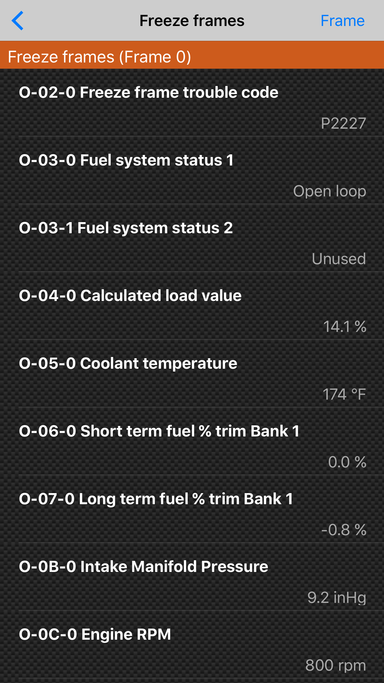

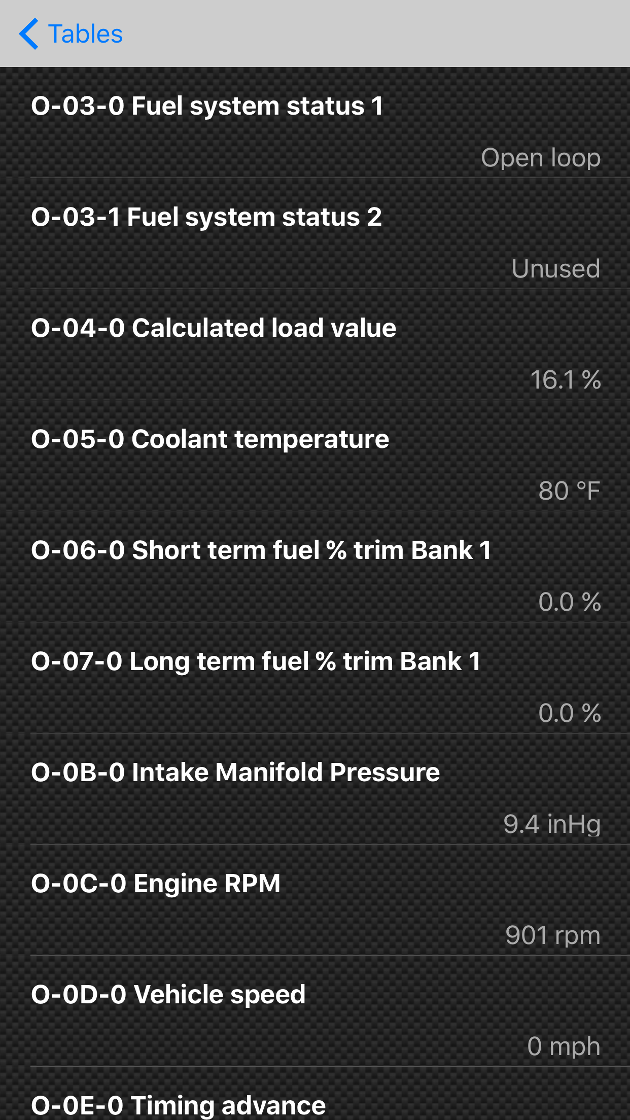

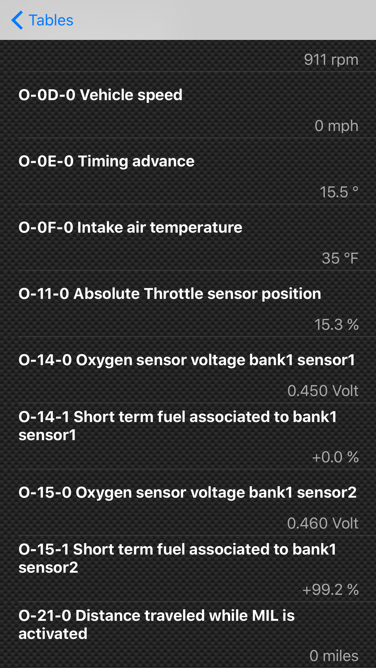

I have a feeling my code reader isn't showing everything you need. I have only been able to screenshot it from cold startup at idle. I will run the car up to temp tomorrow.

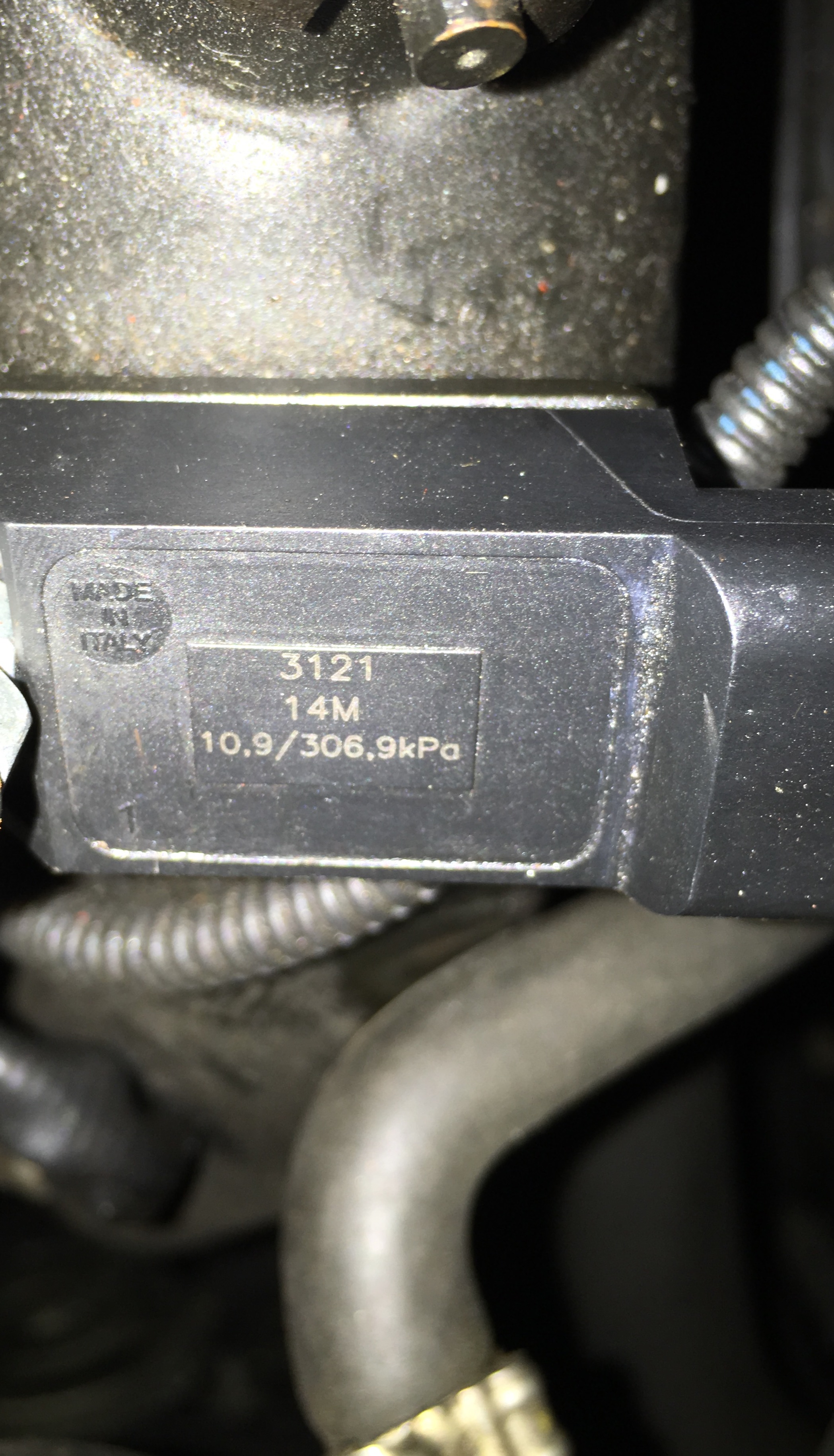

These are all the screenshots I could get today, don't know if they tell anything or not. Plus a pic of the unbranded sensor!
Thanks
Yes it's missing barometric pressure and boost pressure, MES is a must then...
btw wow this sensor is from Italy :p
That's what I thought, no stickers or branding on it at all.

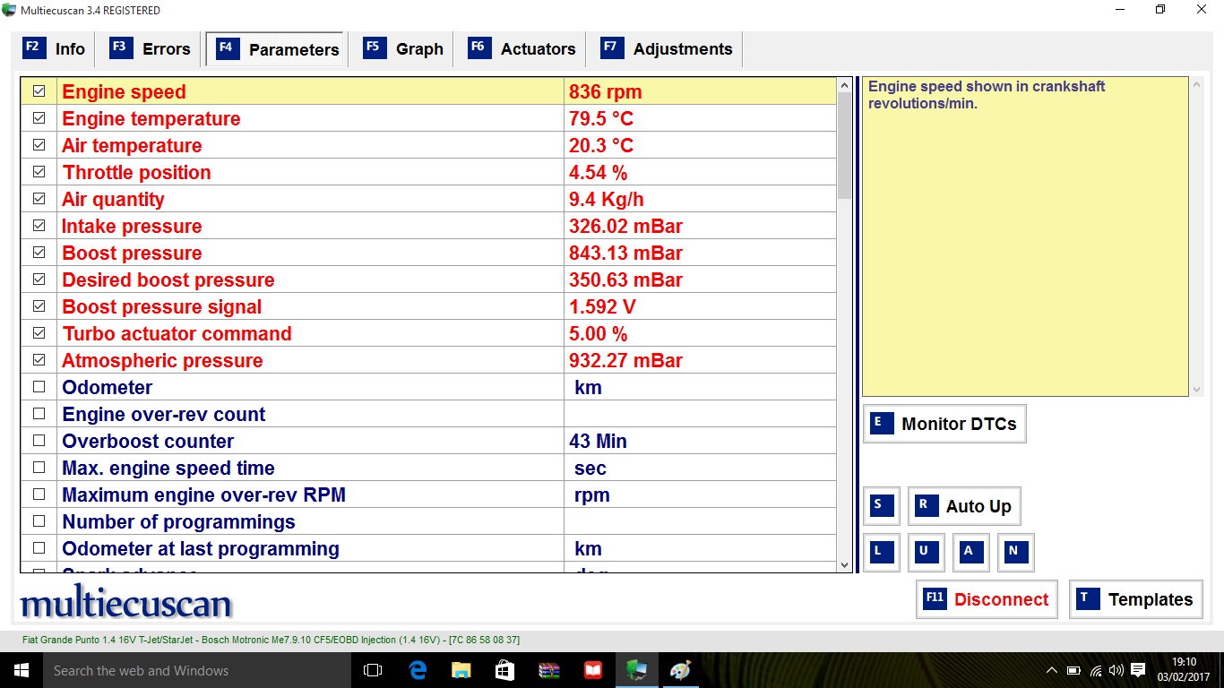

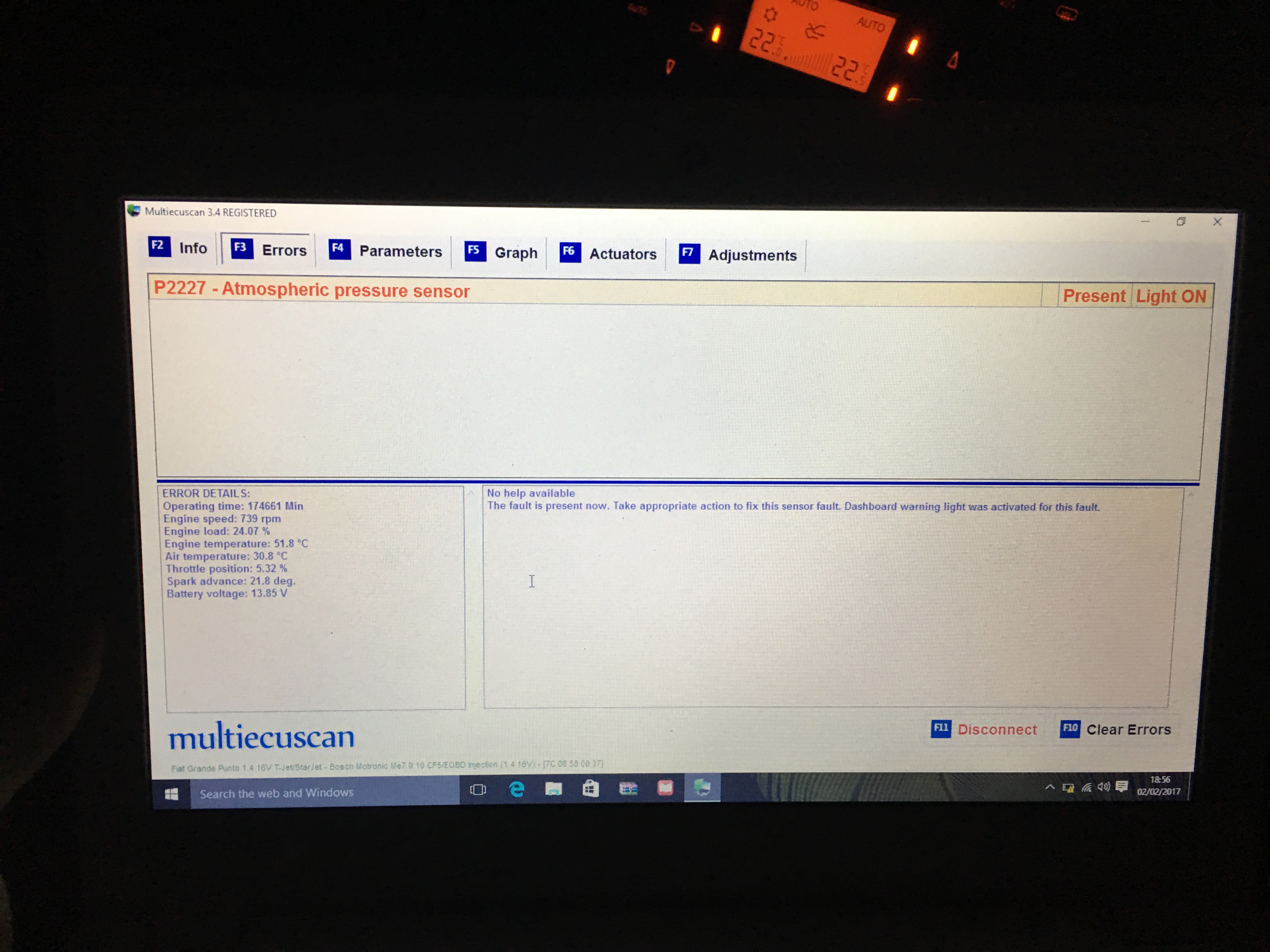

Hi, managed to get a copy of MES.
Took these screen shots today, hope I've got the ones needed to diagnose my problem!
Thanks for any help.

Fault code screen shot

Am I right in thinking the boost pressure shouldn't be showing so high on idle? Around 12psi?
When I drove the car, and put my foot down, the boost peaked at about 25/26psi, but boost gauge only shows 13-15psi.
Is this a faulty sensor?
Thanks
I'd put my hand in the stove !
Just checked MES curves I took a while ago on my 1.3MJT, at idling the turbo pressure is 980mBar ('bout 12,2 psi) and at full throttle is goes to 2.239 mBar (28 psi).
Seems like you have a bad MAP sensor...

Before I go replacing the wrong sensor again, is the map sensor the one on the inlet manifold at the back, or the one on the plastic inlet pipe near the battery?

Oooops, sorry, didn't read the actual boost values on your screen shot: they seem absolutely normal, so I pull my hand off the stove !!
I digged a bit in my garage and found a brand new MAP sensor in its box, it gets the same pattern of writings as yours ; brand is EPS, made in Italy (since 1946 !) so you probably don't own a crappy chinese sensor ...
Ok. 26psi overboost is way to high of course.
Which sensor was that ? MAP or Boost sensor? (they should have the same value on full throttle)

The figure was on the "Boost pressure" parameter. I will take a screenshot of the live graph on a drive later so you can see what I mean. It seemed way too high all the time to me, I didn't think it would show 840mbar at idle but I could be wrong!

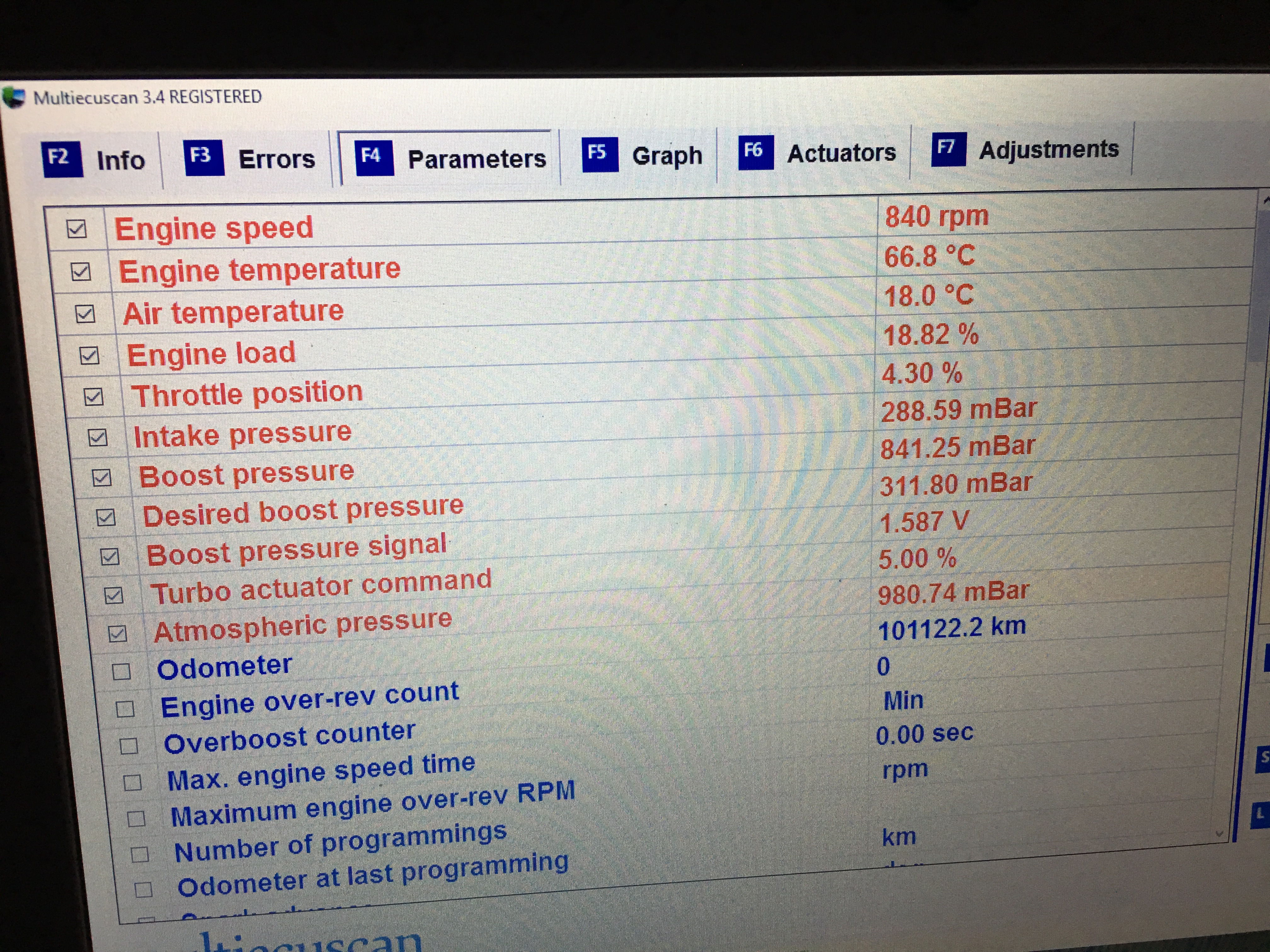

Attached are the screenshots,
1st Screenshot- Engine Off Cold
2nd Screenshot- Engine On Cold
3rd Screenshot - Engine Off Warm
4th Screenshot - Engine On Warm.
Hope this has everything you need!
Thanks

I have to tell you that these graphs confused me...a LOT. :confused:
MAP sensor and boost sensor have (almost) the same pressure but not the same as atmospheric pressure.
Now, this is weird and not normal. MAP and Atmospheric should be exactly the same with the engine off. (let's forget about boost sensor for a now)
Is the new MAP sensor the same part as the old/factory one?
Can you get a picture of the MAP sensor? (maybe one more pic of the old sensor too)
The only normal value in your graphs is the atmospheric pressure. (where do you live btw? what's the altitude there?)
I'm thinking that both sensors (map/boost) are wrong parts for this engine.
When I got the car, I was told the map/boost sensors had been upgraded to "abarth" items due to them upping the power with different turbo/intercooler/injectors. I replaced the map sensor with the same part number as what was already in so I'm not sure if it is the right one.
I've attached pictures of both the sensors that are fitted on the car.

That's the abarth map correct.
