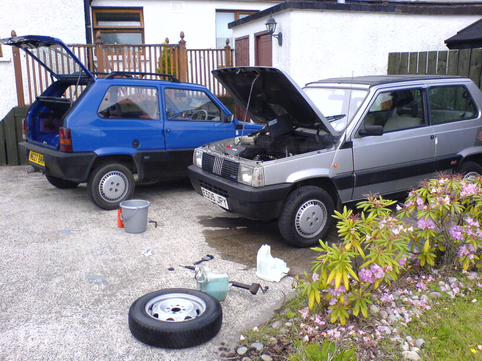

Oh, and to top it all off, there was nothing wrong with the motors in the tank.... It was the wiring (I've no mulitmeter). When I swapped the wires between the pumps it worked but when I swapped them back it didn't. The pulling of the wire was cutting the power. It just needed a longer bit of wire..... :bang:

but the windscreen washers have just packed in....
Now, (I'm going to go find the manual again but just incase) can the motors be swapped or would it be easier to swap the whole tank/pump combo from the black CL.
Jim
The pumps unplug - it's difficult, but possible.
The washer pumps have a little mesh filter in them. Over time it becomes clogged with deposits from the water. If you washer makes a humming noise when you turn it on, but no water comes through, it probably only needs the filter cleaning. If you do need a pump let me know.
