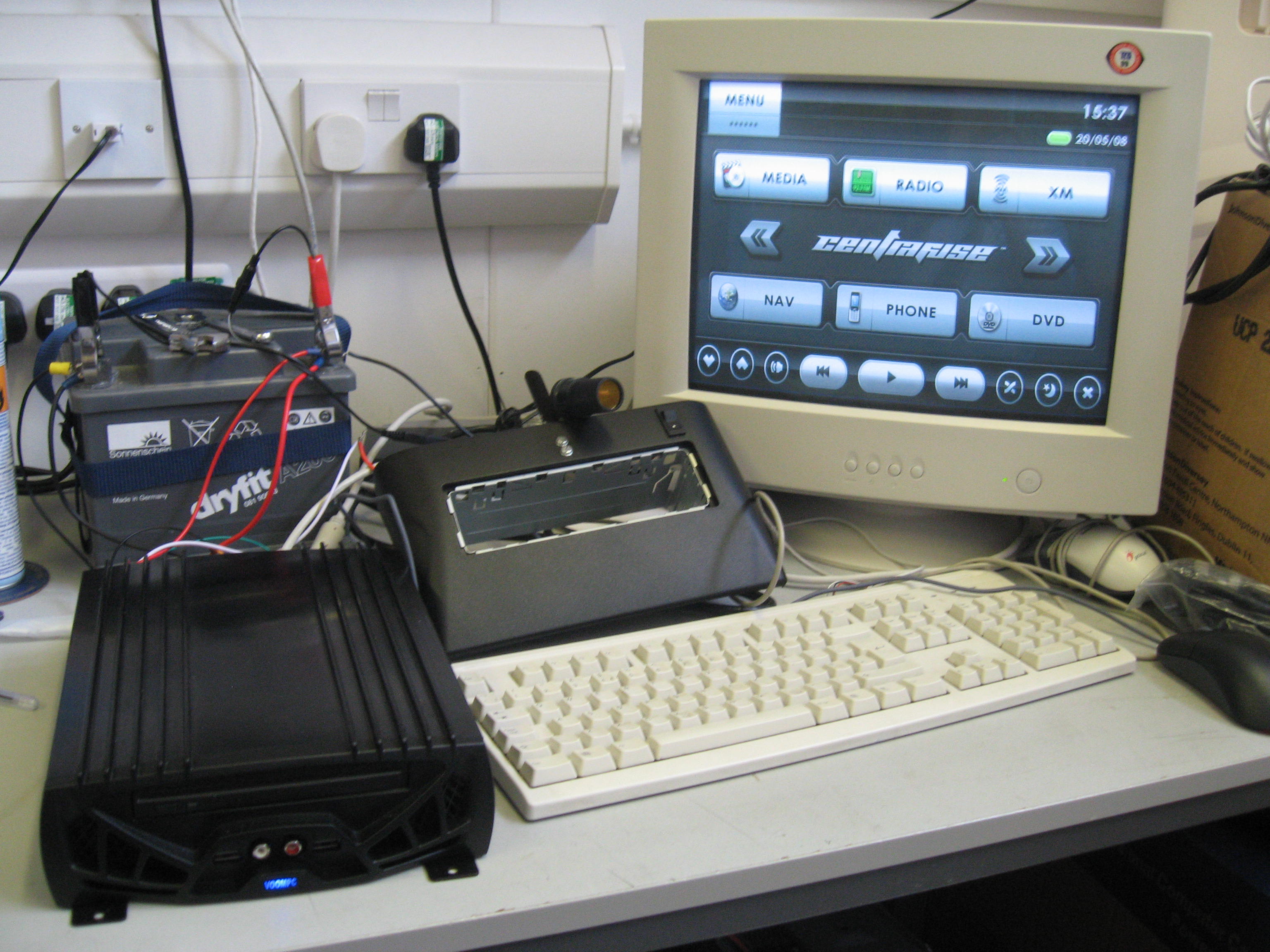

Just about configured Centrafuse with the pc, got a fairly quick boot up of about 12 to 18 seconds straight into centrafuse software. Below is a couple of pics of it setup outside of the car. I have already run the cables down the side of the car via the internal trims.
On the fascia i have added the mount for the screen, so i can still have my stereo installed along with the screen as well.
