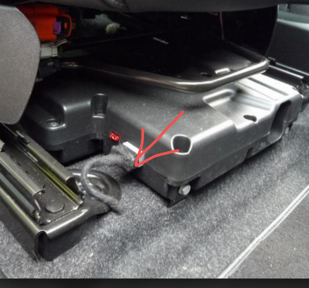

As a subwoofer was optional to the dynamic and above
The wiring is probably already in place under the driver's seat
There should be a connector hidden under the carpet and taped to the rail under the driver's seat, with a little flap in the carpet to pull it through
I have never played with this connector, I assume the wiring is complete and will only need a fuse adding, if you give me the wiring colours I can look it up
If the car an active base model it unlikely the wiring is complete

Okay sir, I had a look under the seats, nothing under the drivers, but definitely a lot going on under the left seat (in my case passenger seat) there's a harness sticking out through a cutout, those are definitely a thing Guage and some kinda round bracket with a rubber which I guess is a press button as the rubber denotes PRESS (no idea what that is, and also a BOSCH, unit to which the previous noted harness is connected but under the carpet,
My word, I am note confused than when I started this journey,
My Panda is a Trekking which is the budget spec 4x4, like you mentioned, it might not be included in my car's harness.

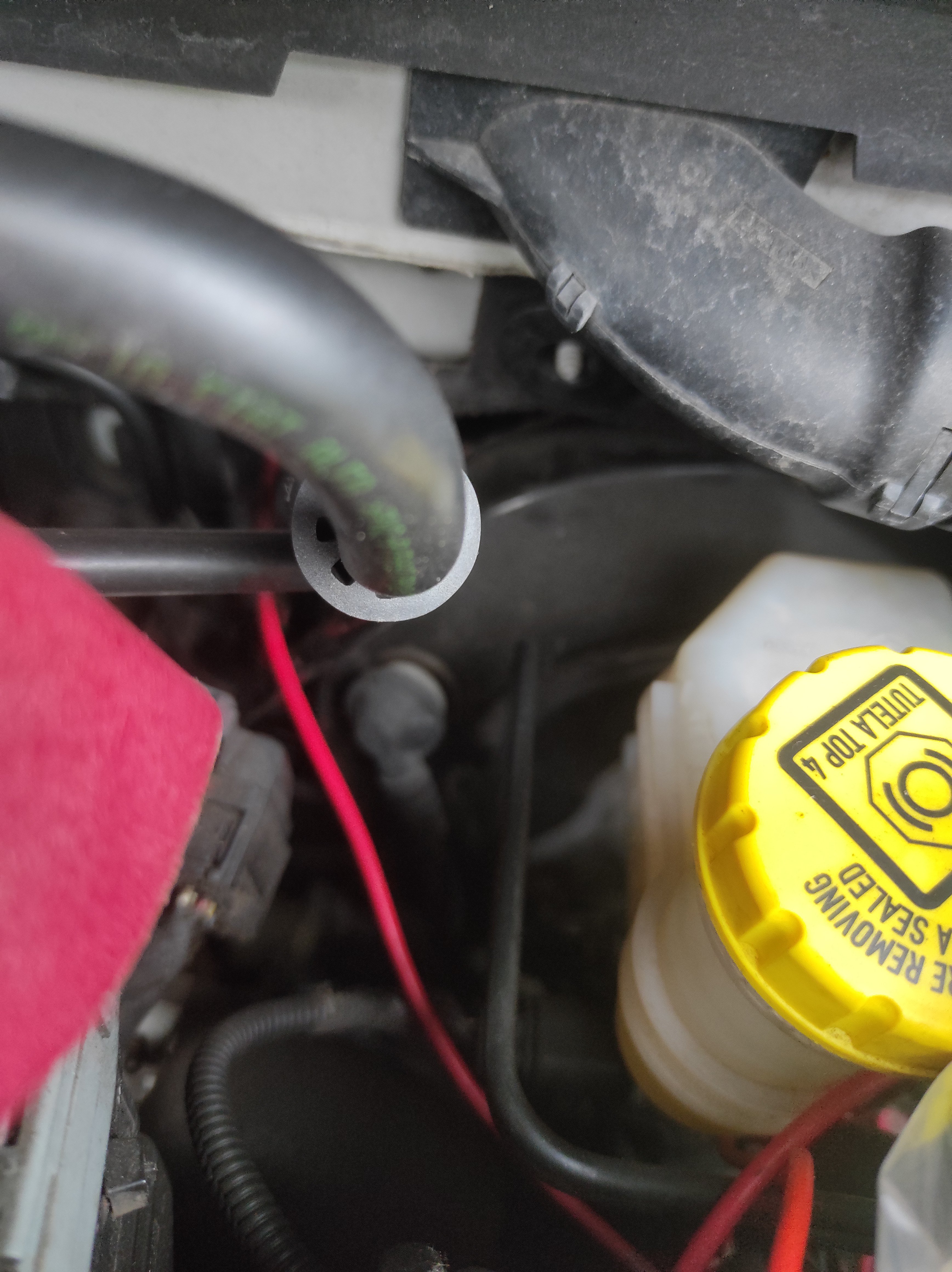

I am repeating myself, but behind the battery, above where on a LHD the pedals are is a rubber in a hole.
gr J
Thanks a bunch I had a look, behind my battery is the ABS unit, behind that break booster behind which is a carpet and I don't see a hole with a rubber grommet, I guess it might be obscured by the carpet on the RHD model, also worth mentioning is on the inside is a kinda foam I take it as sound deadening,
Regards
D
Behind the brakebooster upper left "corner".
Just above accelleratorpedal (LHD)
Thanks, will have a look again tomorrow, my car definitely have carpet padding outside in engine compartment, I will pull it back tho
