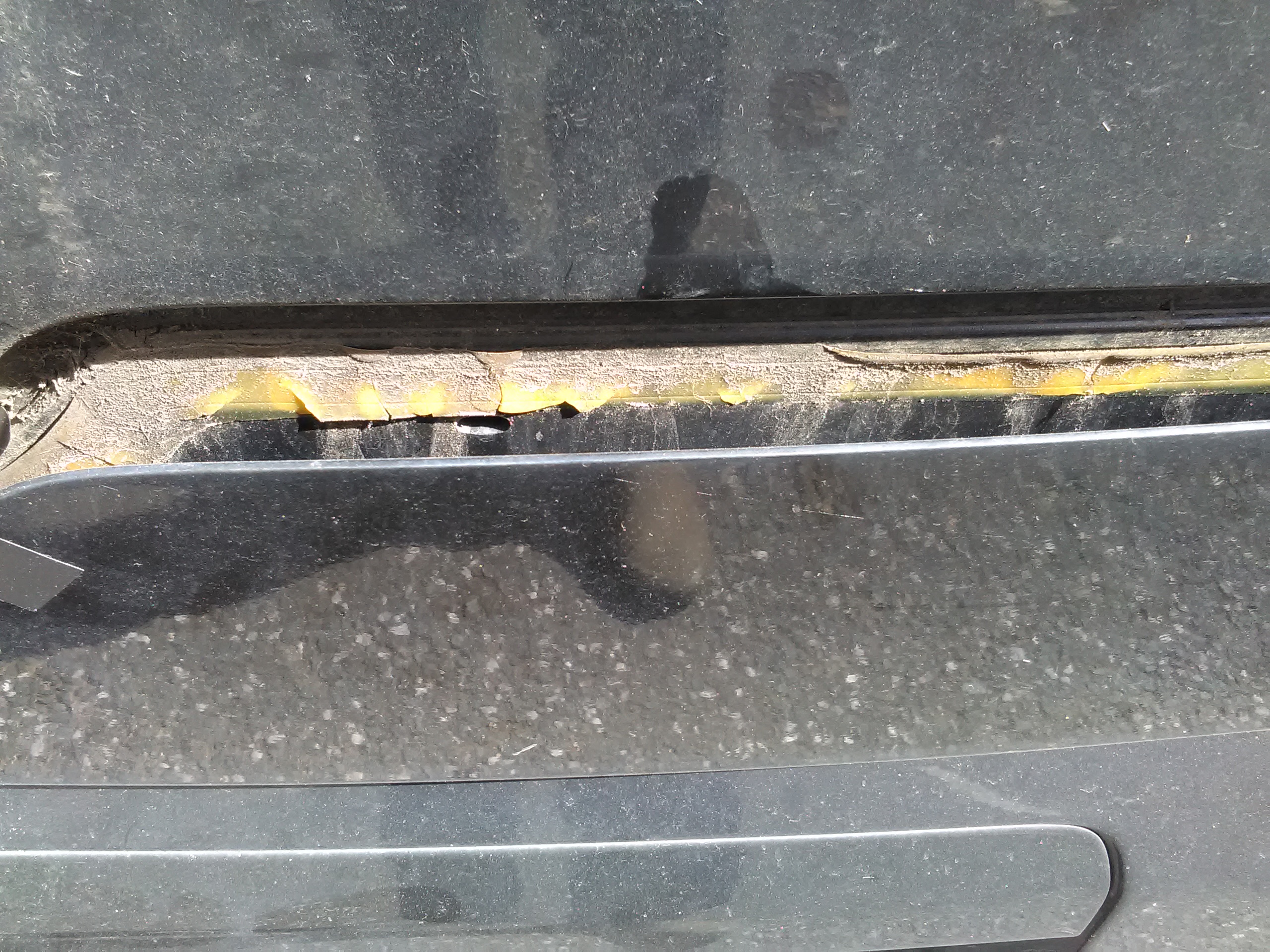

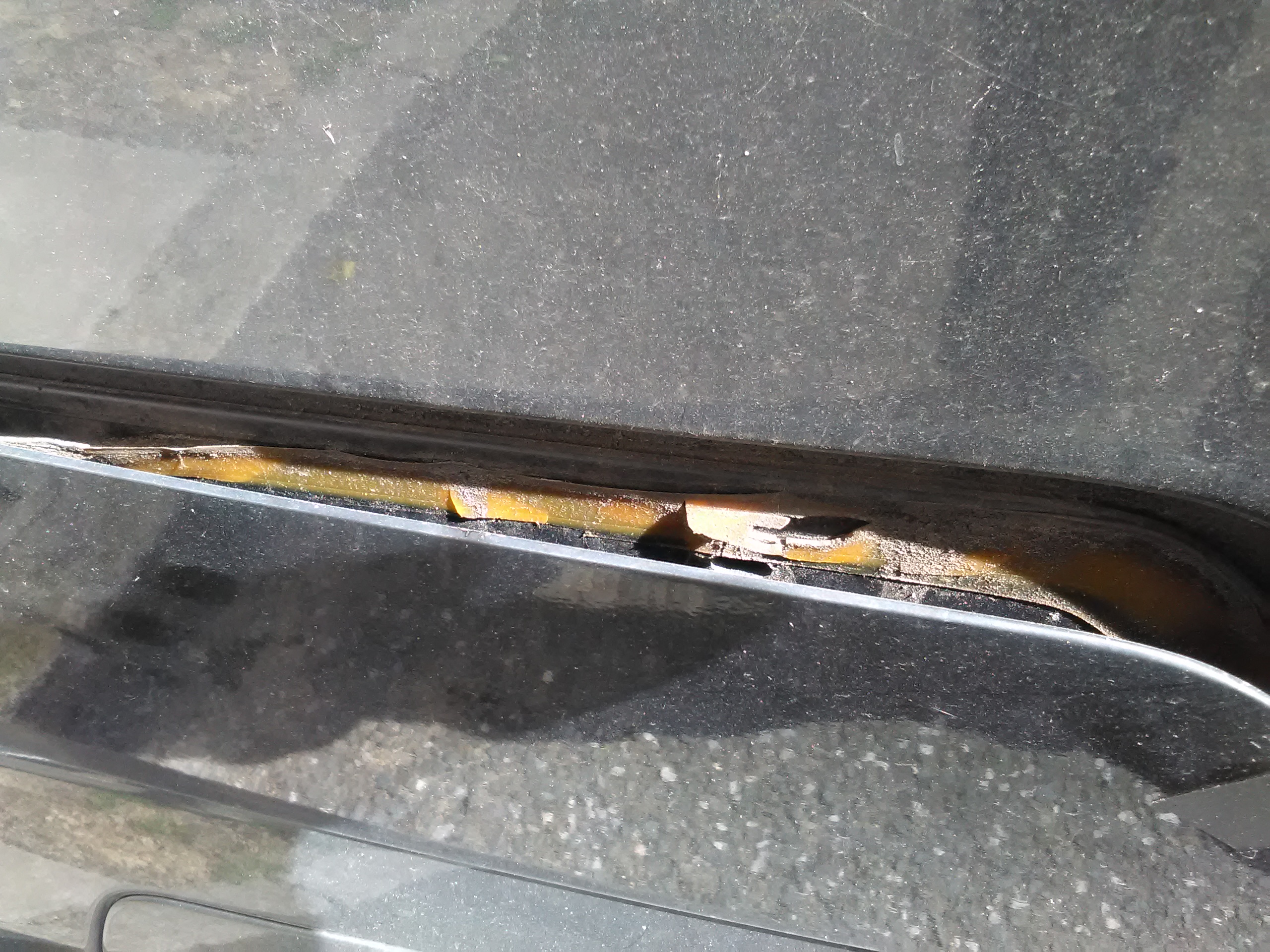

Hello,
The trim on the rear door of my Qubo has become unstuck.
What glue should I use to fix it? Pl. see photos - looks like a yellow adhesive.
Thx
Some good strong double sided tape can work. I used some gorilla glue tape that is holding mine on, however I didn't use enough and the areas I didn't tape are coming off a bit. The bits that are tapes are holding it on though so should work, just make sure to cover the whole piece.
Used tape as a temporary fix.
Trim fell off, luckily outside house. Will get Tigerseal and do a proper fix when I can :D.
