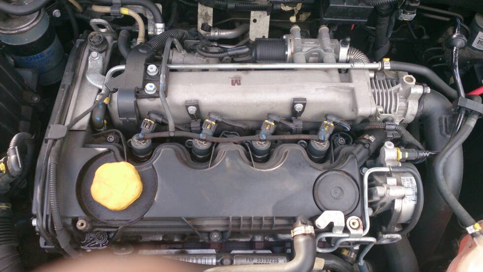

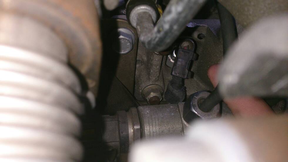

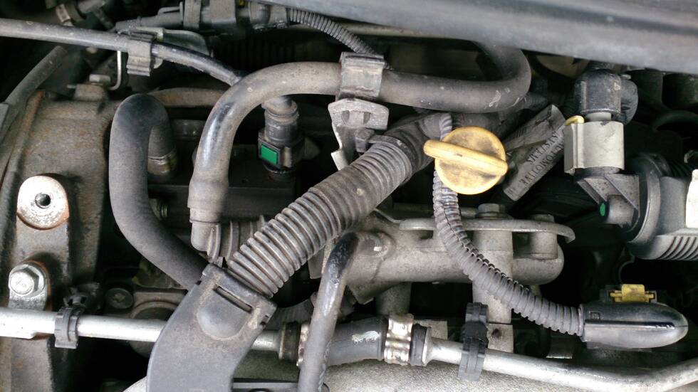

Ok heres a pic of my engine. Swcond pic is me pointing where to look. The third pic is rite in the down behind the block im pointing rite at the plug. When u found this one u will b able to go along n find the rest

U could do with a second person as it a tight fit n once u get ur hand in it easier to keep it there n get them 2 pass u the stuff. U will also need a quarter inch 10 mill long reach socket set n thats all
On the first picture, they are directly underneath the aluminium bit.I've got my bonnet open at the minute, got the tools, but no idea how to get at them. Can't fit my hand in and no prospect of unbolting the whole top of the engine.
