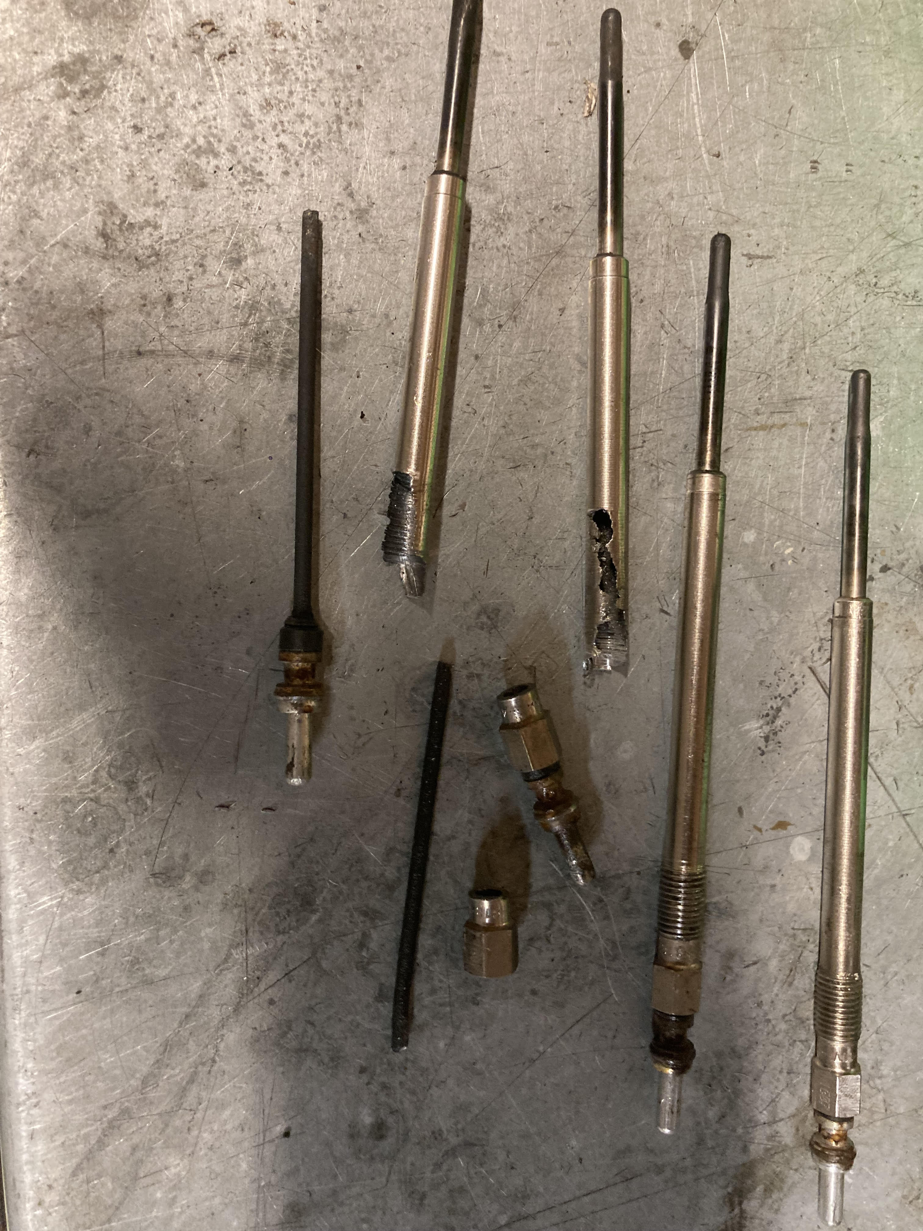

They break easily but can be removed after with the right tools, these are out of my 2.3 Multijet, The 2 that came out complete squeeked all the way out, they had all been soaked with penetrating oil for a week beforehand..... Good Luck

It looks like you drill into the top of the broken glow plug, then put some kind of adapter in there, and pull it out? Or does it then turn with the therad?
When it has snapped there is a hole down the middle or if the electrode is still sticking out it needs twisting until it comes out of the hole, Then there is a special drill that is small at the end and tapping drill size for the threads further up, drill into the plug upto depth of threads, Then there is a tap and a long tap wrench , you cut a thread in the hole and screw in an extractor from the kit and pull it out.Dont rush the job, When cutting the thread put plenty of grease on the tap and the swarf will stick to it,
