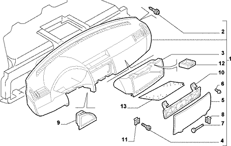

Main reason for this particular post is to request help with identifying the new part needed. Old assembly is as photo, and I need to replace it all (some damage during removal...). Please can anyone help with a parts reference (and price would be a bonus) for the complete assembly as in photo? 2004 5 door JTD aircon, vehicle 448121.
Eper diagrams bear no resemblance at all - part 71728346 has no hinge parts, and no panel for fixing to the underside of the dash. Elearn workshop manual only has the removal of the trim panel (procedure 7040A52 UPPER DASHBOARD ODDMENTS COMPARTMENT FLAP COVER - R.R) but at least the parts are correctly drawn.

Hi steve you will find the diagrams are rarely accurate in discription but I can confirm the part no you have is correct. however I think the price will be £50 + and this was off eper 18

Thanks Stores (and YP) for replying - over 90 views and nobody was able to help, I was starting to panic a bit! £50'ish is not unreasonable for the whole assembly, so I'll try to get a dealer to order it in.
