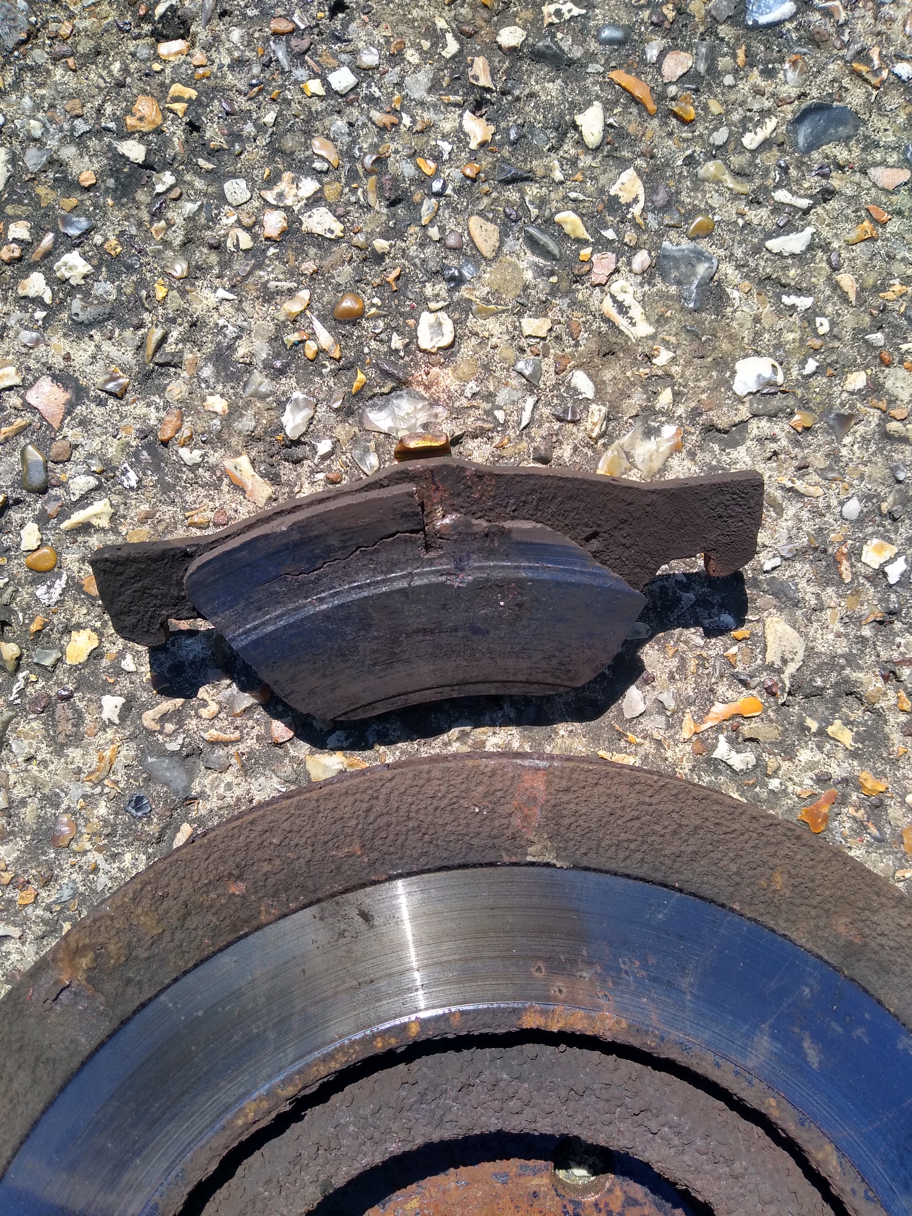

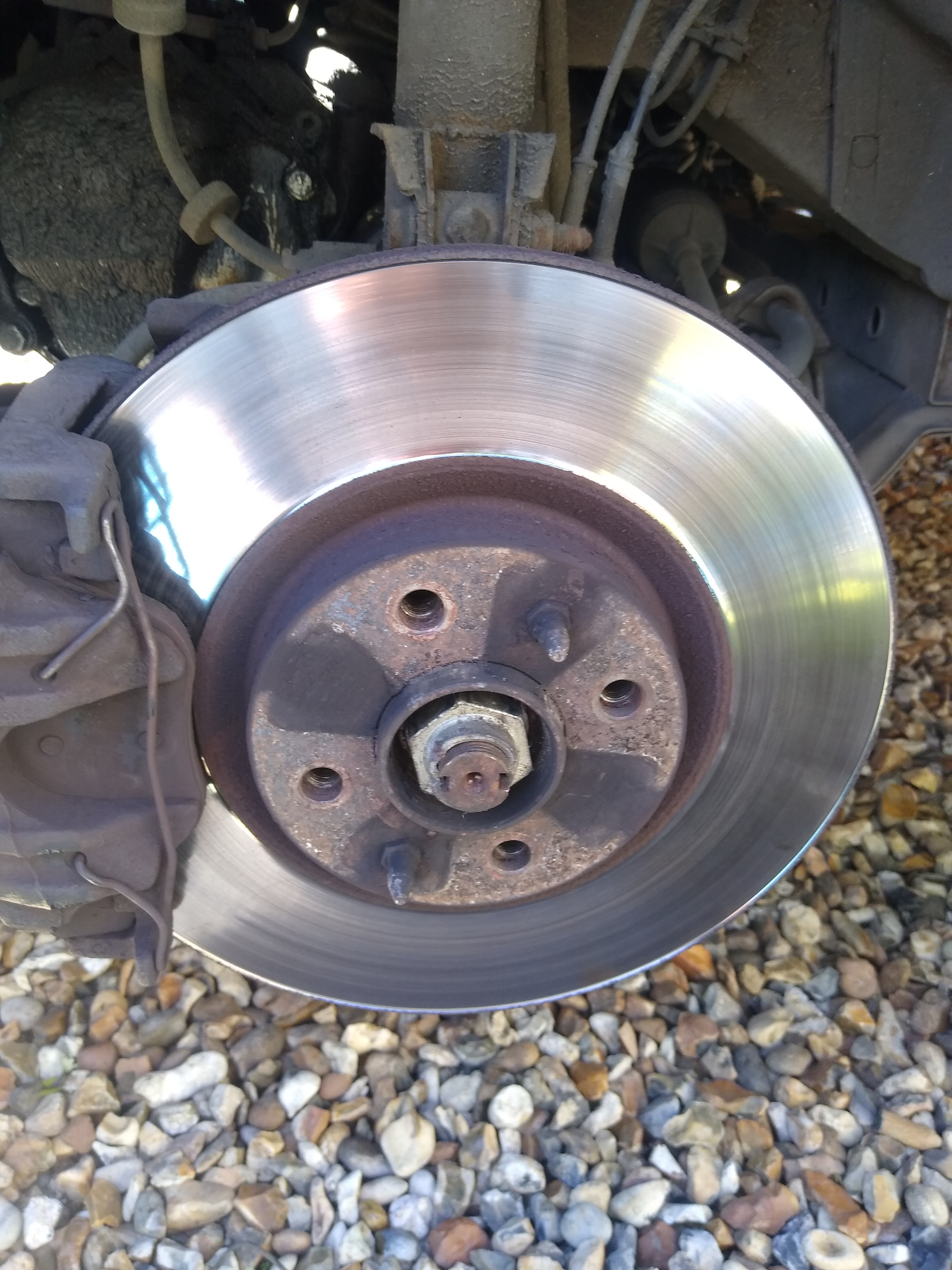

Front brakes have bedded in and along with the new rear shoes have really improved stopping power.

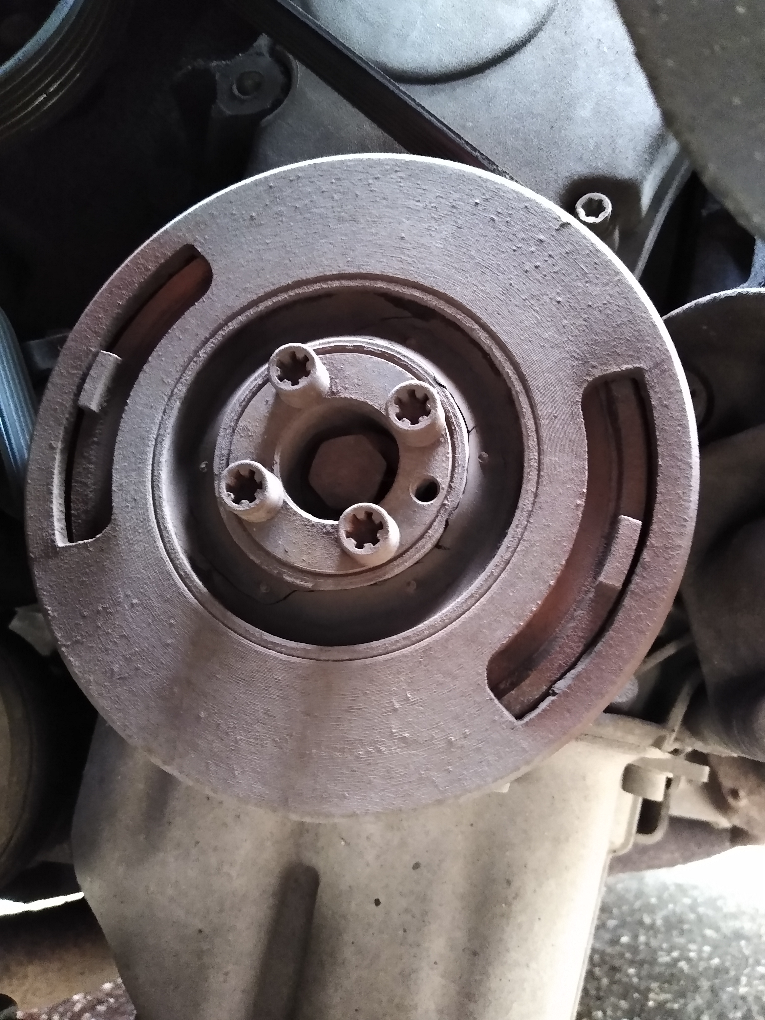

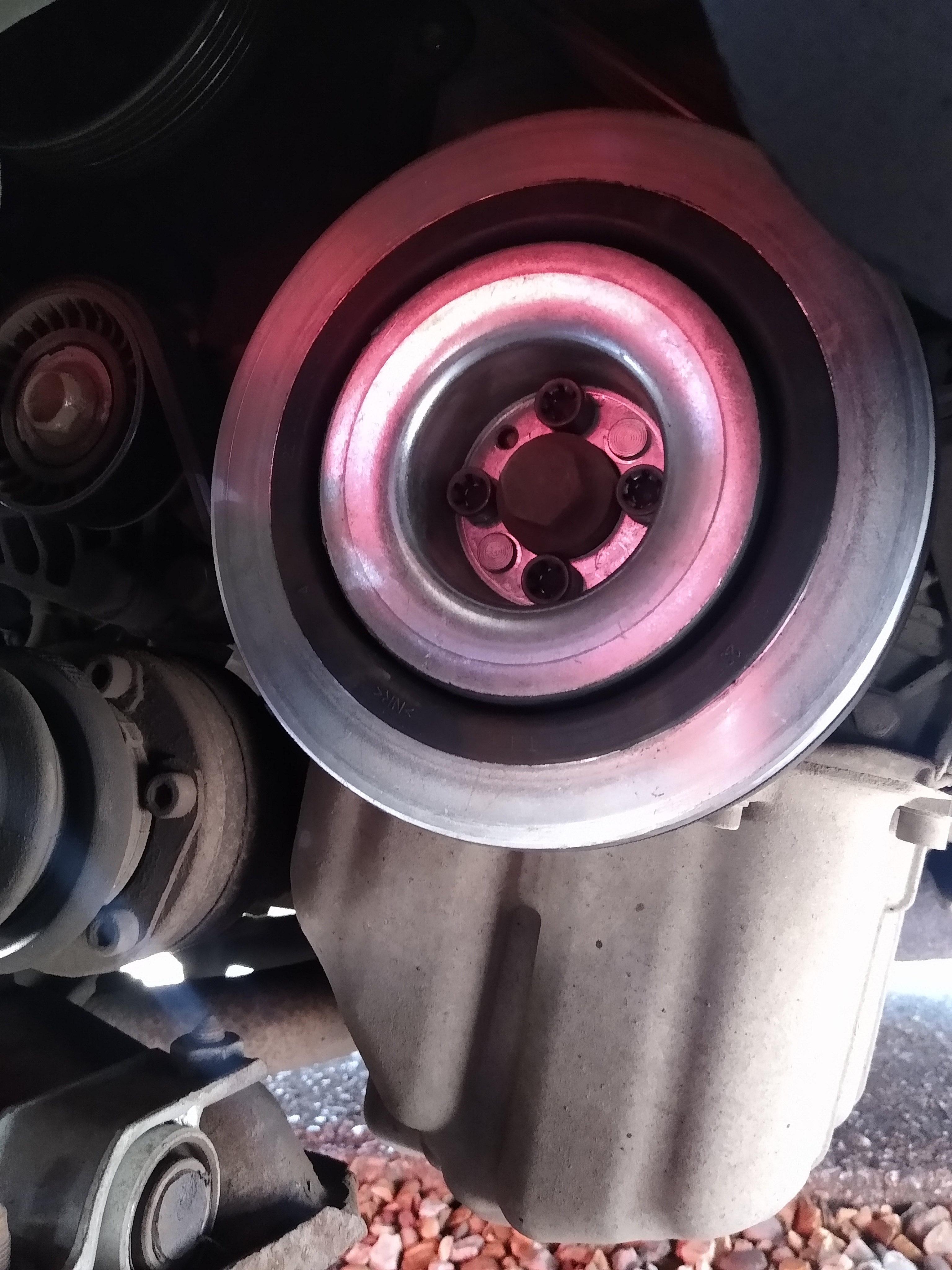

Noticed a slight noise on tickover and on inspection it looks like I've got a slight wobble from the crank pulley.
Am I right in assuming it's just a case of undoing the 4 m8 ribe bolts, removing old pulley and replacing it with a new one?
Any recommendations for any particular brand if pulley?
The tension has to be taken off the aux belt , bit awkward and needs a 15mm or 16mm spanner(can't reminder of hand but know it's unusual size) yes to the 4 small bolts holding crank pulley. The 4 bolts may be ribe key if original fiat. 28nm torque.

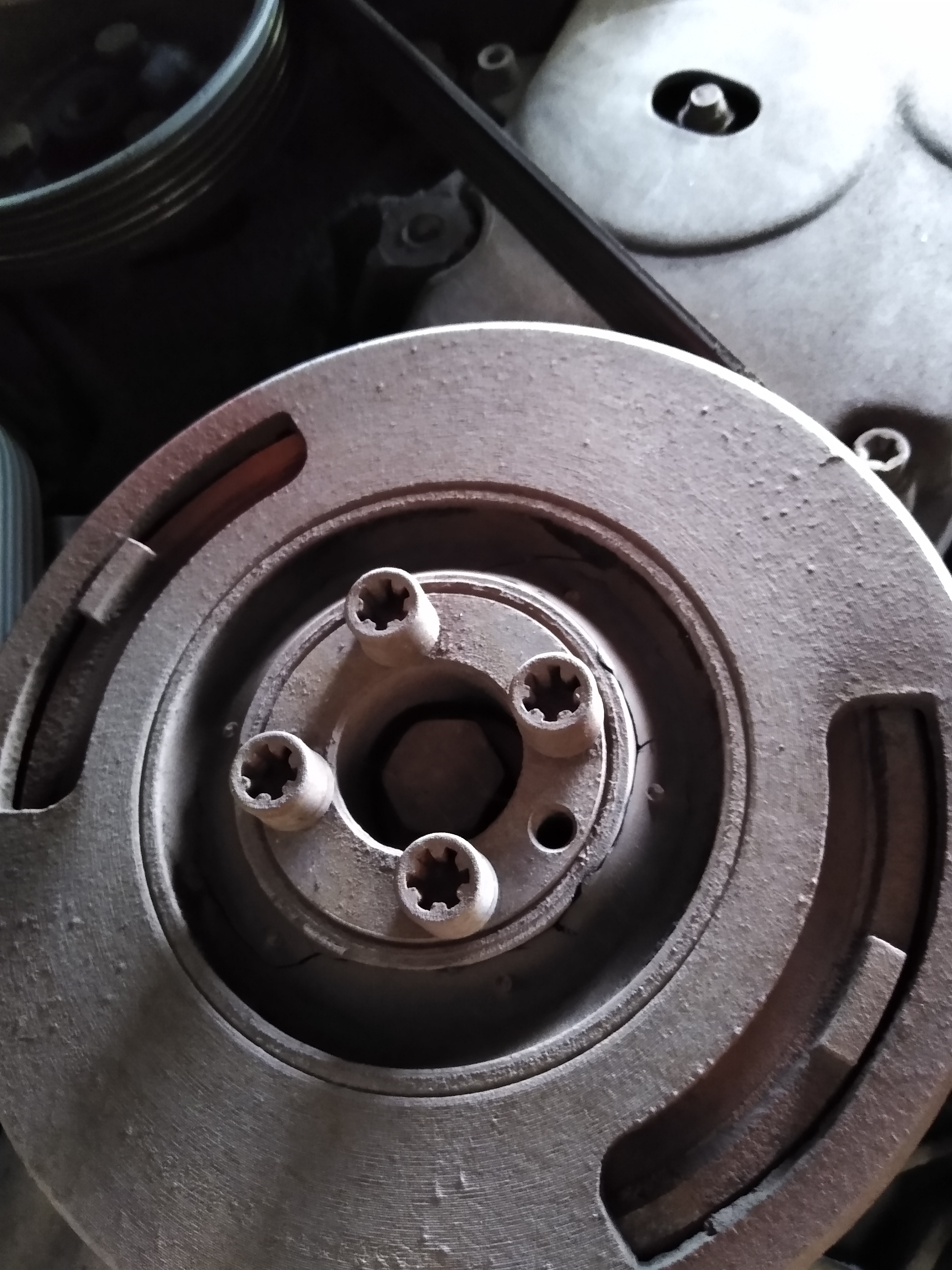

Evening all. Looking to change my crank pulley as I think it may be the cause of a knock, but none of the ones I can find look like the one fitted,as in they don't have the two outer cut outs?
Am I missing something or are there differences?

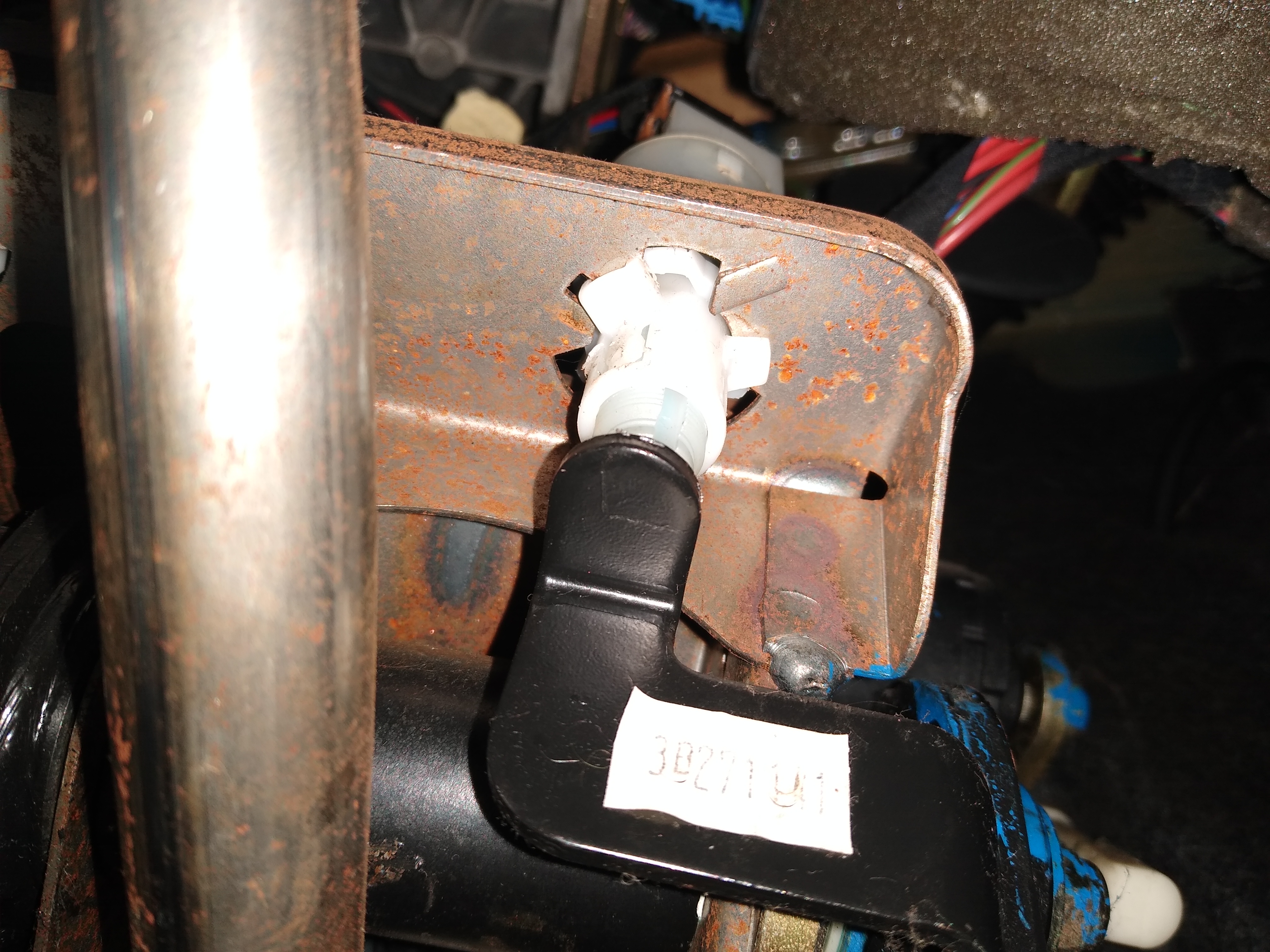

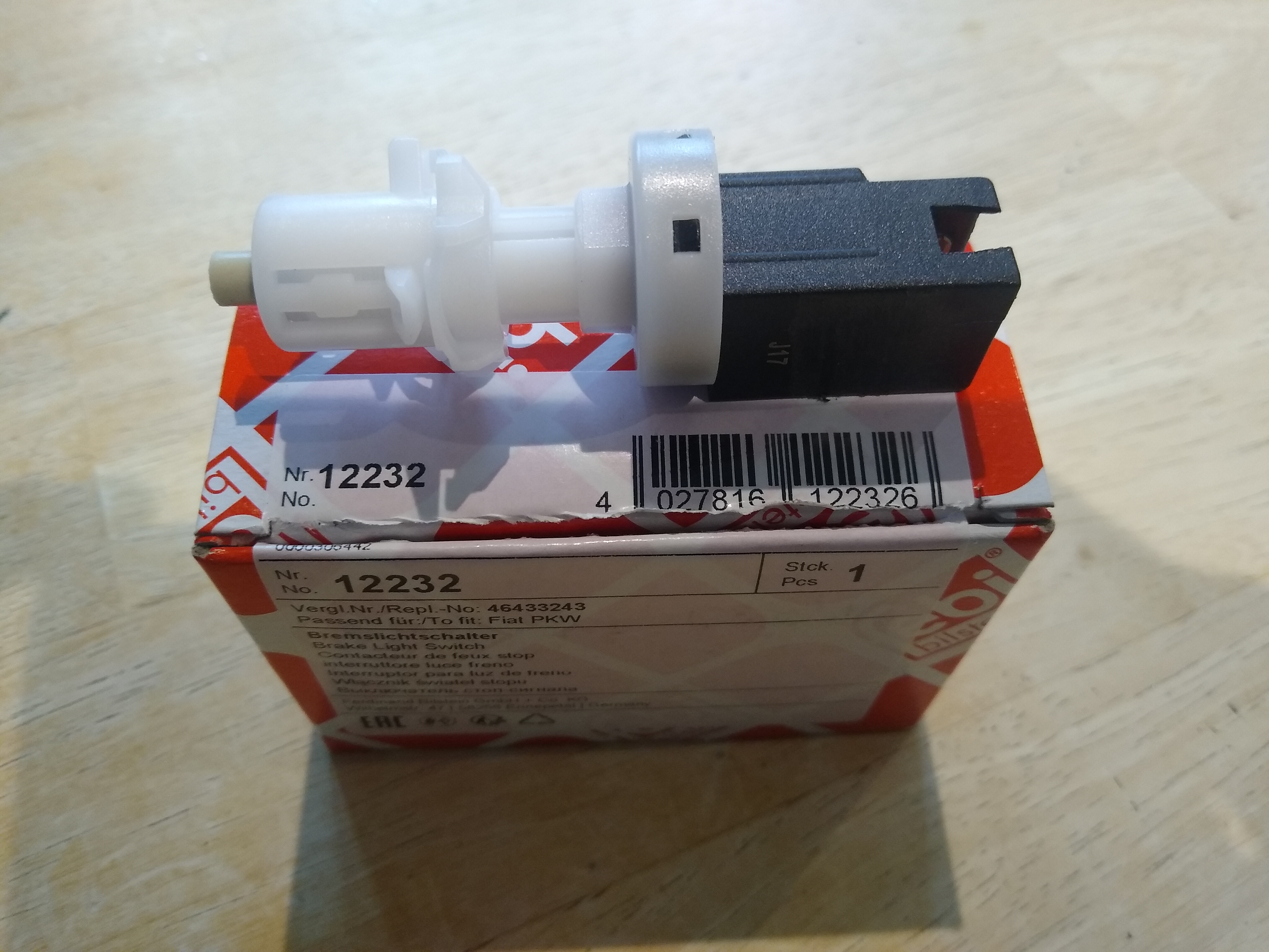

Whilst reversing into a parking spot last night,I noticed that I didn't have any brake lights, so this morning I whipped out the switch and gave it a squirt of contact cleaner.
The plunger was a bit sticky,but all now appears to be working, although I have bought a new switch just in case.
Removal was quite straightforward, with just a 14mm spanner required to turn it slightly anticlockwise to release it from the bracket.
My new crank pulley arrives today and if I get a chance, I'll fit that on Friday.
New crank pulley fitted today,and what a difference it's made. The old one had been making a really awful noise for the past couple of days and was definitely not running true, but the new one has cured both the noise and belt wobble.
