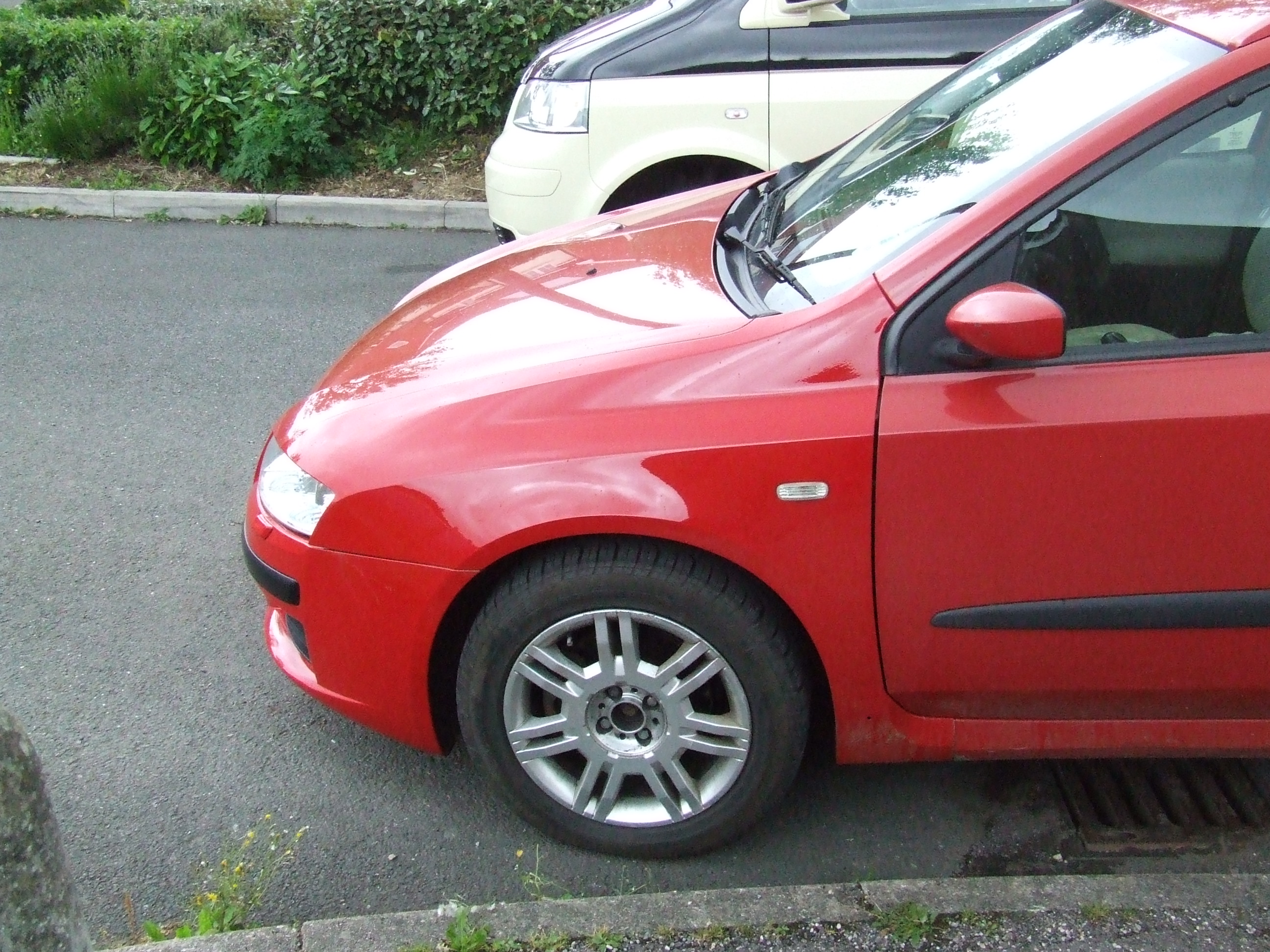

Well this is the result,
Looks ok from here,
and from here

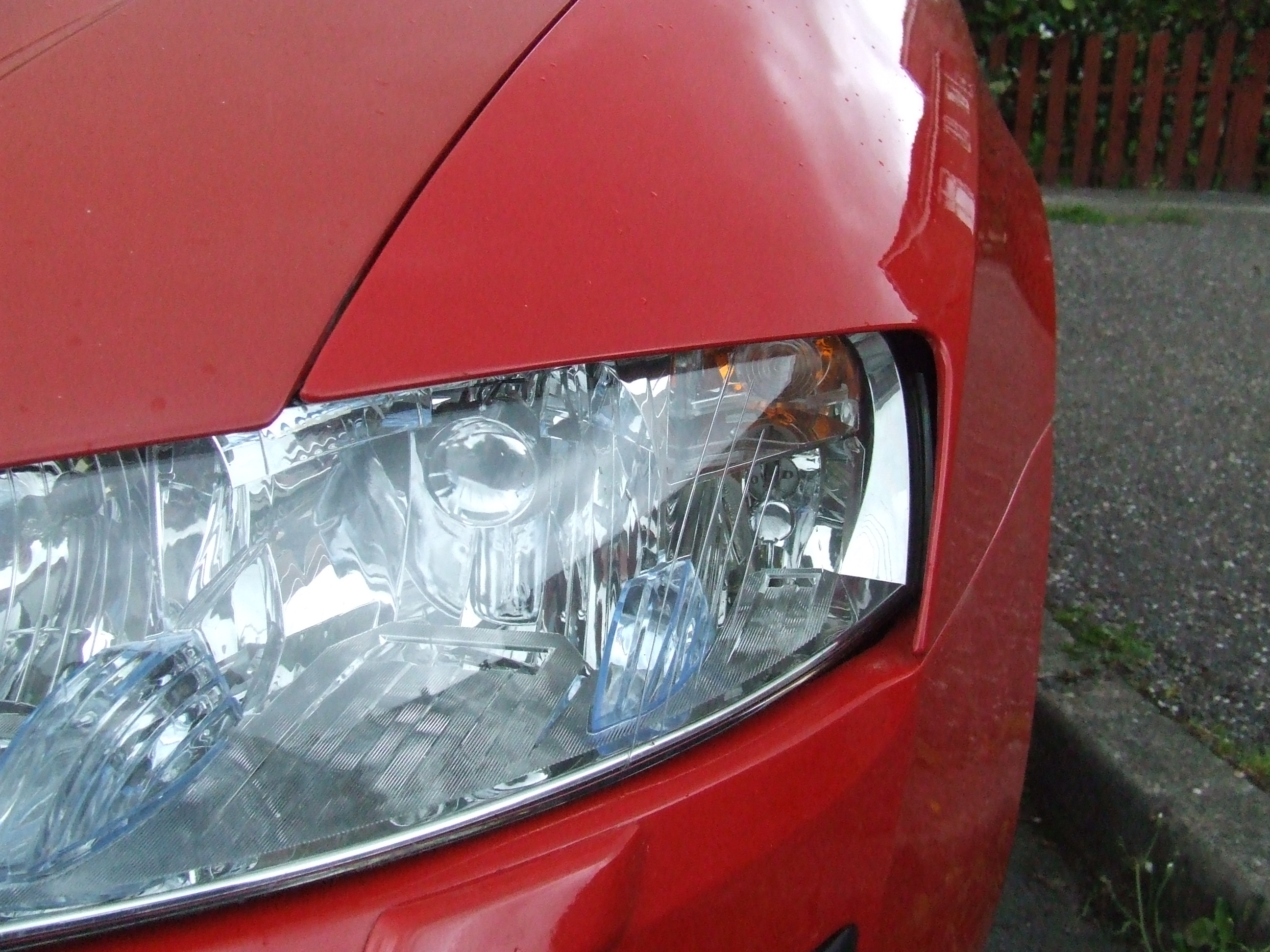

Its not really until you look that you realise this,
Now had it been me i would have sent it back and said try again but mum was happy enough and so am I to a point but now im in a bit of a quandry.
Do i replace the other wing and both headlights with 3 door to bring it all into line or what.

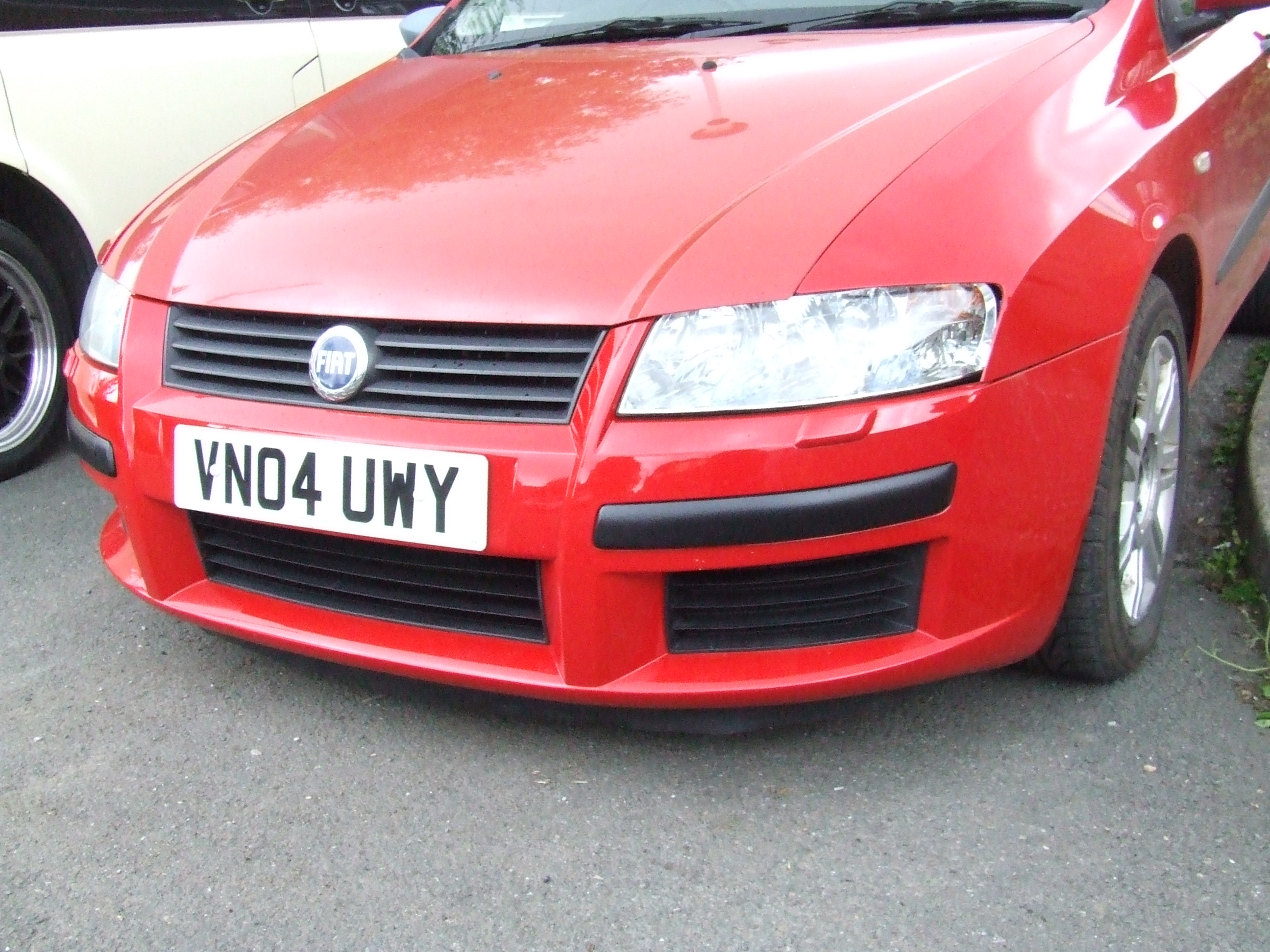

GizmOwin, i know you toyed with the idea of a 3 door front, i think this might prove it can be done on a multiwagon and i must admit it does look nice.
Your thoughts.
Well its too late now, 3 weeks or more. And besides I need the car now.
But seriously I thought it was worth posting as the 3 door front end clearly will fit if anybody is interested and that was more the point I was trying to make even if not too clearly.
And I think I will keep my eye out for a 3 door drivers side wing and a couple of headlights as well and perhaps make a bit of a project out of it now I'm going to keep it for the foreseeable future.
As for the paint match yes it is terrible and as I don't know who did it I cant name and shame but who knows I might be able to have it resprayed in the future.
This is very exciting! It fits perfectly! :) As you say.. Just the headlights need changing. I felt for sure that the 3 door wing wouldn't go as far down. Makes you wonder why Fiat bothered changing the five door front? would have been much cheaper to make one set of wings/headlights/bonnet etc, and made the 5dr/estate much more attractive.
Thanks for this! I need a new wing, so I will be getting 3dr ones and maybe invest in a set of those 3dr headlights with the daytime running lights in! :)
Everyone with a 5dr needs to do this now.
Owen.
Yes I thought you might be excited about this, I love the look of mine to be honest and will be getting a drivers side wing and a couple of headlights my self now.
What are these headlights you mentioned???
I hope and assume that the front panel is the same and I think you might even get away with the 5 door bonnet looking at mine.
Yeah! My bonnet overhangs a little anyway, although I could do with a new bonnet too, so I may look at getting a 3dr one, I'll have to do some investigations to see if it'll fit first.

the paint looks like it has been done by Stevie Wonder with a bicycle pump. The lights are the one MZHussein had but weren't they lhd only. Have a look on the DTS web catalogue.
